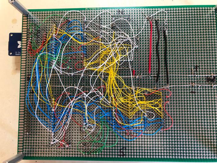

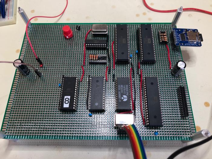

I was moved to post since my wire-wrap prototype came up today, a more solid platform for the machine that's been running on solderless breadboards up until now. 4MHz 65C02, 2x 65C22, bit-banging SPI to an SD card, R6551 and 32K of EEPROM and SRAM. I couldn't have done it without you all, so, many thanks! As you'll see from the photos, this could be much more compact but, first time through, I wanted to give myself plenty of space to work with. Wire-wrapping sure does look cool, though.

Not much progress on the hardware since I posted that photo (although I did add a proper power supply); the next milestone will be adding video via TMS9918A (or the Mk2 F18A if it turns up first).
