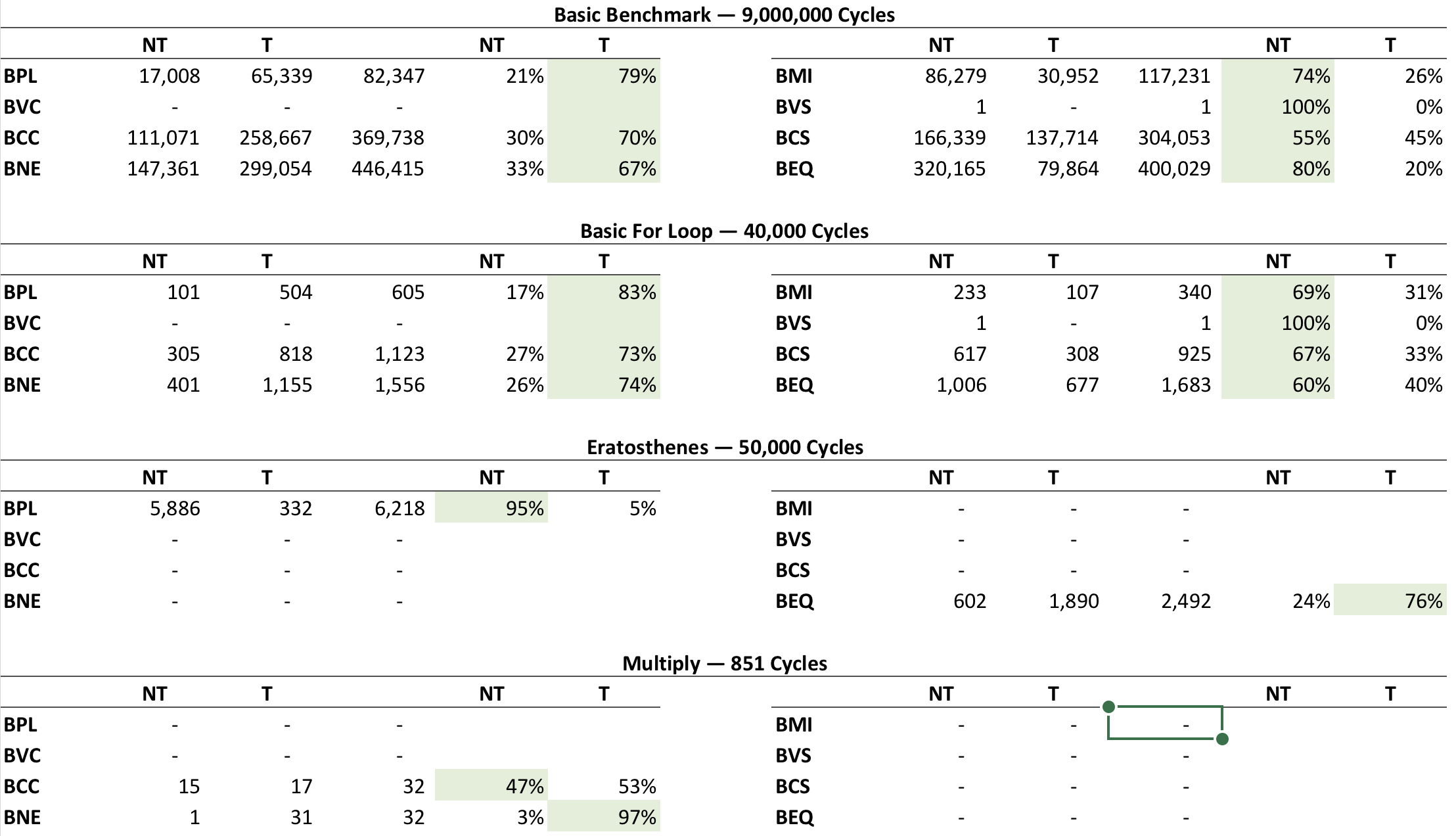

 Post subject: Re: Pipelining the 6502
PostPosted: Sun Dec 15, 2019 10:16 pm
Posts: 428
Location: Toronto, ON
That’s a great idea! A 6502 specific predictor can certainly skew towards particular regularities in 6502 code if they can be identified.
Let’s have a look ...
These tables show the results of the Basic Benchmark, a simple FOR Loop, the Eratosthenes Sieve and the multi-byte multiply. In all but the Eratosthenes Sieve, there is a clear bias towards taking branches where the tested status flag is clear, and not taking branches where the flag is set (i.e. BNE is likely to be taken, and BEQ not taken — just as Mike observed).
I’ll want to sample more code just to be sure this holds, but it is encouraging to say the least.
PostPosted: Mon Dec 16, 2019 12:36 am
Posts: 760
Location: Huntsville, AL
The larger application, the Basic Benchmark, appears to provide some generalizations that may be applied to the 8 different 6502 conditional branch instructions. The Sieve of Eratosthenes seems to throw a wrench into the rule for the BEQ instruction that seems to be indicated by the Basic Benchmark and the Basic For Loop.
There are, of course, studies for other conditional branch instruction combinations that you've not yet completed, but I am thinking that, for the 6502, the simple two bit saturating counter that you originally started with appears to be able to handle the case for the BEQ instruction when presented with Basic Benchmark in one test, and the Sieve of Eratosthenes in the another. If you extend your branch predictor logic to include some heuristic regarding the branch instruction at a particular address, then you could initialize the two bit saturating branch predictor to '00' or '11' based on the measured frequency for branch taken / not taken as your spreadsheet shows. A few mis-predictions would occur, but they would quickly move to one or the other extreme of the two bit saturating branch prediction counter and provide nearly 100% correct branch prediction. Thus, the simple two bit saturating counter branch predictor should prove to be very effective for the 6502. (If I recall, you've already proven this hypothesis in some of your early work on the branch predictor logic.)
If you're committed to considering a more sophisticated branch predictor, such as the ones that you and Rob have been discussing, then I think that, in addition to constructing Pattern History Table (PHT) using the gshare (XOR) or the gselect (concatenation) methods, the branch instruction type should be used to further qualify / extend that table for conditional branch instructions individually (BPL, BMI, BVC, BVS, BNE, BEQ, BCC, BCS) or by conditional branch instruction classes (N, V, Z, C). Naturally, for the 6502, the coding for individual instructions would require 3 bits and the classes would require 2 bits in the PHT.
The likelihood that these instructions or classes would clash in the PHT when located in different parts of the program should be fairly low. Thus, extending the PHT index with the instruction or class should reduce the need to have a large number of bits from the PC to adequately hash the branches being cached. In fact, I think that you should be able to reduce the number of PC bits into something manageable like 6 bits, which will allow each PHT to be implemented in a dual-ported Xilinx LUT-based RAM (with a synchronous read/write port and an asynchronous read port, if a small FPGA option is in your design space.) If the PHT implements the two bit saturating branch predictor for a conditional branch instruction class, then I think the result wold be very satisfactory for your Pipelined 6502 project.
PostPosted: Fri Dec 20, 2019 4:41 am
Posts: 428
I’m sorry to report that using the branch-type to influence prediction seems to have produced rather lackluster results. I tested a couple of variations:
  • Use the branch-type to select an initial value for the 2-bit counters in a bi-modal predictor. I used values for each branch-type as well as each direction individually and in combination (i.e. a BPL Backward might have the same or a different initial value than a BPL Forward). Unfortunately, in each case the value is quickly over-written and has little influence on the overall performance of the predictor beyond a handful of cycles.
  • Use a 3-bit branch-type as part of the PHT index in a GSEL correlating predictor. In this case, performance actually deteriorated. It turns out that adding more bits from PC is preferable to additional bits that reflect a particular branch attribute.
One variation I did not try is to have a wider prediction counter, and use the proportion of taken vs not-taken branches as a guide when updating the counter. The thought was to increment or decrement the counter by different amounts depending the relative proportion of branch outcomes. To reflect a 75/25 ratio, for example, we might increment the counter by 4 when a branch is taken and decrement it by 1 when it is not. The predictor would then naturally favour taken branches in the right proportion.
I’m certainly open to further experiments on this, but for now, I decided to go back to the original GShare scheme. Further tests showed that GShare in fact does quite well with a small table in many instances. It seems that the BASIC interpreter is simply a particularly difficult case (probably because of the large number of data-dependent branches and relative lack of regular looping branches). Be that as it may, it’s an important target, so a large PHT it will have to be. (In a discrete logic implementation, any reasonable size for a PHT is going to need a separate RAM IC in any case, so a large PHT is not as burdensome as it might be in a FPGA).
