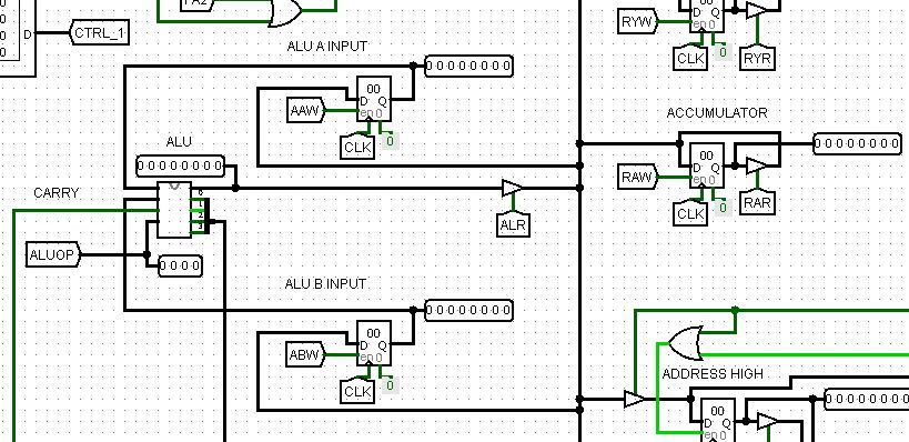

Thanks! It seems that I can't get away with my simple ALU-accumulator setup (see attached). I'll have to look more into that, and learn about visual 6502, as it sees to be a valuable resource. But as I am the one designing the CPU, I can add an additional temporary register for this kind of operations if I need to. It doesn't have to replicate a 6502, I just wanted it to be vaguely similar in order to benefit from existing documentation. We'll see.
Attached is also a general picture of the whole CPU.

Yes indeed, a temporary register will do - the 6800 and I think the 6809 used that approach, as does the Z80, so you're in good company!

I have added a temporary register to my ALU, see attached, and that enables me to do absolute addressing, and also to increment/decrement X and Y registers without modifying the accumulator. The problem now is that I need 7 clocks to execute the instruction, plus 2 from fetching the opcode makes 9. I have a 3 bit micro instruction counter, so it does not fit.
That seven clocks are:
-Program Counter -> Address registers
-Read low address from memory -> Temp register, increase program counter
-Read high address from memory -> Address high register
-Tmp register -> Address low register, increment program counter
-Read operand from memory -> temp regsiter
-Alu result -> Accumulator
I have 'simulated' ORA with absolute addressing on visual 6502, so I can see what control signals fire up and trace it on the block diagram. It takes 4 cycels, but as I see it, each cycle has two distinct steps, in which different control signals are enabled. (I suppose each step is a clock?).
As I don't care about speed and I'd better keep things simple (i.e no pipelining), I may increase the micro instruction counter to 4 bit so that instructions can take as long as 16 clocks, which may be handy for relative addressing. Doing so would mean going for bigger decoder roms (although I have a workaround in mind).

MichaelM wrote:
Since you're not trying to fully emulate a 6502, then I will let you know how I approached this problem since I too was not trying to emulate a 6502 in a cycle accurate manner.
I use two temp registers. One for the first instruction operand, and a second for the second instruction operand...
Thanks for the information, I'll have to look into that if my approach doesn't work out. I have added two input registers for the ALU: A and B. That makes instructions a fair bit slower, so I had to make the microcode counter 4-bit wide. I am prioritizing hardware simplicity over speed, so no problem. So far, by using those registers I have been able to implement zero page indexed, absolute indexed, and X indirect. So not looking bad so far, but we'll see.

JuanGg wrote:
As I ran out of address lines on the microcode ROMs, I have turned reset and interrupts into regular instructions. When IRQ goes low, next opcode to be executed is forced to be 0x0, the BRK instruction.
This statement appears to indicate that you were running the RST and IRQ signals into your microcode ROMs. I think that this is an inefficient use of the address lines to your microcode ROM. First, RST should have an independent effect on some of your internal registers, such as your program / instruction counter (PC), your microprogram / microinstruction counter (uPC), and your Memory Address Register (MAR). When RST is asserted, these registers / counters should be forced to a known state.
In the case of the PC and the MAR, they should point to the reset vector location: 0xFFFC. In my implementation, I don't actually set the PC explicitly when RST is asserted. Instead, I either increment it, i.e. PC <= PC + 1, or I load it with the address I'm presenting on the memory address bus, i.e. the value assigned to MAR. Therefore, on RST, I force the memory address to 0xFFFC, and capture that address into the PC at the completion of the first read cycle of the reset sequence. The uPC is force to 0x00 (8-/9-bit microprogram address bus), and I proceed from there.
To handle interrupts, I conditionally test the internal INT signal, i.e. INT = FE(NMI) | IRQ & IE, and load the MAR as required with either the NMI vector address or the IRQ vector address. (Note: FE(NMI) is a function that latches until serviced when a falling edge on the external nNMI signal is detected.)
This approach may make the implementation a bit slower since it places logic in the address path, but it allows the microcode ROM to be populated with microcode sequences as required by the instructions and addressing modes. In other words, the microcode ROM does not need four different microinstructions for each instruction sequence element to account for RST or INT being asserted. In the case of RST, it is not a conditional signal, and in the case of INT, as defined above, the current instruction sequence is completed and the INT sequence is only performed at the boundary between instructions.
Just curiosity, but are you using a microprogram sequencer or just a loadable counter. If you're using just a loadable counter, you may consider using a simple microprogram sequencer like the Fairchild 9408. You can find a description of this obsolete microprogram sequencer in the 1976 Fairchild Macrologic manual (page 86) archived on bitsavers.org here. (Note: big PDF) Alternatively, you can view a derivative of this particular microprogram sequencer written in Verilog here.
Michael A.
