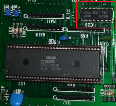

A 3-to-8 line decoder with multiple outputs active at the same time?? That shouldn't be possible ever! I think you've discovered a red-hot clue, R.R.!
But of course before replacing that chip, you'll firstly wanna check that it's not lacking anything it requires for proper operation. Does it have valid logic levels (measured with a 'scope) on all the inputs? Solid 5V, measured right at the supply pins? In particular, I'd wonder about a bad solder joint to pin 16. (Lack of Vcc would tend to send all the outputs low.)
40H138 might be pretty hard to find, but 74HC138 is easy to get and ought to be an acceptable substitute. But I suggest you do not solder it in. Instead you might want to install an IC socket just in case you decide to try a different substitute later.

[IC28 (40H138)] shows a completely different pattern where three of the outputs are low at the same time.
Only one output is supposed to go low at a time.
To me, it looks like IC28 is defective. //Jeff is right about testing VCC at IC28 first.
Found no TC40H138 datasheet in the internet. //The block diagrams in the DX7 manual were an interesting read.
Found something about the Tosiba TC40H family at Bitsavers, but again no TC40H138 datasheet.
From the PDF page 17 (16):
To me, it looks like the TC40H138 could be replaced by a 74HCT138.
Nevertheless, I would suggest to solder a precision DIP socket into the PCB (just in case you might have to try a different substitute later).
But extracting IC28 out of the DM board without damaging the DM board would be going to be difficult.
The incredibly thin traces on top of the PCB would be going off pretty fast when not taking a lot of care.
One option would be cutting the pins of IC28 close to the package with a scalpel or such, then to solder the individual pins out of the PCB after removing the package.
Jeff, any second opinion on this ?

ttlworks: I have now changed out the 40H138 for 74LS138 with no change to the organ or signals so I have refitted it in a socket. I think I might have been misled by what I see on the LA because when I check with a scope all levels are high when not active. IC28 was easy to change because I use Lonco flux to freshen the old solder and then use a Pace desoldering iron. They come out clean as a whistle when the flux is used as you probably know.
Considering what the traces on the DM board look like, it's nice/comforting to know, that you have good/professional workshop equipment. :)
Sorry to hear, that replacing IC28 didn't fix the problem.
