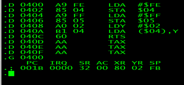

when I run this code on the replica 1 it works I get the content of the memory at FFFE +2
in this case, after the execution it returns to the registers it's normal

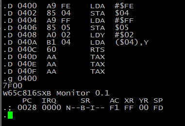

when I run this code on the w65c816sxb in emulation mode, I get a reset of the board
in this case it shows the free memory, the banner and the registers
to get that it is necessary to call the cold start routine
not the display of registers is not complete in my monitor PC and IRQ are wrong
other registers are ok

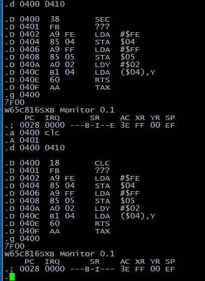

in fact I was wrong yesterday, it was not working
in my test, either in emulation or native,I get a reset
I tested both native and emulation
(my mini assembler has no support for 65c816 so I code a nop then change the nop into XCE manually (FB)
I also added the display of the mode '-' for native and 'E' for emulation
in both case I got the display of the top memory and the banner from the reset code
