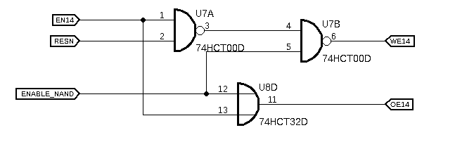

Tied to VCC. Here are all the parts involved.
A pair of 138 generate the register enable signal (EN0-EN15) for all registers. They're both qualified by /CS and PHI2, so no register are selected when PHI2 is low.
The individual register select line is combined with /RES and R/W to generate the WEn and OEn (Write enable and Output Enable, both active low) for each register.
ENABLE_NAND is NAND(R/W,/RES). This is how the original schematic for the register select:
The NAND gate labeled inst6 is the ENABLE_NAND. This is common to all registers,
Essentially, when /RES is high, WE equals ENn OR R/W, OE equals ENn OR NOT(R/W)
And then, this is the DFF storing the START bit

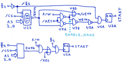

Tried to draw the address decoding a bit differently, then to extract the interesting part of how the START flipflop U3A is written.
I think the reliability problem with the START flipflop could be related to the C64 bus timing.
If the 74377 registers would work well, but the 7474 flipflops with clock gating would not:
The timing in the C64 is a bit difficile (more than in the "average" 6502 system), because the CPU and the VIC-II share the bus.
Because of this, address and data on the bus are not valid at the rising edge of PHI2...
what could give old NMOS 6522 chips some problems,
the usual approach for fixing this was delaying PHI2 with two flipflops clocked by the dot clock or such before sending it into the 6522.
That's one thing you could try.
Another thing you could try is to insert a 74573 chip between C64 and 74HCT6526 for the signals R/W and A3..0,
then to clock it with PHI2, this way those signals at the 74HCT6526 inputs are supposed to stay stable
at the 74HCT6526 inputs after the falling edge of PHI2 when the VIC-II takes over the bus.
//But this won't cover that moment when the CPU takes over the bus again after the rising edge of PHI2.
Anyhow: take an oscilloscope, watch out if there are spikes at the clock input of the START flipflop during PHI2=0.
A cheap logic analyzer probably won't be fast enough for seeing the spikes.
An old/used 60MHz analog oscilloscope with passive 10:1 probes might do.

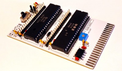

Also, I finally completed a small board that allows me to plug 2 CIA (Either the original ones, or my 74HCT6526) into a C64 without the need to use a mess of wires. Each one of the two CIAs map to the IO1 and IO2 pages in the C64. This will allow me to automate testing, and prevent any issues and headaches caused by bad wiring.
I've compiled a list of issues too, so no more chasing ghosts! Now it's the time to address onw issue at a time and hopefully, finally be able to move on.

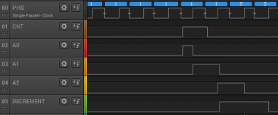

First of all, I've had to add a rising edge detector (made with a flipflop) before U9B. Before this, the timer was ticking every PHI2 cycle if CNT was held high, instead of counting just rising edges. Still, this doesn't fix the double count, although it was something needed.
I've taken some samples with a logic analyzer of the output of the 4 FFs in the chain.
U9B output is A0
U9A output is A1
U10A output is A2
U10B output is DECREMENT.
As U9B goes high for a single cycle whenever there's a rising edge on CNT, you (or at least I) would expect to see a pulse, one cycle wide, going through the pipeline on each PHI2 cycle. And indeed, sometimes I got it
But, most of the time (over 90% I'd say) this is what I see
U10B goes high at the same time as U10A. I haven't been able to find any explanation so far. I've checked the obvious. Verified the soldering, replaced U10 just in case it was bad, tested both TIMERA and TIMERB boards. Same exact result.
The only idea I have right now, is that U10A is getting updated before U10B handles the clock tick, so when the clock reaches U10B, U10A is already high. Considering both FF are on the same IC, both clock pins are separated by a trace no more than 3mm long, so, unless this is happening inside the IC... it escapes me. It's worth noting the first two FF in the pipeline are in reverse order (First B, then A). Of course, datasheet for the 74HCT74 states a minimal propagation time, between the clock pulse, and the output changing of 15ns, so the only idea I have seems to be just not possible.
But... I'm getting there... I'll get there :)
