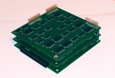

Finally, B1 and B2 are completed and they.... kinda work... Although I'm going to have to check quite a few things.
Remember how B0 performed flawlessly, both when connected via the expansion port, and when replacing CIA#2? Well, that's no longer true. I'm getting weird image artifacts when doing that, even using only B0. All registers work OK when connected into the expansion port, so it seems something's wrong with the port outputs. Until I figure it out, I'll do only testing via the expansion port.
Now, about the new boards, I've only been able to do some limited testing. Timers start and stop, and the do count as expected. B0+B1 work, B0+B2 work too. However, if I connect the whole stack (B0+B1+B2) my C64 starts to behave weirdly. I get no cursor and no keyboard. This implies CIA#1 no longer works. I get the startup screen, and Run/Stop+Restore does what it should, so CPU, VIC.. they are pretty much OK. I may be drawing too much power and CIA#1 is the first victim, or some other signal may be being affected.
Something I didn't take into account is how many inputs can I drive from the C64 outputs, and I'm maybe paying for that now.
So, plan for the next couple of weeks. Run some extensive testing on both timers individually, identify why B0 seems not to work properly on its own, and find what's going on when I connect the full stack.

From the C64 schematics:
D7..0, A3..0, R/W, PHI2 and /RES signals are supposed to be identical for both of the CIA sockets and the expansion port.
CIA2 generates the (edge sensitive) /NMI signal, and I think that /NMI stuck LOW isn't supposed to stop the C64 BASIC+KERNAL (when not emulating RS232).
CIA2 does generate /VA14 and /VA15 (through PA0 and PA1), something wrong there _could_ explain odd artefacts on the screen.
From the datasheet, 6526 is supposed to draw 70mA..100mA from the power supply, and I would recommend to check this first.
//But it's somewhat unlikely that something like a handful of 74HCT chips running at ca. 1MHz draws more than 100mA from the power supply.
I also would recommend an "optical inspection" of B0 just to be sure that no short circuit had happened by accident,
something like a little piece of solder that went between two SMD chip pins during the building process.
If this won't help, it would be worth to check if B0 emits something on the data bus when it shouldn't.

VDD, The pads for all bypass caps are in the PCBs, but no, I haven't soldered them. I wanted to check how much of an effect did they have, so I completely skipped them on B0. Everything worked fine then, so I just ignored them, until now. I've been pointed in this direction by several other people
VDD, although unlikely, I may be drawing too much power (around 75 ICs with the full stack so far)
PHI2, is being fed into 18 inputs. I need to do some numbers to find out how much current this requires, and if this is OK for my CPU right now.
There could be plenty of other reasons, of course, a bad contact or solder point, a short of some kind, maybe some error in design where I'm connecting stuff I shouldn't.

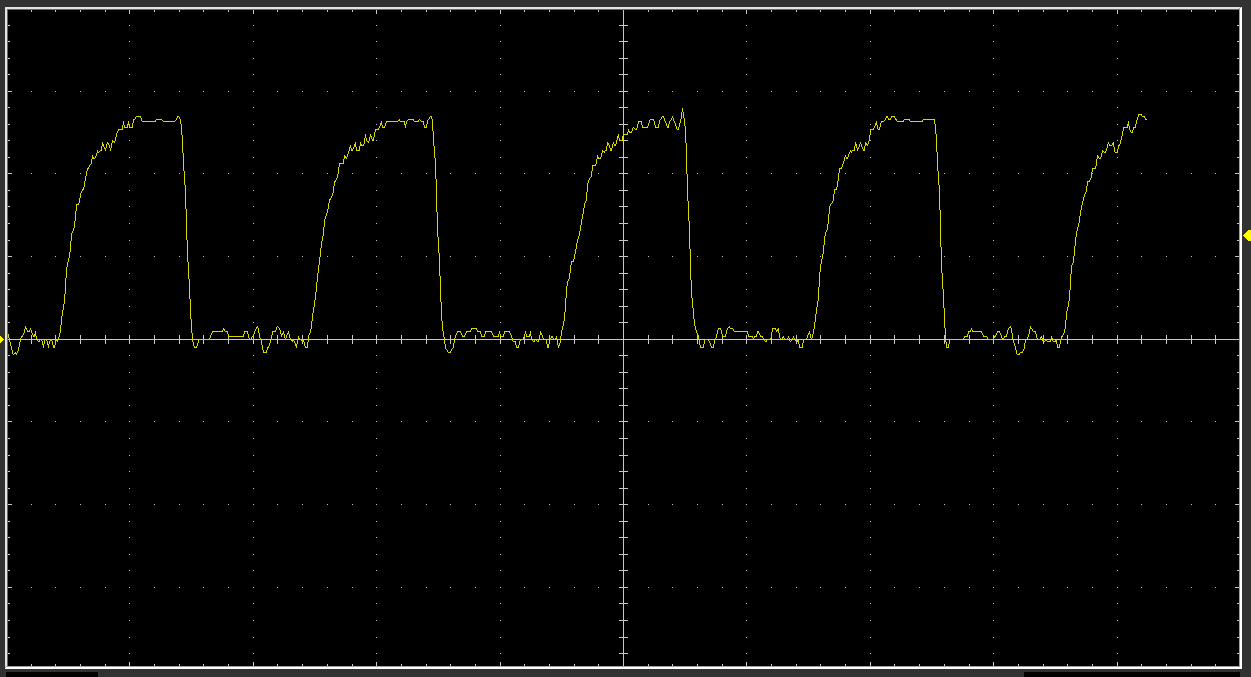

Well... it was easier than I thought... At least, finding what's causing my problems. Fixing them, still unknown.
I'm definitely trashing PHI2. This is PHI2, with no weirdos attached

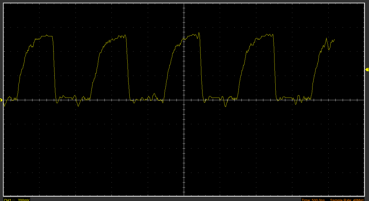

Adding B0

The more things I have feeding on PHI2, the longer it takes to raise.

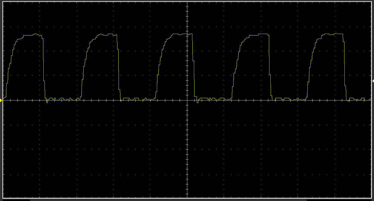

Interestingly enough, connecting just the scope with the sensitivity set to x1, is causing the same effect.

Yeah, old machines like the C64 typically use 74LS logic which has much higher pull-up impedance than pull-down. The important area, fortunately, is below the TTL Vih threshold of about +2.4V, but even here you have enough loading to change the slope of the signal noticeably. So the signal spends more time in the ambiguous zone between Vil and Vih, which can be seen by logic as rapid glitches.
Inserting a 74HCT buffer in the clock line should reduce the load on the C64's clock to a single CMOS input, and the CMOS output will have no trouble driving everything you want.

Basically, a 74HCT input is supposed to have 5pF..10pF of capacitance to GND.
When increasing the capacitive load on the PHI2 line by adding a lot of 74HCT inputs to it, PHI2 needs more time to rise to HIGH level.
Logic level threshold for 74HCT inputs is supposed to ba ca. 1.3V, and like Chromatix has pointed out,
it's an interesting question if 74HCT inputs might be getting "confused" if the rising edge of PHI2 goes through that voltage level too slowly.
Try running PHI2 through a buffer, preferably a 74HCT245, because the 74HCT245 might be a better choice for driving capacitive loads than the average 74HCT logic gate.
//When trying to aim for a higher PHI2 clock rate later, try to keep in your backhead that the buffer has a propagation delay.
About the effects on PHI2 with x1 scope sensivity... the probe, the cable and the scope input also add some capacitive load to PHI2.

A single buffer did the trick!
