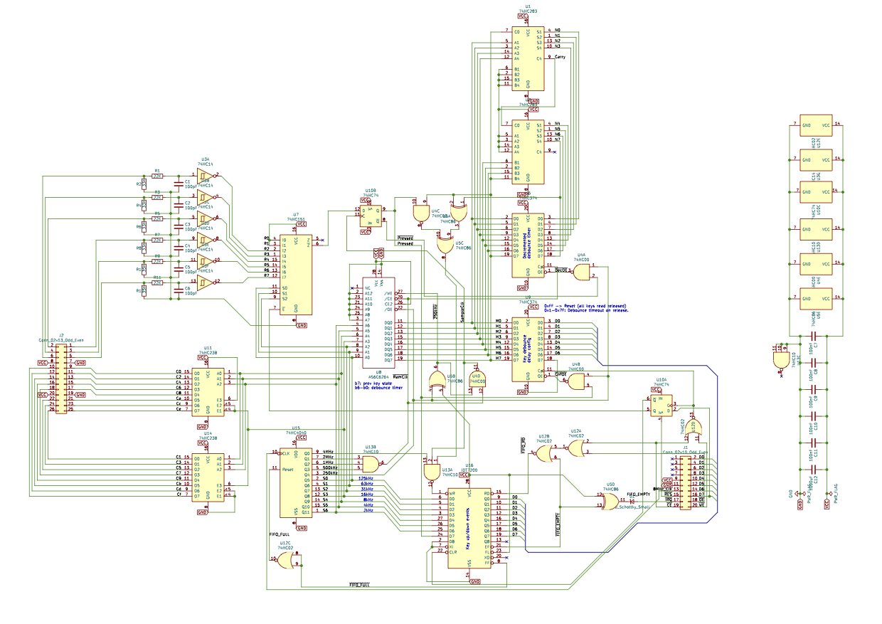

Well, I've spotted a timing problem that I need to fix.
In the current logic, the decision of whether to generate a key-down or key-up event is latched in a flipflop (to avoid glitching at the FIFO's input strobe) at the end of the first phase of each key scan. The decision of whether to send the output of the debounce decrementer latch (which stops counting with the "key up" flag value in the MSB when it expires) or that of the debounce *configuration* latch (which has that flag hardwired to "key down"), however, is effectively at the end of the *second* phase. It is possible for a keypress to occur during that window, and in fact it *will* occur by chance about every 256 keypresses. In that case, the key could be recorded in RAM as having been pressed, without actually generating a key-down event, and that record would suppress key-down events on subsequent scans.
The practical effect will be to drop a key-down event about every 3-4 lines of text, assuming an 80-column screen. Not exactly conducive to a high-quality typing experience.
So I need to fix it somehow, by ensuring that the decision of whether the key *is* down or not is consistent for both phases. But I have no spare gates or latches, so I'll either need to reconfigure an existing one or add another chip to the board, and the layout is already fairly dense. There's a reasonable chance, however, that I generate the correct flag value somewhere in the existing logic, and can simply feed that back into the RAM instead of the current arrangement. Another option is to latch the key data directly at an appropriate time, and de-glitch the FIFO signal some other way to free up the flipflop.
PostPosted: Fri Aug 30, 2019 11:03 pm
Happily, I think I've fixed it without needing to add any more hardware, just moving some wires around. The output of the row selector is now latched directly at the *beginning* of the first phase of the key processing, and the FIFO is now conditionally triggered towards the end of the first phase, rather than the second.
However this now leads to a second timing problem, since at 8MHz input clock there is only 62.5ns for the critical data path for the key-up event trigger to get out of the RAM (55ns by itself), through a pair of 4-bit adders' full carry chain, and then through a pair of XOR gates before reaching the timing gate. This does not seem very safe with 74HC logic, even though there's a definite possibility for the RAM to be faster than specified in practice.
(Both phases are limited to the final input-clock cycle - so nominally 125ns - of each half of the key-scanning cycle. This means the RAM chip is only selected on a 1/16th duty cycle, which should be a minor power saving if nothing else. The 125ns first phase is definitely long enough to get the adders' result around to the decrementer latch, but the FIFO trigger needs both the pre- and post-decrement high-order bits simultaneously, which is only possible during the first phase. The FIFO input timing gate now incorporates the 8MHz clock itself to select the second half of that phase.)
So I think I will need to adjust the RAM-related timing signals to double the duty cycle on the RAM, and thus loosen the timings enough to make the FIFO trigger reliable - ie. the timing gate only opens while the decision signal is stable. I may even be able to switch the two gates involved in that from 4-input to 3-input NANDs, giving me a spare gate for some future tweak.

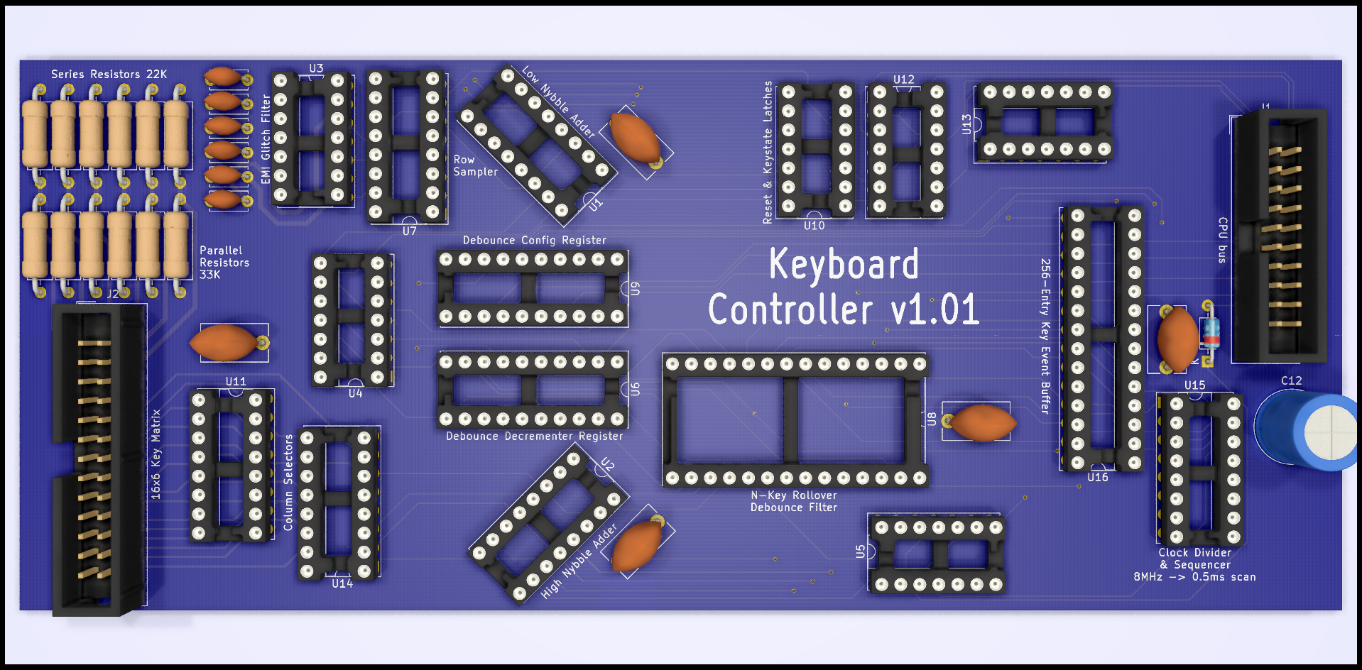

PostPosted: Sat Aug 31, 2019 9:50 pm
With these fixes in place, may I humbly present the v1.01 design… which will certainly not be the final revision.
Currently the board has no provisions for mounting securely, and the routing isn't as neat or efficient as I would like, especially for the random logic. I may well find that, after the fixes, some of the smaller chips would do better in different places. And equally I may still find problems in the design, whether by inspection, simulation, or prototyping. But I'm happy enough to work on something else for a bit.
PostPosted: Sun Sep 01, 2019 7:44 pm
(Very unusual chip orientations...!) [superficial comment, I know. Good to see the design come together. There's something of a message here, I think, in choosing whether to have nice hardware behaviour or to deal with things in software.]
PostPosted: Sun Sep 01, 2019 8:13 pm
Posts: 1950
I applaud the use of "creative" chip orientations, especially 45° and 180°, if they provide for more efficient routing and/or better density (which isn't immediately obvious to me here, but probably safe to assume). The only obvious trick you avoided was placing a chip on the backside of the board. Nicely done!
PostPosted: Sun Sep 01, 2019 10:28 pm
The most natural position for the two 4-bit adders is actually perpendicular to and either side of the registers they operate on. I think I was trying to approximate that while minimising the width of the board, but the advantage in the latter may be minimal in this case.
Using the reverse side of the board is of course an option, but one with dubious benefit with through-hole components, where the chief problem is already threading traces between pins on their way to somewhere else. Downsides include the increased likelihood of making layout and/or assembly mistakes, due to the mirror image effect, and there may also be effects on safely mounting the board in a completed device (eg. it may be shorter but thicker).
I haven't yet exhausted the trace/space limits permitted by JLCPCB, though; the thinnest traces used on that board are 7-mil. In a later experiment I may try squeezing two 3.5-mil traces between a pair of pads, and see if that gains me anything. The traces leading to the keymatrix connector are deliberately much thicker because there are analogue effects (that RC filter is supposed to get rid of anything from 1 MHz upwards that might be coupled in, but still has to reliably charge and discharge within 10µs) though theoretically the column selectors will carry more current than the row lines at any given instant. There may be smaller sizes of resistor I can sensibly use.
Another trick I haven't yet tried is swapping gate inputs, or units of the same gate on one chip, for the sake of convenient routing (as opposed to convenient schematic drawing). It's not immediately clear whether KiCad's ERC is smart enough to recognise such equivalences by itself - probably not.
