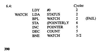

He then discusses what would happen if the data you wanted to transfer was > 256 words and to large for the stack. To deal with this, he proposes to modify the code to this:
        LDY     #0
WATCH   LDA     STATUS
        BPL     WATCH
        STA    (POINTER), Y
        INC    (POINTER)
        DEC    COUNT
        BNE     WATCH
This I am not sure on. He is still watching the status. But then he wants to transfer the status from the accumulator to (POINTER), Y. This feels like a mistake to me. It also seems strange that he is incrementing POINTER, rather than Y.
I have been thinking about this for a while and cannot figure out his motivation here. Does anyone have any thoughts? Thanks

INC (POINTER) is not a valid 6502 instruction. Could that be a typo perchance?
PostPosted: Sat Aug 31, 2019 12:01 am
The second routine fails to read INPUT, uses the wrong syntax for incrementing the data pointer, and doesn't seem to actually handle the more than 256 words that are advertised. A better alternative, starting with PTR and LEN as 2-byte values in zero page:

You may also notice I use BIT instead of LDA. This is a good way to set the N and V flags to bits 7 and 6 of a status byte without clobbering the accumulator.
The above code is an example of a "peeled" loop, which has to repeat the implementation of the loop body in both halves of the loop. It's also common to write routines like this as nested loops, but since you then run out of registers to count and index with, you must keep at least one of them in RAM - preferably one that you only need to use in the outer loop, which is executed less often. Or you could do it as a single loop with conditional decrement of the high half of the counter (kept in RAM) and increment of the pointer. So your exercise might be to try implementing those styles yourself, using my "peeled" example for reference.

Sorry, that was my fault. It is written as INC POINTER. I've double checked though, the rest is as it is in the book. I hadn't realised what you pointed out about the stack pointer wrapping, its something I'll keep in mind now though, thanks.

I found it online:
The single-word comment appears to be appropriate in more ways than one.
