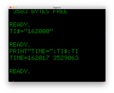

Thanks! Apart from Ctrl-C not yet working, it's otherwise stable. With 3583 bytes free it has the same free memory as the VIC-20. This is really a coincidence. The version we have running is an early one for the Commodore PET.

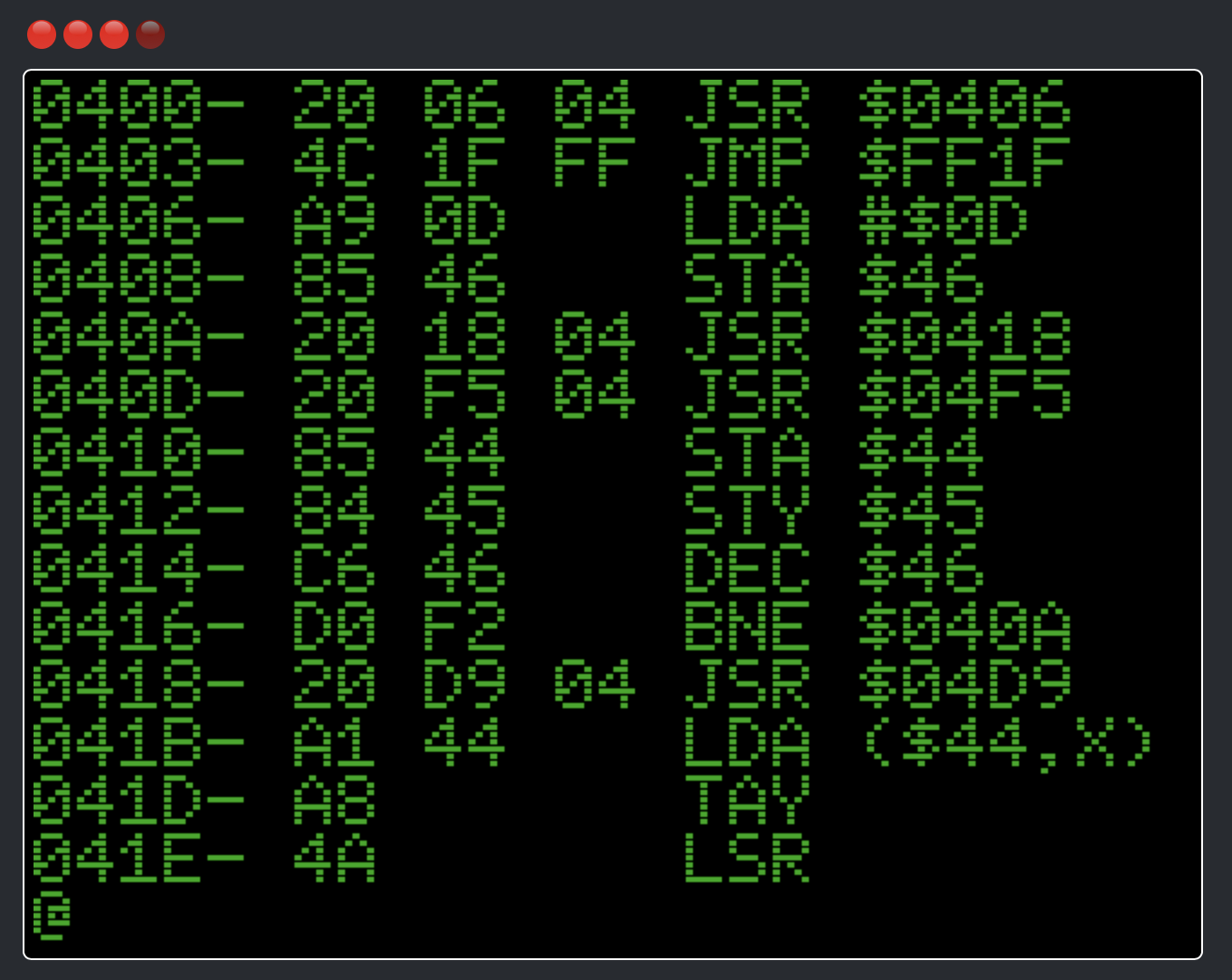

Although the system can interpret 6502 code, there still was work to do: code, buffers, zero page variables and stack needed relocation. But that wasn't the biggest hurdle as Michael Steil's excellent set of

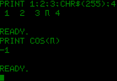

Of course we then went overboard and added a flashing cursor, we made sure that the WAIT 6502 Easter Egg works, and that there is a π-symbol. The Gigatron doesn't have that in its font, but it does have T and U.... And... the font is stored without horizontal spacing, so there's our glyph:
R S T pi U
v v v v v
x x x x . . x x x . x x # # # # . . . x
x . . . x x . . . . . . # . . # . . . x
x x x x . . x x x . . . # . . # . . . x
x . x . . . . . . x . . # . . # . . . x
x . . x . . . . . x . . # . . # . . . x
x . . . x x x x x . . . # . . . # x x .
0 1 2 3 4 5 6 7 8 9 a b c d e f 1 1 1 1
^ 0 1 2 3
font82up
Good enough for me:
