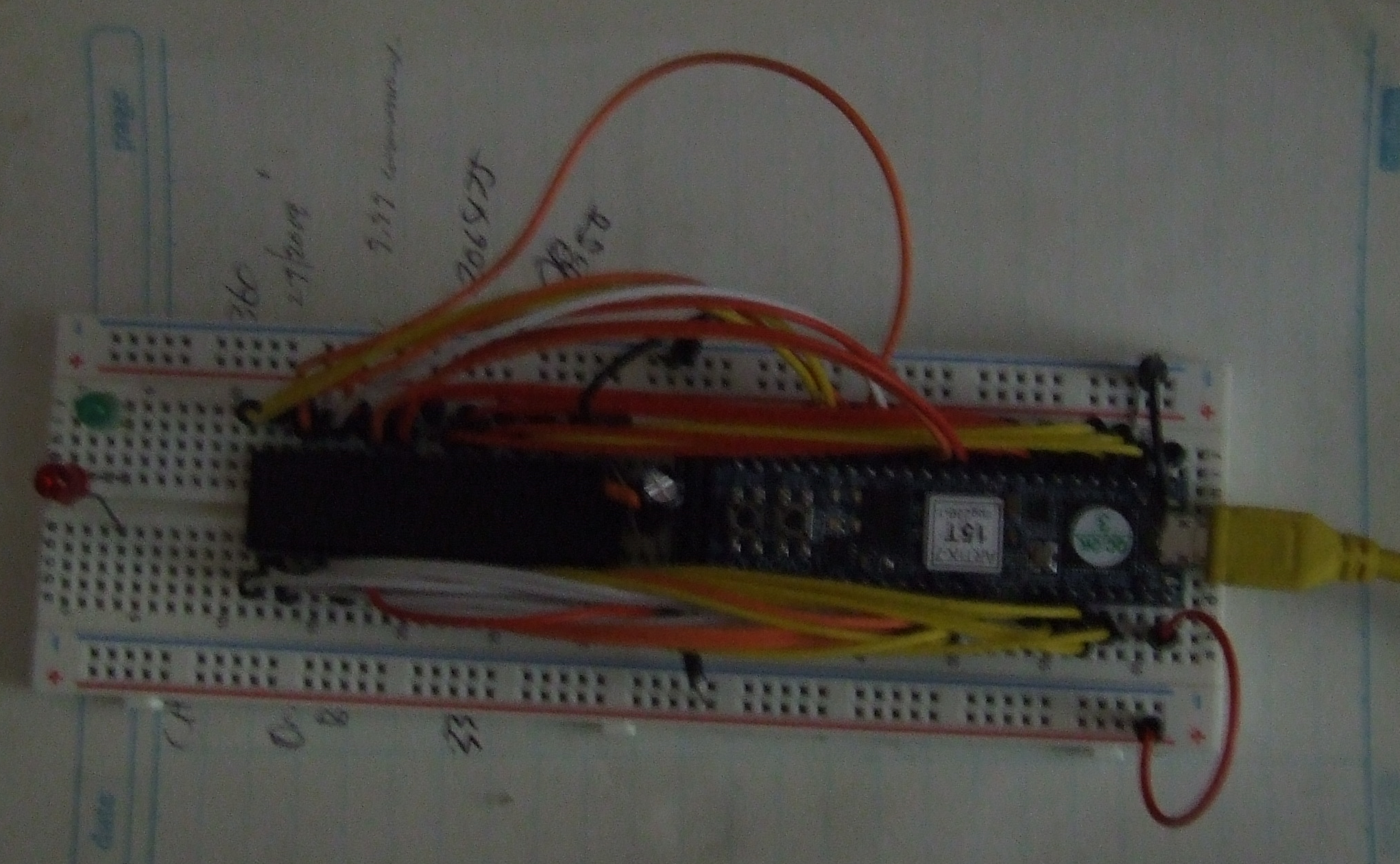

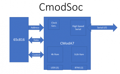

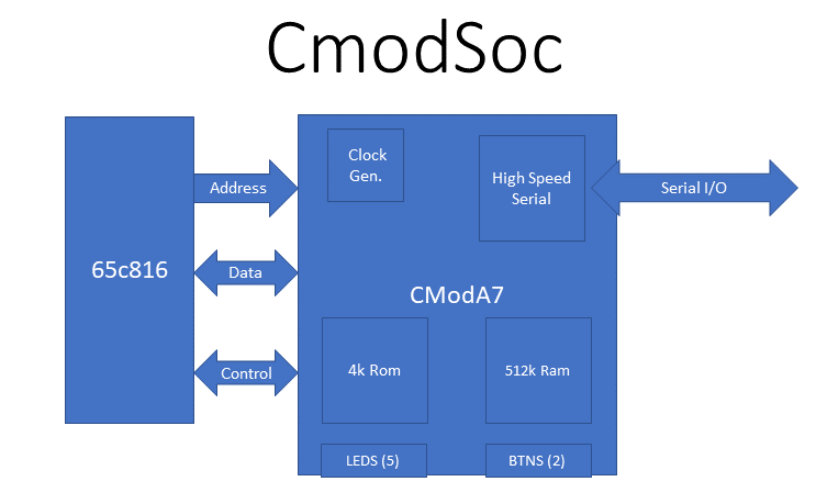

I've got this project going on in the background with my other work to interface a CmodA7 to a 65C816. It doesn't quite work yet. On reset the blue LED lights up indicating the cpu is accessing the ROM, but it doesn't light up another led like it's supposed to or send a power on message. The cmod contains a high-speed uart (921600 baud), ram, rom.
Block Diagram
Block Diagram
Photo of system
Photo of system

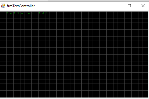

The ‘816 isn’t actually transmitting directly through the port. Instead it writes to dual port memory. The other side of the dual port memory is connected to the uart transmitter in a DMA fashion. The DMA just loops around repeatedly through the transmit buffer. So, the transmit buffer somewhat resembles a text video buffer.
There’s a program running on the PC workstation that can pick up this repeated transmission and display it in a window. The baud clock (14.7MHz) is about 0.25% too slow but it seems to work okay.
HelloWorld
HelloWorld
The "hello world" is hard-coded in the transmit at the moment.
The cpu is powered by about 3v and clocked at 6MHz. Two power diodes are used to drop a 4.5v USB power down to about 3v.
Found two bugs yesterday, the reset line going to the cpu was active high and it should be active low, and the ready line needed a pullup resistor. Initially I forgot that the ready line is bi-directional on the ‘816. Then I made it a tri-state I/O on the FPGA but forgot the pullup.

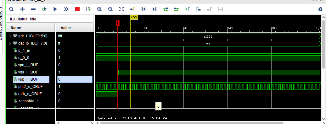

I hooked up the logic analyzer to the inputs from the 65c816 and found out it's mostly garbage. It looks like I bought bad/fake chips. Unless there's something else wrong with the system.
From the logic analyzer, the vector pull line doesn't go active on reset, and the address bus is all ones. I've seen it reset to $FFFC and flip back and forth between $FFFC and $FFFD doing a vector fetch non-stop, but with no active vector pull. This is the second chip I tried. The first one didn't work at all.
Logic analyzer trace
