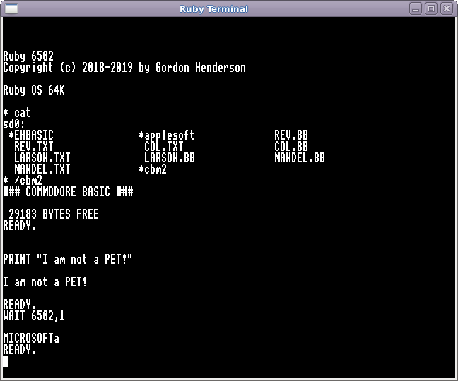

mvk wrote:
I haven't decided yet where I will put the interpreter and user code. In fact I might borrow some from screen memory, because I'll need to do something similar with MS BASIC later on.
ehBasic would be the "canonical" BASIC to port, however if you want MS Basic 2.0 in the guide of Commodore Basic 2.0, then get in-touch:
It plays nice with my Ruby system which is very Beeb-like in it's current form - so zero page$00-$7F is all it needs, along with stack. However I didn't use it's input mechanism, but the one the RubyOS provides, so you might need to write a "getline" type function.
(I also changed the Easter Egg code - originally it poked screen at $8000 which is where it lives in my system, now it just calls osWrch)
