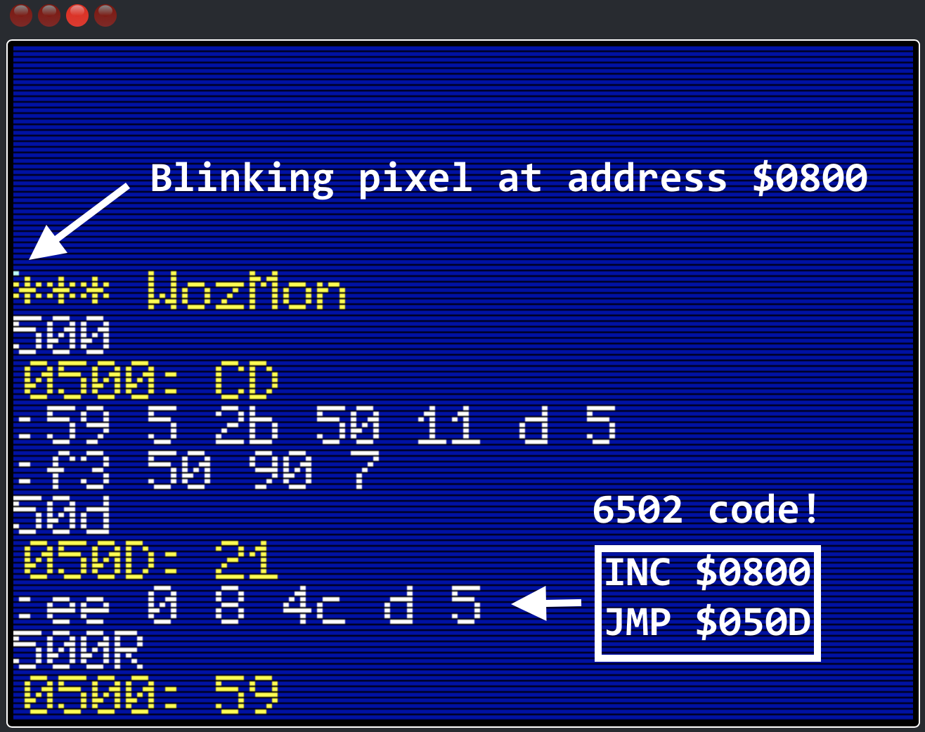

The proof of concept works. All of the addressing modes are implemented, and a fair amount of instructions as well. The v6502 interpreter runs in place of the standard 16-bits application vCPU. Switching between the two is a matter of modifying a zero page variable, so very fast.
