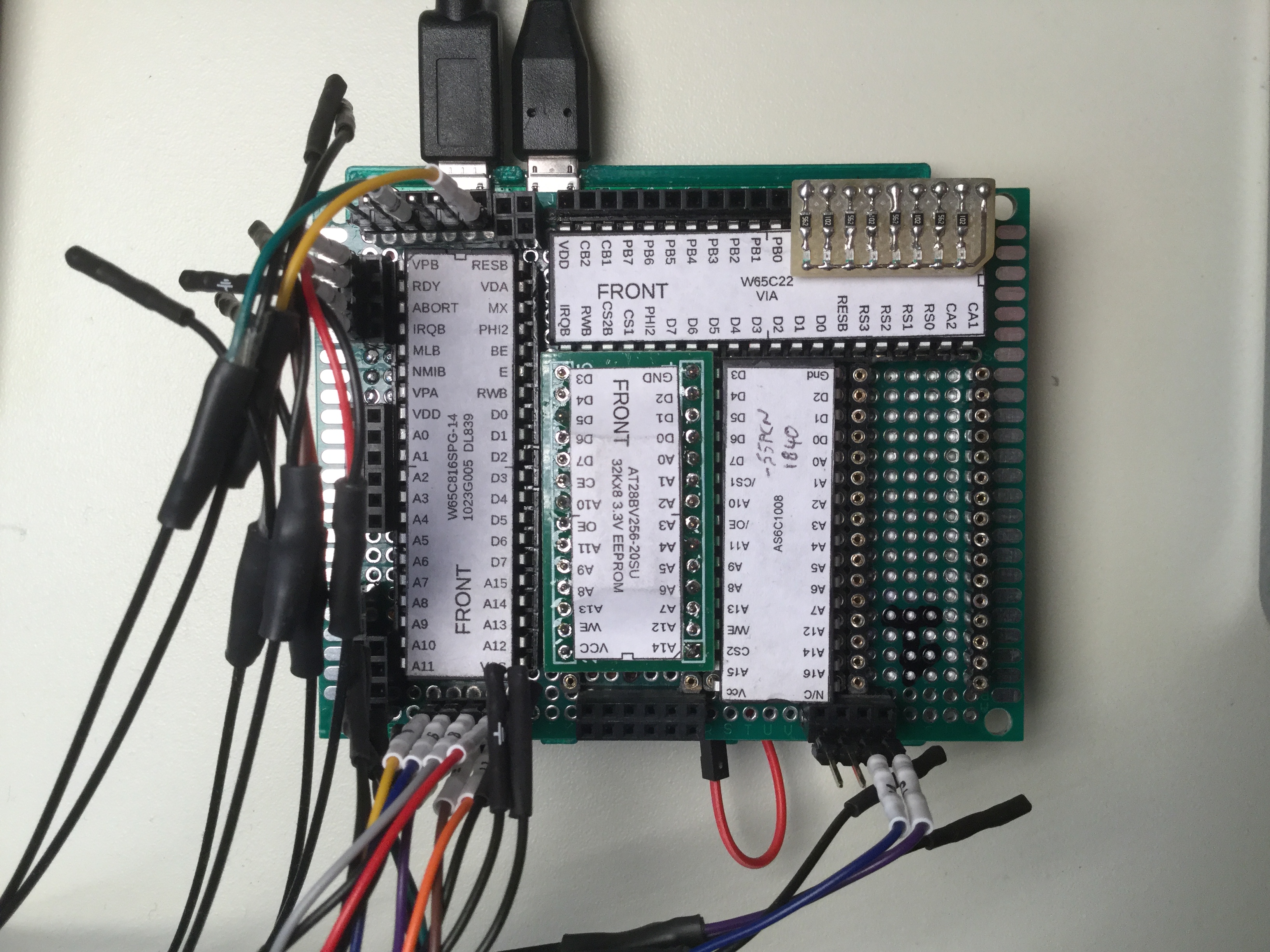

Hi,
I recently bought an eBay WDC65C02 chip which turned out to be a blacktop 65C02 but it was still fun. My first setup was on a breadboard with hardwired NOPs and it worked! I moved on to using a CPLD to drive the 65C02 and provide a real program. This worked as well!! Inspired by this success I purchased a WDC65C816, a WDC65C22 and SRAM from Mouser and lots of jumper wires on a triple wide breadboard. Blinky lights!
This whole thing has now morphed into using a BlackIce II FPGA board as the ROM/clock for the 65C816, the 65C22, 128KB SRAM (AS6C1008) on a hand-wired protoboard hat. I am thinking of adding a 32KB EEPROM and have purchased an AT28BV256. Is this a good option?
The EEPROM runs at 3.3V and can be programmed in-situ. It looks like it takes about 10s to program 64K. I plan to have the FPGA hold a bootrom which will allow the EEPROM to be programmed.
Anyway, this has been great fun so far and kudos to this site and the amazing amount of info and discussion.

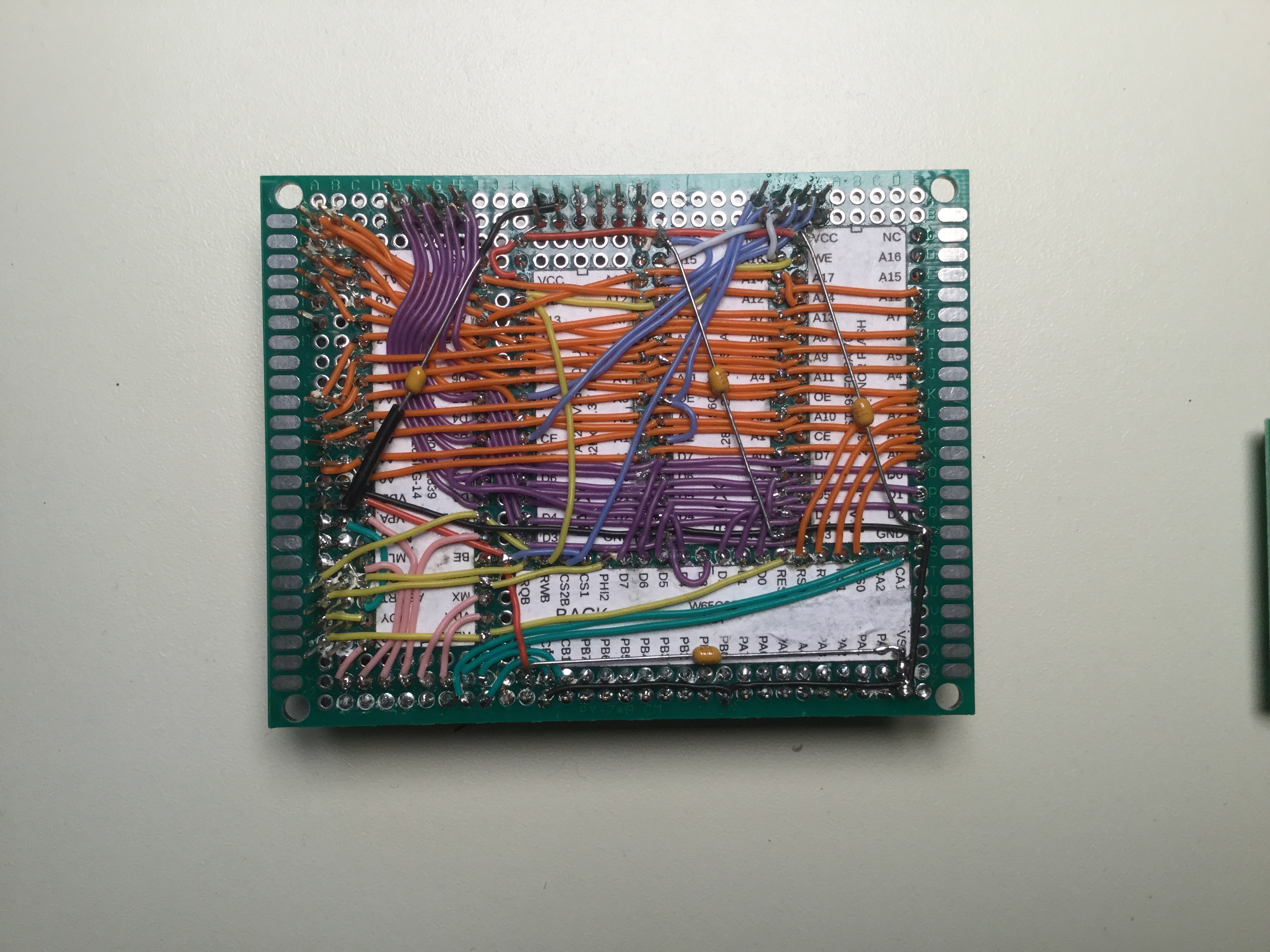

I programmed up EHBASIC into the FPGA BRAM on the BlackIce and I can now PEEK and POKE the EEPROM from BASIC. Here are some photos of my new toy. Even with all the knitting on the back it seems to work fine at 10MHz. The SRAM is 55ns so guess I shouldn't expect more. Maybe I will try it using the 10ns SRAM on the BlackIce. The EEPROM is much slower (200ns) so when I have programs in there it will be the limiting factor.
65C816 board on BlackIce II with logic analyzer attached.
65C816 board alongside BlackIce II

The dark side.
The dark side.
