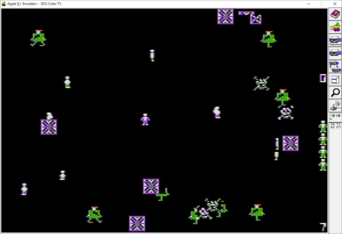

Robotron has a great gameplay. It's getting crowded pretty quickly - that's a strength, but it has a steep learning curve. There are distinct types of levels (called "waves" in Robotron), regarding the type of robot enemies you have to battle. The waves get increasingly difficult, fast. In the "Tank Wave" (first occuring as #7) there are Quarks pulsing around and spanning multiple tanks, each shooting bouncing shells https://youtu.be/t7_hvzIaqxk?t=134, that's a good player, still struggling through #7.

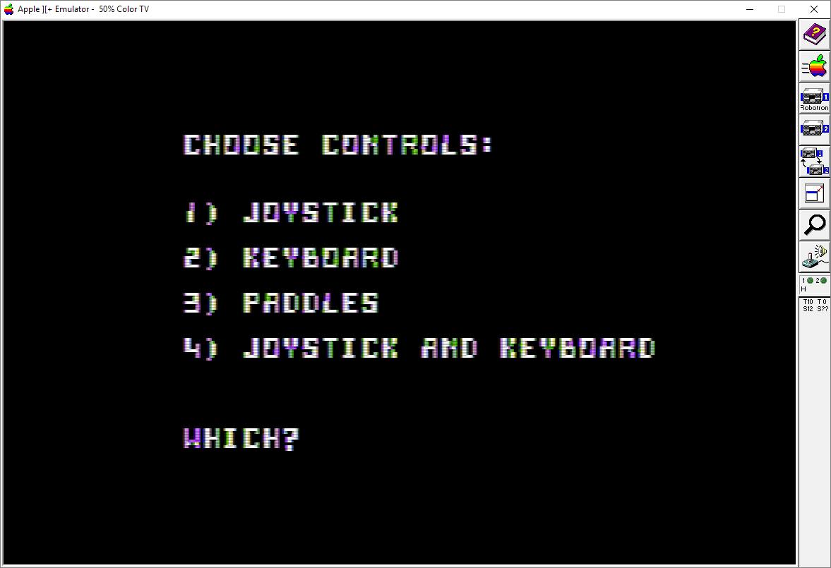

Problem: It takes time to get to this level - - no savepoints, no way to train a particular wave. I therefore inserted a screen to the configuration menu where you can select the wave you want to start with:
The game continues to the controls menu:

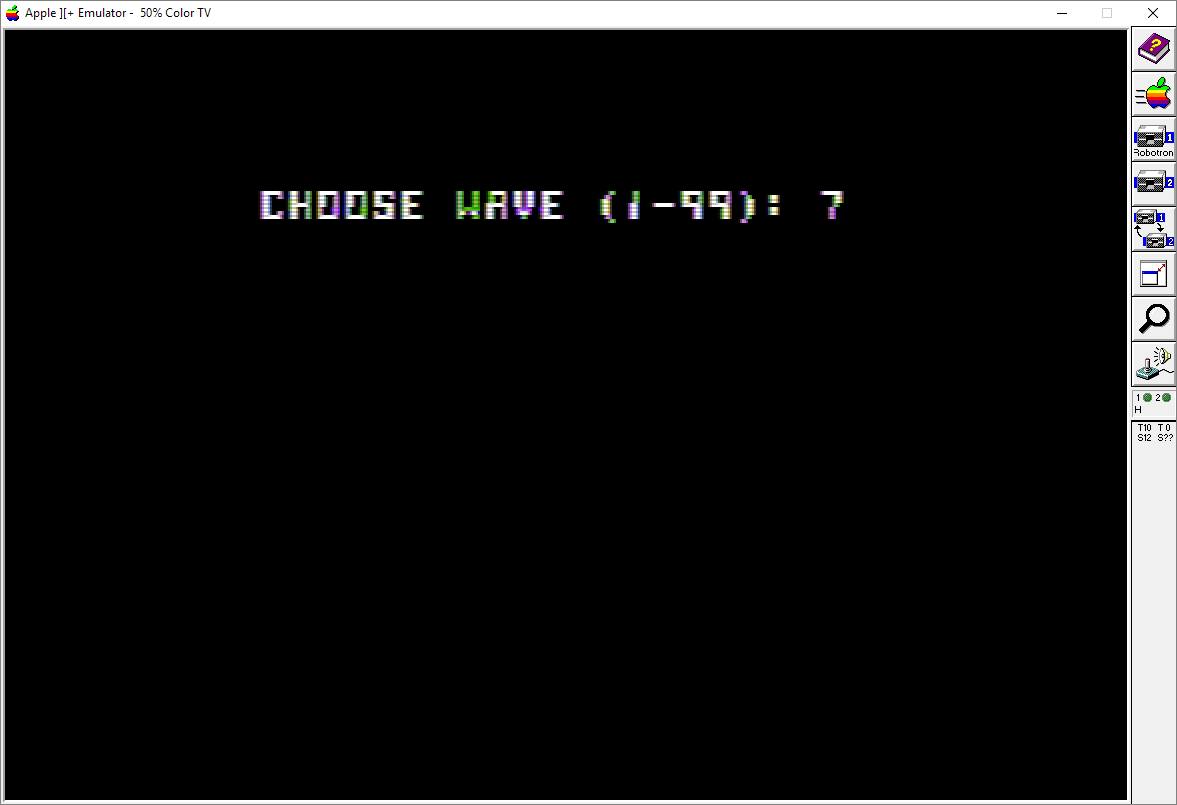

The game then starts with the Tank Wave, score is 0:

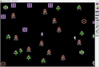

Robotron cycles through the types while throwing in some additional robot types and generally ramping up the total number of enemies. Here is Tank Wave #27, with two additional Spheriods lurking in the corners:

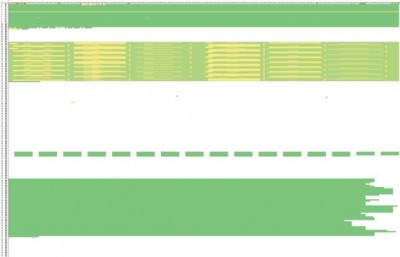

I have started to get a closer look at what's happening in terms of reads from and writes to memory. The problem is of course not collecting the info but rather condensing it sensibly. I first tried to group the access in pages, for the different subroutines as suggested by sark02 earlier in this thread. The info is of course helpful but only on a per-subroutine basis. Given the overwhelming number of instructions (and even subroutines) in Robotron, I decided to try to see the bigger picture first, on a per-byte basis.
It's work in progress so it's a bit premature to share it here, but maybe you guys have feedback to offer on how to progress from here. That's the reads from a couple of seconds of the intro (up to $CFFF, i.e. including the softswitches but excluding the higher parts of the ROM):
That's really the big picture - - a heatmap with all reads, each line of blocks a page. I can zoom in:
Address and access count of the selected block is shown in the status bar:
Beginning $2000 is the memory which is mapped to the screen. I had first assumed that I should not see any reads here, only writes, but you can see the effect of the code updating "sprites" in memory. The algorithm obviously needs to know what's in a particular area of the screen to remove and display pixels correctly. Related to displaying graphics are the pages $1200 and $1300. Access to the pages have the same color (i.e. exactly the same counts in both pages for each byte). These are the lobyte/hibyte lookup tables to translate logical pixel line into the where those lines physically reside in memory.

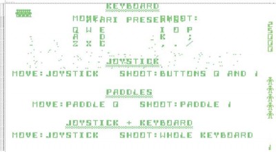

The Apple II is severly constrained in terms of memory. Consequently, Robotron uses for the "cut scenes" the actual game code to display elements like the player character or enemies. From a reverse engineering point of view this is fortunate, because I can use the uncluttered (and even scripted) movements of elements on the start screens to understand how the game moves "sprites" around the screen. For an example see the movements of the player character on the screen explaining the controls.
I've extended the read/write tracking of the workbench from my last post to project what's happening in memory onto the simulated screen. In the following pic you can see the "echo" of the beginning of the movement of the player character on the controls screen (i.e. what you see in the Youtube video, the character going from left to right first.)

... I can visually do a trial-and-error to constrain the shown range of cycle counts (which I use as global clock) until I only see one particular "frame" of the movement:
