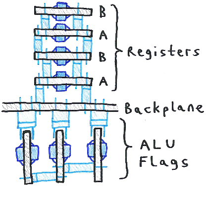

I had mentioned, that to me it looks like our 20MHz CPU design is at its physical limits.

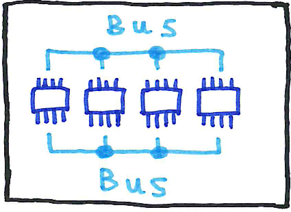

When taking a look at the PCB layouts, our register section and the bus systems attached to it in a very simplified form looks like this:
To have shorter signal traces, I would suggest a different approach:
Black: PCB,
Dark blue: chip,
Light blue: connector.
When considering the 65832, I would suggest to have two registers 32 Bit (with individual R\W control for each Byte) per register PCB,
that's going to be a lot of control signals, and one certainly should spend a lot of thoughts on how to distribute/route them.
Edit:
It's a very simplified drawing, the layout\placement of chips and traces on the register PCBs is still debatable...
...but it _could_ happen that one ends up with the CPU internal address and data bus at opposing edges of the register PCB.
Also, when considering to have the CPU internal address bus and data bus at opposing edges of the register PCB,
it's an interesting question where in the CPU to physically place the bus interface to external memory.

PostPosted: Sat Apr 13, 2019 2:09 pm
Interesting ideas! Especially the Cray-like techniques for reducing overheads.
For me, as soon as it looks difficult to run the whole system at some speed, it makes sense to look at decoupling. Each clock cycle of the CPU can be a different length, depending on what is being accessed. Even a small cache could be helpful, because many accesses are sequential. In the case of 6502, you might get a gain from specific caching or write-buffering of page zero and page one.
Performance modelling is the answer, I think: not to build all possible systems, but to model them in software.

Nice idea to get this discussion started Dieter. Love that 3D construction! :)
I’ve had a chance to refine some thinking on this, and I think it just might be possible for the TTL CPU (Rev B) to run at close to 50MHz. I know, kinda crazy! :shock: I’ll post more extensively about this on the original build thread later, but below is a brief summary for now. (I’ll try to keep the discussion fairly generic here). There are three key concepts:
The first is to eliminate decoding and setup overhead at the start of each cycle. The current implementation spends up to 19ns on strictly preparatory tasks (microcode decode, register select, register enable). This seemed quite reasonable last go-around, but in fact it represents nearly 40% of the cycle at 20MHz! The new idea is simple: complete all setup tasks ahead of time in the prior cycle. With that done, the setup delay is eliminated entirely, and performance would improve dramatically! There are complications, of course, but it sure seems feasible. (The key is registered ALU inputs and a separate DECODE phase. More on that later).
The second key concept is really a consequence of the first. In preparing ALU inputs ahead of time, we can also invert the B-Input of subtract operations in the prior cycle. By doing so, we can eliminate the XOR gates that typically sit in front of the adders in the ALU itself. That might not seem like much, but at these speeds, every gate counts!
The final concept is that the flags can indeed be set in the cycle following the ALU operation. The trick to maintaining cycle accuracy is to do it in a separate pipeline stage which completes in a half cycle (a “WRITE_FLAGS” stage). By arranging things carefully, it’s possible to interrogate the flags in the second half-cycle of a subsequent branch operation, and it all ends well. It’s certainly tight, but I think the timing works.
Based on an initial analysis, the three mods above reduce the critical path of the TTL CPU to just 21ns! (typical tpd). With a little coaxing, and some luck, we just might get to a 50MHz max clock-rate! :D
Now, at these speeds, we will definitely need to use RAM for microcode storage. That does imply bootstrapping on powerup, but standard SRAMs can easily meet the timing requirement once loaded.
Then there is the issue of construction — I’d like to take some measurements across the existing boards with a 50MHz clock just to see how bad things get. Who knows, maybe we can get away with the current trace length? Anyway, there’s lots of work still to do to validate, and the ideas above may improve results even further. Very exciting. As always, any and all input welcome!
Regarding the C64, I’ve been thinking about an adapter that will let the TTL CPU run at high clock-rates even while connected to a C64. It would be a fairly simple affair, with shadow RAM and appropriate wait-stating. I’d like to include a GAL address decoder too, so it can be programmed to work with any 6502 or 6510 vintage system. It would be very interesting to look at ideas to improve performance. (like caching, write-buffers, etc. ... shadow RAM seems a simple way to deal with zero and one page, but not screen RAM — that would really benefit from a write-buffer!)
Anyways, yeah, how cool would it be to have a 50MHz retro computer with a totally retro TTL CPU to boot! :)

Distributing the control and clock signals and arranging the function blocks in 3D to have shorter trace lengths
also is a big construction site, any ideas\suggestions on this ?

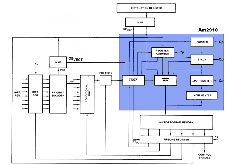

One way to go for compacting the microcode would be the AM2910 approach.
The idea is to have a fast lookup table which generates the start address for the microcode sequence for a given instruction.
Downside is, that you would need to have a microcode address counter feeding _all_ of the address lines of the microcode ROMs.
AM2910 also had featured calls\subroutines in the microcode, for instance with a one level deep hardware stack
one could have the sequence for nearly all of the addressing modes of the instructions as subroutines,
this will compact the microcode even further.
When following this path, maybe one could stuff the whole K24 functionality into less than 2k of microcode memory.
A different trick would be using something like two lookup tables and a (for instance) 3 Bit state machine.

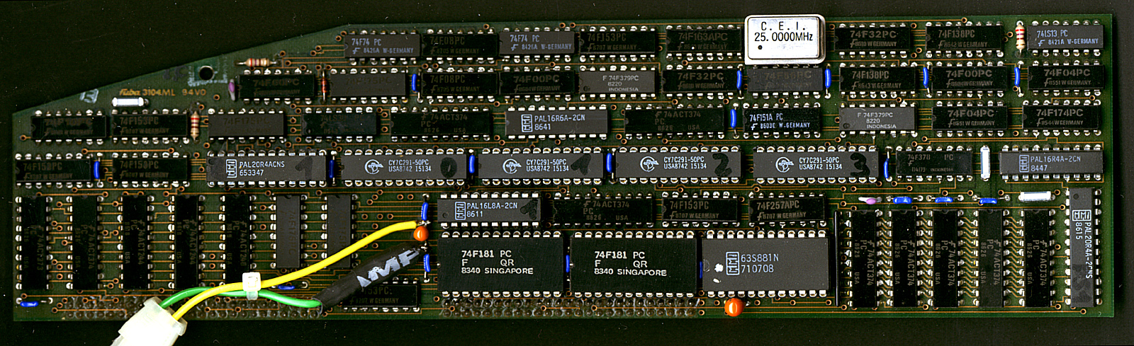

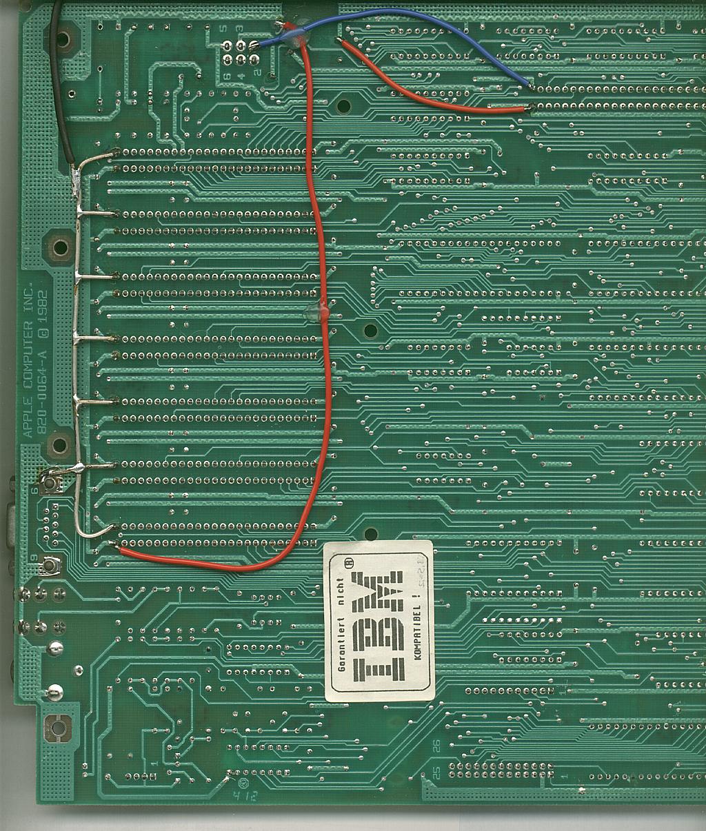

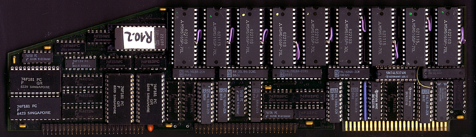

In 1987 I bought an accelerator board for my Apple IIe. The source:
My card runs the CMOS instruction set at 12,5MHz and has 144kB of fast RAM because it emulates an Apple IIe with 128kB DRAM on motherboard. The board was really two boards :-) One in the slot, the other as piggyback onto the first.
This one is the first:
The piggyback:
The two creators (Schaetzle & Bsteh) developped this CPU primarily for their chess computers, or for acceleration existing chess computers.
https://www.schach-computer.info/wiki/i ... p/TurboKit
http://chess-computer.blogspot.com/2015 ... 8-mhz.html
I've heard that one board exceeded 20MHz.
In late 1987 my Apple IIe ran at 12,5MHz, the RAM disks ran with 333kB/sec (read) and 500kB/sec (write). Now I'm preparing to resume this Apple IIe. I bought a new power supply because this cards consumes 5A @5V and I don't trust the old switching power supply. The original power supply can just deliver 2,5A for the whole machine. New fans will be installed too. And I wrote accelerated drivers for the RAM disks (AE RAMFactor): 800kB/sec (write) and 500kB/sec (read) :-)
If anybody knows another owner of this Apple II accelerator board please notify me. I have never seen another board from Schaetzle & Bsteh. I just know that my board was the first built to emulate an Apple IIe instead of a II.
Regards,
Ralf

It's great to see the TK20 boards. Thank you for posting these pics! I was not aware ones existed for the Apple IIe, and you say yours was the first. Very cool.
Interesting to note 74F family ICs, six 74F181s no less. and multiple PALs. Wow. Lots of "iron" on those boards. :)
