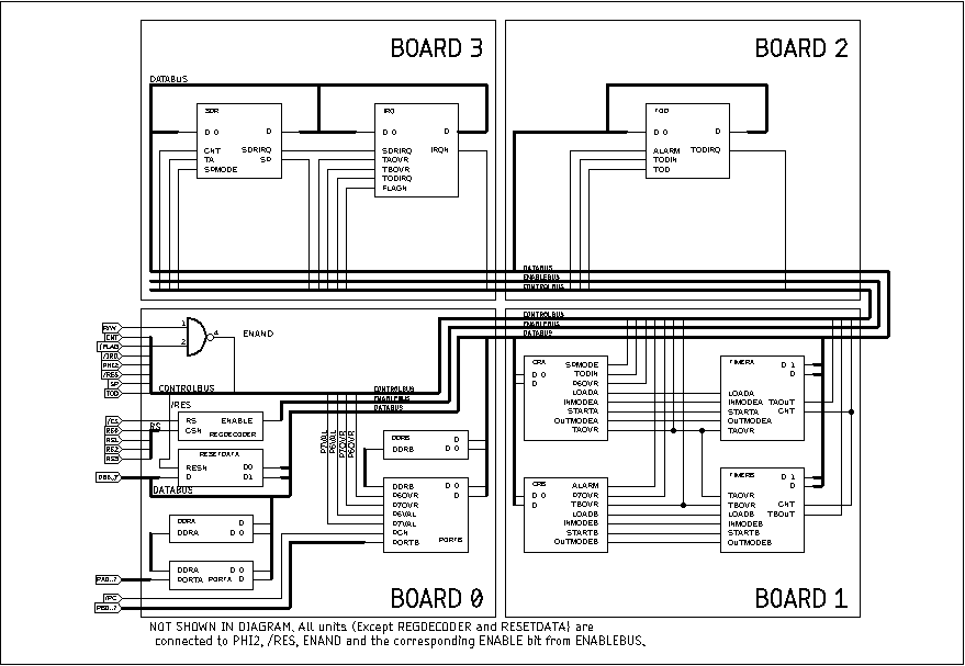

Let me show you what've done until now.
I plan to split the design in 4 separate 10cmx10cm 2-layer boards. Cutting cost is the main factor here, as this are the biggest boards I can get manufactured at the lowest cost. Not ideal, but good enough for 1 Mhz.

So far, all the glue logic, and both DDRs and PORTs fit nicely in Board 0. Next, I'm going to build a prototype of the ports. I have two spare real 6526 so I'll connect them to my prototype to make them talk to each other. Hopefully I'll be able to get some insights on how the outputs are configured.
I probably should mention... I have no measurement equipment. No oscilloscope, no logic analyzer... just an extremely cheap multimeter that's falling apart! So right now I'm a bit limited at what I can do. I plan to buy them in the near future though.

At some point you would need to buy an oscilloscope...
But when trying to build something like a 4 MHz TTL 6526, I think that a used 60MHz analog scope from the "flea market" might do.
Say... it looks like you have two nearly identical I\O ports and two nearly identical 16 Bit timers in the design.
If you would make schematics and layout for one PCB which contains one I\O port and one 16 Bit timer,
then order/solder two identical PCBs, I think this might save you some time and effort.

Well, well... Time to go back to the drawing board I think.
Design for CREG and TIMER is complete and feels functional... However, it's not cycle exact. There is a one or two clock cycle difference regarding timer start, underflow, etc. I feel one or two cycles may be good enough for most cases but... It's driving me nuts at the moment!
I'm following this https://ist.uwaterloo.ca/~schepers/MJK/cia6526.html as reference, as it's the most detailed description of the timers I've been able to find, and, with my current design... Adding all those delays was rapidly increasing my gate count. Still... it doesn't seem complete... it doesn't mention loading the timer from the latch on a write to TxHI when timer's stopped....
Sometimes I wonder if the engineers at MOS/Commodore just put together some pieces of silicon, and afterwards, just write their documentation based on how it behaved, instead of doing it the other way around!
Anyway, by starting from scratch with both units, I think I'm now headed to a clearer, easier and more accurate circuit. We'll see!
Also... I've just bought a 1541 and it should be here in a week or so, so you can expect some exciting news by then.
Cheers!

Timer control logic for the 6522 gave me quite a headache, too.
Would be nice to know what the circuitry in the 6526 silicon looks like,
but I think we won't be able to start dissecting it in 2019.
Maybe they sometimes just had not enough time at hands for writing documentation.
Quote from an interview with Bob Yannes (inventor of the SID):
"The funniest thing I remember was getting in a whole bunch of C-64 video games which had been written in Japan.
The Japanese are so obsessed with technical specifications that they had written their code according to a SID spec. sheet (which I had written before SID prototypes even existed).
Needless to say, the specs were not accurate.
Rather than correct the obvious errors in their code, they produced games with out of tune sounds and filter settings that produced only quiet, muffled sound at the output.
As far as they were concerned, it didn't matter that their code sounded all wrong, they had written their code correctly according to the spec. and that was all that mattered!"
If you do hardware design for a living, you are used to datasheets that are not 100% correct and\or leave out some "subtle" details, sorry.
That's the right spirit: better a design with bugs than no design at all. :)
Anyhow, the first revision of new hardware always tends to end up in the trash can, so please don't worry about getting things 100% cycle exact _now_.
BTW: had problems to get hands on down_counters, so for implementing the 6522 timers I just had used 74163 up_counters
and inverted the 74163 data inputs and outputs with some 7404 chips to make them look like down_counters to the CPU.
Inverting bus buffers (74540) would have worked, too.
You got to be creative. :)
Dieter.
