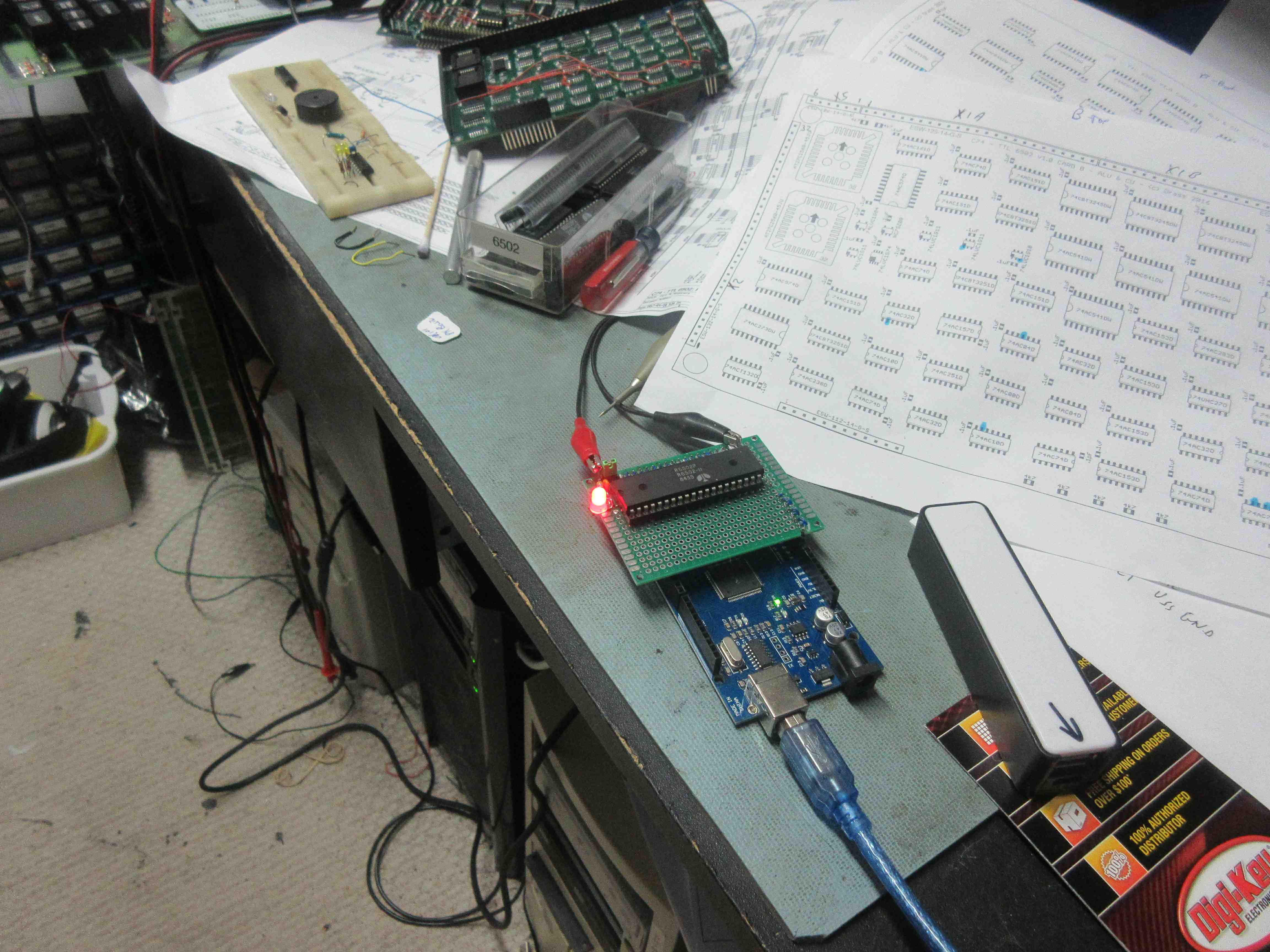

Josh wrote to say he has resumed work on his C74-6502 after a brief hiatus. He sent along an action shot of his workbench ... :D (posted with his permission)
Seen on the wall are jumbo set of C74-6502 schematics, and also a pair of populated PCBs on the bench. Fantastic!
Josh, when you get a chance, you might want to post about your cool Arduino test environment for the CPU (pictured below):

Like all things, you can't fix something without the right tools!
I needed something that will exercise a 6502 CPU, so I figured I would put an Arduino Mega on the job.
On my bench, you will see a 6502 plugged in to the top of the Arduino.
I am clocking the chip by using I/O commands and observing the bus for correct operation.
Building test routines for various instructions.
Once done, I'll apply it to the C74-6502, and should have it fixed in no time!
Josh

I've got my Arduino 6502 tester working reasonably well. It's testing about 90% of the 6502 functionality. However, the C74-6502 is showing some quirks that don't match the 6502 processor. It's hard to nail down and/or describe. I am not pulling out the logic analyzer yet, I'm trying to just get around it by poking different numbers into the black box. But, for anyone's curiousity, here's what I've done so far with the Arduino 6502 tester:

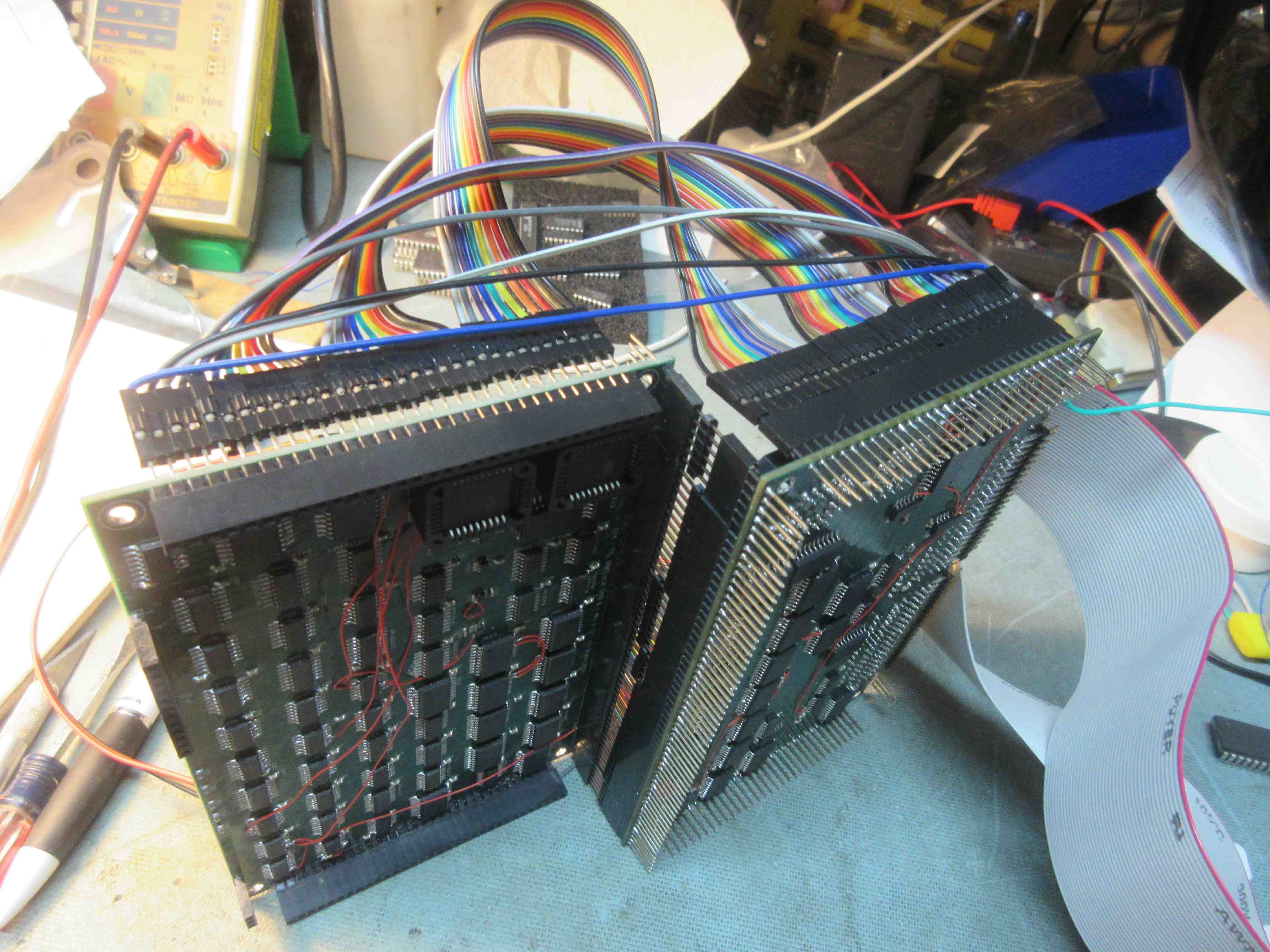

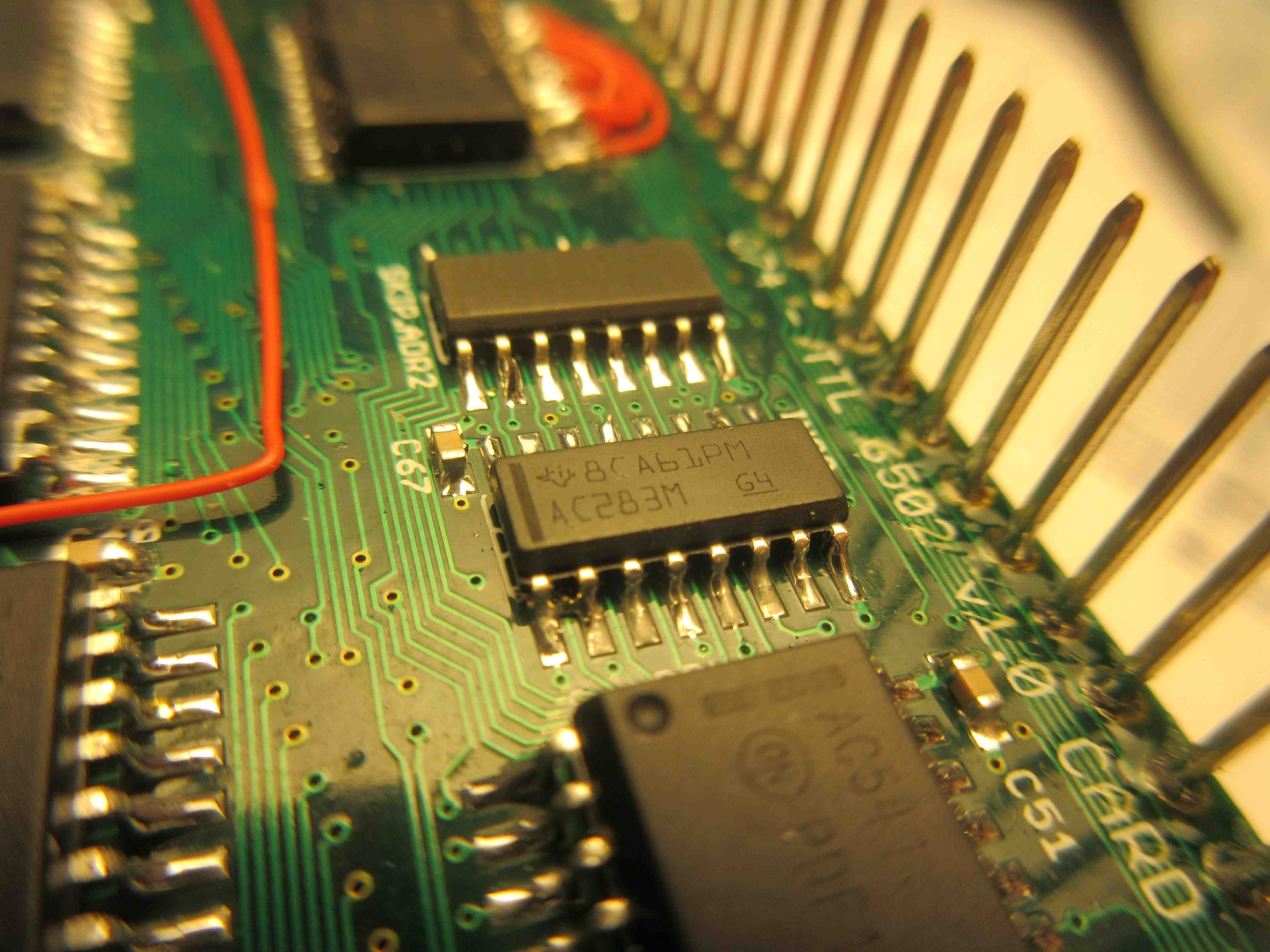

Well, I'm finally finished trouble shooting these boards. Found 4 problems in total... all my fault for not being more careful in soldering and younger! or at least having very good eye sight.
Problems #1 and 2 on Board A were solder shorts, see below.
#3 was a pin lifted for an early mod was left lifted. I failed to go pin by pin to reconcile all the mods.
#4 was a pin that didn't get soldered.. looked soldered but was a good 0.004" off the board.
While all these faults could have been fixed through careful visual inspection, I just couldn't find them!!!
It's a relatively big circuit done with very small parts!
Pictures of boards separated by jumpers for trouble shooting. Boards are flipped to each other to allow the bigger connector to be used directly.

Well, this project is now come to a close.
Please come see me at VCF MW in Chicago in September if you would like to see the C74-6502 in action!
Regards,
Josh Bensadon
Toronto
