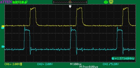

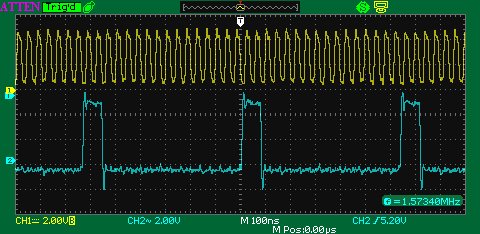

One possible way to synchronise multiple CPU's is alter the clock ratio.
I've done a quick and dirty test on a breadboard. It's got a 25.175mhz can oscillator (as that's what I had!) driving a 74HC163 4 bit synchronous counter.
The B C and D outputs from the counter feed the A B and C inputs of a permanently enabled 74HC138 3 to 8 decoder to produce 8 non overlapping clocks with a 7:1 high to low ratio. Sending the Y0 to Y7 outputs from the decoder through a 74HC240 inverts the signals to produce 8 "CPU clocks".
If the same Y0-Y7 outputs controlled the enable pins for set of 74HC244 buffers for each CPU then they would all only be connected to the target memory for 1/8 of the time but appear to have full access.
The test board produced a high time of just under 80ns which is comfortably more than the access time for modern SRAM. A 32mhz master clock would have produced 2mhz CPU clocks and 60ns access periods.
The question is then whether 8 CPU's in the 1-2mhz range is a worthwhile goal.
File comment: Two CPU clocks

File comment: 25.175 MHz master clock, 7:1 ration CPU clock at 1.57mhz
