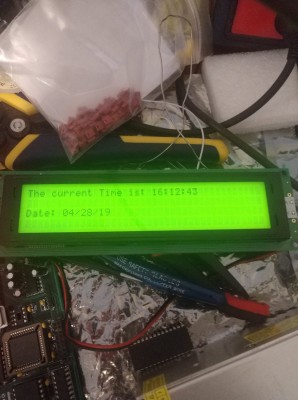

So I haven't been back to this thread for a bit, thought I'd post a bit of status on the project.
I wrote the display driver, and have the RTC working, so last night I got the display showing the current time and date:
(the month was set wrong in the image, I fixed that afterwards)
Today I'm going to see about setting up a rudimentary audio driver that will use VIA2's Timer 2 clock output to output square wave frequencies for a set amount of time.
I'll set up a git repo soon to share my assembly code, after I've finalized it a bit more.
