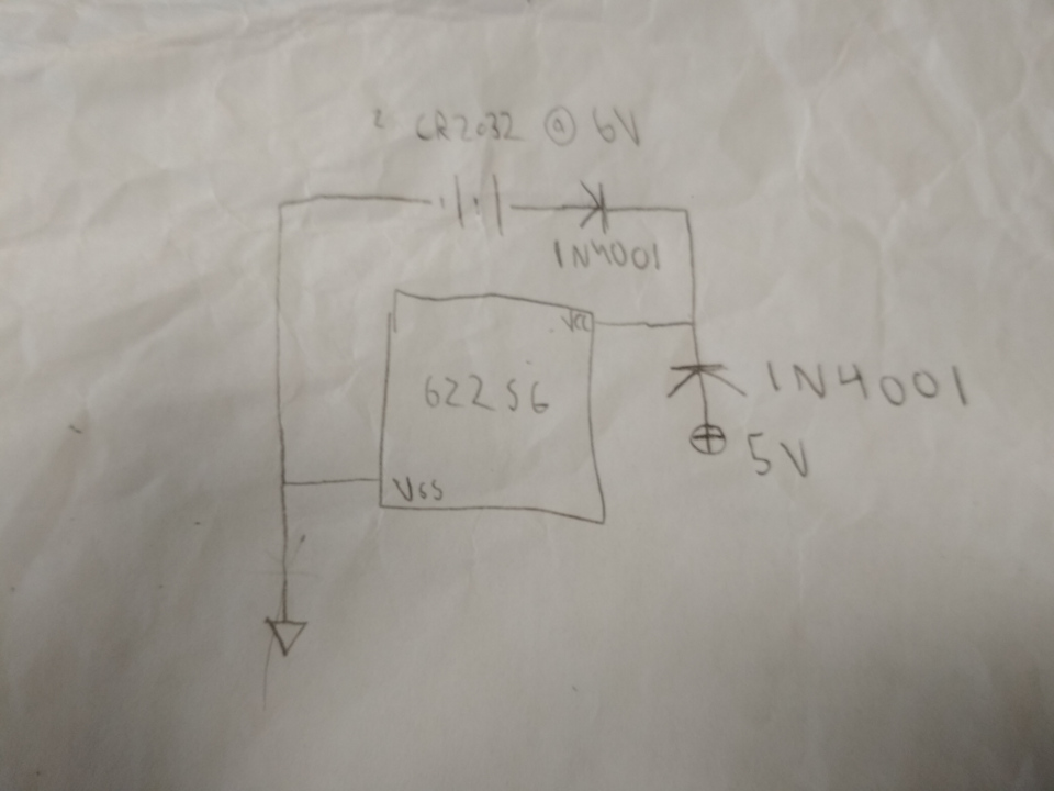

Greetings,
Recently, I've been unable to write to a 28c256 EEPROM despite my best efforts (http://forum.6502.org/viewtopic.php?f=12&t=5584). Due to this, I've began looking for alternatives and my idea right now is to use a battery to maintain an SRAM chip powered while I transfer it from my programmer to my board.
I am planning to use 2 CR2032 batteries for a total voltage of 6v (Unless 3v is enough to keep the data on the chip?) and a couple of diodes in order to keep the battery from powering other parts of the board, and to keep the power supply from overpowering the batteries.
This is my circuit diagram:
Would this work? This simple circuit is the first I have ever designed, so any pointers would be appreciated.
PostPosted: Thu Mar 28, 2019 6:00 pm
Posts: 1005
I would use a single CR2032 and a pair of Schottky diodes like the 1N60P to ensure the battery diode turned off when the 5V is applied.
The no-load voltage of a CR2032 is about 3.3V~3.4V giving you up to 6.8V total. The Vf of a 1N4001 at very low current is under 0.8V, so you might end up draining your CR2032s pretty quickly while the RAM is active.
The standby current for a something like CY62256NLL (note the LL designation) would amount to practically no load on the CR2032.
PostPosted: Thu Mar 28, 2019 6:53 pm
Posts: 8510
If the SRAM has a low-power data-retention mode, it will work on just a couple of volts. You don't won't 5V on it for that, as the power requirement will be much higher. I show a simple circuit at viewtopic.php?f=4&t=573&p=32004#p32004 (although it sounds like you might not be particularly interested in long-term backing on fleapower.)

Hello, I'm very new to everything concerning circuit analysis (Though I'm trying to learn as fast as I can). I have a few questions concerning the functionality of figure 1 in that image:
1. How do the resistors connected to RD, WR and CS prevent current from flowing when 5v is connected? Shouldn't current always flow through these resistors (Although less of it), making the input on these pins always high?
2. My intuition tells me that he higher voltage coming from the power supply prevents the current from exiting the diode near the lower voltage battery. Is this assumption correct, or does a small amount of current always flow out of the battery?
3. Why would you need to open the switches from RD, WR, and CS whenever the power supply is inactive?

PostPosted: Fri Mar 29, 2019 2:44 am
Joined: Sun Mar 24, 2019 8:00 pm
Posts: 20
I have a couple of 1N5822 Schottky Diodes on hand, and from the graphs on the datasheets, as far as I can tell they have an even lower forward voltage than the 1N60P. Would they work?
Is there any reason why the Vf vs A graph of the 1N5822 looks like a logarithmic function as opposed to the 1N60P looking like an exponential function?
PostPosted: Fri Mar 29, 2019 2:53 am
Posts: 483
Location: Australia
The pull-up resistors are there to keep the control inputs in their false position when the 5v power fails. Pull-ups are generally chosen so that they can do their job quickly enough, but also so that they can be overwhelmed by an output driver. A CMOS output ideally shorts to Vcc or GND, depending on its state, and the real-world ones can approximate this fairly well.
When the 5v power is applied, the voltage across the diode is -1.4v, so the diode doesn't conduct. I would expect the battery to be under no load with the 5v power active.
I think the switches would need to be opened to prevent the battery from powering anything else. There are protection diodes on the I/O pins of most chips, and you can actually power things through those if you're not careful.
PostPosted: Fri Mar 29, 2019 4:17 am
Posts: 8510
DerTrueForce answered part of it, so I won't repeat that.
Note that the NiCd battery is charging (through the transistor base) when the power is up. I'm not fond of NiCd batteries, but the article was printed over 21 years ago. Doing it today with a lithium cell, you'd probably want a zener diode or maybe blue LED across the battery so current continues to flow after it has reached full charge, without damaging the battery. I have not taken the time to figure out the best way to do it.
Note also that Schottky diodes have a lot of reverse leakage.
PostPosted: Fri Mar 29, 2019 2:24 pm
Posts: 1005
The 1N5822 diodes are silicon and the 1N60 diodes are germanium, that explains why their Vf vs. Af curves look so different.
Also, the !N5822 diodes, as Garth mentions, do have a fairly high reverse leakage current. The 1N60s are far better in this respect.
However, this PDF from Cypress does not recommend the method you are suggesting (with the addition of a required resistor from chip Vcc to /CE). https://www.cypress.com/file/38171/download
Depending on your circuit, it may or may not work very well. They suggest using a supervisory chip to look after the RAM and give examples.
There are non-volatile static rams available. Have you looked into them?
Thank you! That PDF from Cypress was very useful. I read through it, and it says that this type of design is not recommended because the diodes inside of the microprocessor might draw too much current and drain the battery. This is not a problem, though, since I only need to have the battery active for a very small amount of time while I swap out the chip. I might also have to use the pull-up resistor shown there as well, since I didn't know floating pins could be a problem (Could floating pins cause an inadvertent write?)
I also looked at the nvSRAM and it looks like it would do exactly what I need! However, it doesn't come in DIP and it is very expensive. Since my whole purpose of doing this was avoiding the cost of an EEPROM programmer, it wouldn't be very good for my purposes.
I will also follow your advice and use the diode type you recommend.

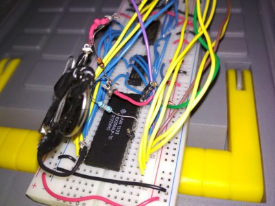

So I've been implementing the design:
As you can see, I used a couple of paperclips and some electrical tape as the battery terminal, and I connected an 18k resistor to the CE/ pin as a pull-up resistor.
I can't get it to work, all information is lost when I disable the external power. While disconnected, if I measure the Vcc pin with a DMM, I do get a constant 2.7 volts. If I measure the CE/ pin, however, I get only about 1.3 volts.
I've reasoned that what might be wrong may be any of these things:
I've shorted out the battery with my paperclip connectors a couple of times now, so it might be nearly dead.
I got some pretty crazy resistance values when measuring from the paperclip to Vcc (50k ohms), which may be limiting the current.
Maybe the pull-up resistor value is too high.
At this point, I think my best option is to cut my losses and change the way I connect the battery to the IC. I could buy a terminal, but I have been unable to find one for these coin batteries around here. I was thinking of using a large clip with something that insulates better than electrical tape and also a couple of metal plates. But I don't know what type of metal plate I could use, any ideas? Also, can I simply solder some wires directly to the batteries, or will that expose the acid?

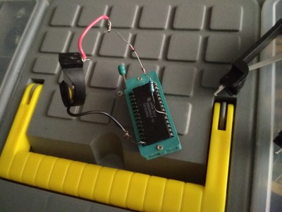

I finally got it to work! I redid the whole assembly, but it looks like the problem was not in the assembly itself. Here is what it looks like now (Note that the ZIF is not part of the assembly and only used here to keep the IC upright for the photo):
It looks like when powering up the arduino and setting some of the pins to outputs it sets them to low by default. This was solved by setting the CE and WE pins to high before setting the pins on the arduino to output.
