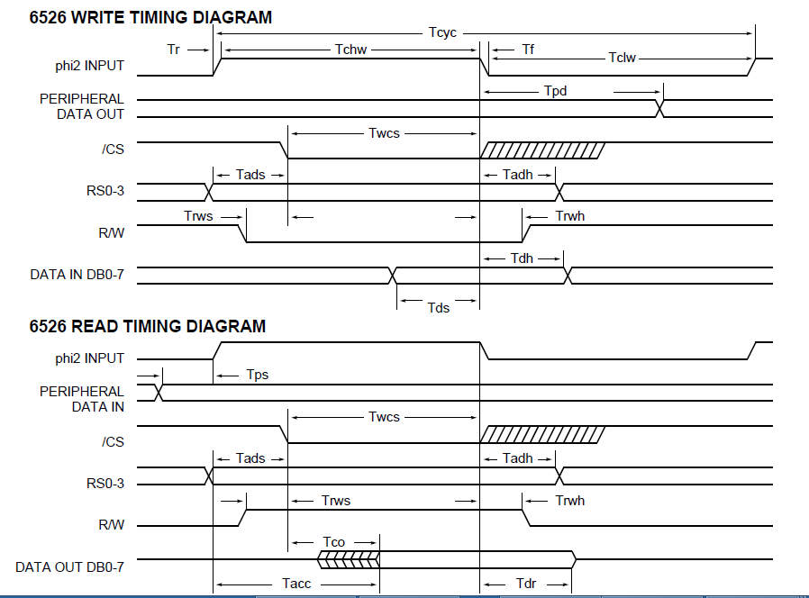

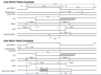

I think I've got the bus timings more or less right... and before I start building a small prototype for testing, (And who knows, maybe blow up my computer!) I'd like some advice from you experts.
To get the most basic test case, let's suppose I only have a 74377 8bit register (With a /E input, and positive edge triggered clock) to hold 1-byte value, and a 74244 tri-state buffer to output that same value to the data bus when requested. So, for this test circuit, I use PHI2, RW, /CS (Provided, in this case, by the C64 PLA) and the data bus as inputs. We can ignore the Address bus at the moment, as my little 8bit register will appear in the whole range this chip is selected by /CS.
File comment: Simple 8bit register
File comment: MOS6526 Bus Timing Diagram
I'm pretty confident about the "Write" portion of my schematic, although I have some doubts about inverting the PHI2 clock. I'm doing this as the 74377 write is triggered on a rising edge, but, the 6526 latches the input on the falling edge of phi2. By the time PHI2 falls, /CS, RW, and Data will be stable so, the positive edge of my inverted PHI2 will make the 74377 latch the value in the databus.
The "Read" portion also seems OK. When /CS is low, and RW is high, the 74244 will be enabled and its contents available in the databus, so the CPU can read the value at the falling edge of PHI2.
No matter how much I read (Documentation, Datasheets, forums), I find many different solutions and I feel the only way to be 100% will be to test it, but any previous advise... will be very much appreciated!

Thanks! According to a 74HCT377 datasheet I intend to get, /E has to be low 18ns before the rising edge of the clock input. According to some timings I have for the C64... /CS and RW are setup for at least, 420ns, so plenty of time here..

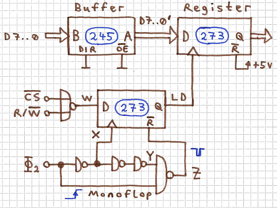

74377 is a bit exotic, and you already have noticed that clearing all of the registers at RESET won't be fun when using 74377 based registers.
So I just wanted to toss in an alternative approach for using 74273 chips as registers:
Looking forward to watching your progress, good luck.

I considered using 273 when I was starting with this... but I wasn't able to find an adequate logic to enable the register write. I will give your idea a try. It really feels it will save a few gates. Fortunately, right now I don't think I'll have an issue with board size.

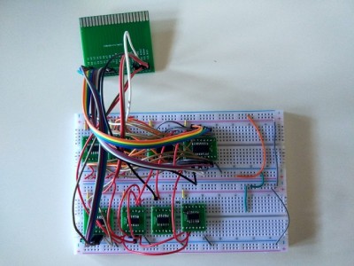

BTW, here's my first contraption :
I'm pretty proud of it... especially since I've also created the Expansion Port adapter, the SOIC to DIP adapters, soldered them myself (My first try at SMD soldering!) and it did work on the first run. Beginner's luck maybe?

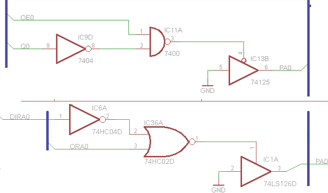

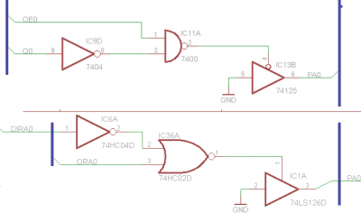

After you got two registers working (a data register and a direction register),
please take a look at the datasheets of 74125 and 74126
// 74HC(T)125\126, 74AC(T)125\126 etc.
There might be other buffers (or logic gates with open collector output) that might look interesting too,
