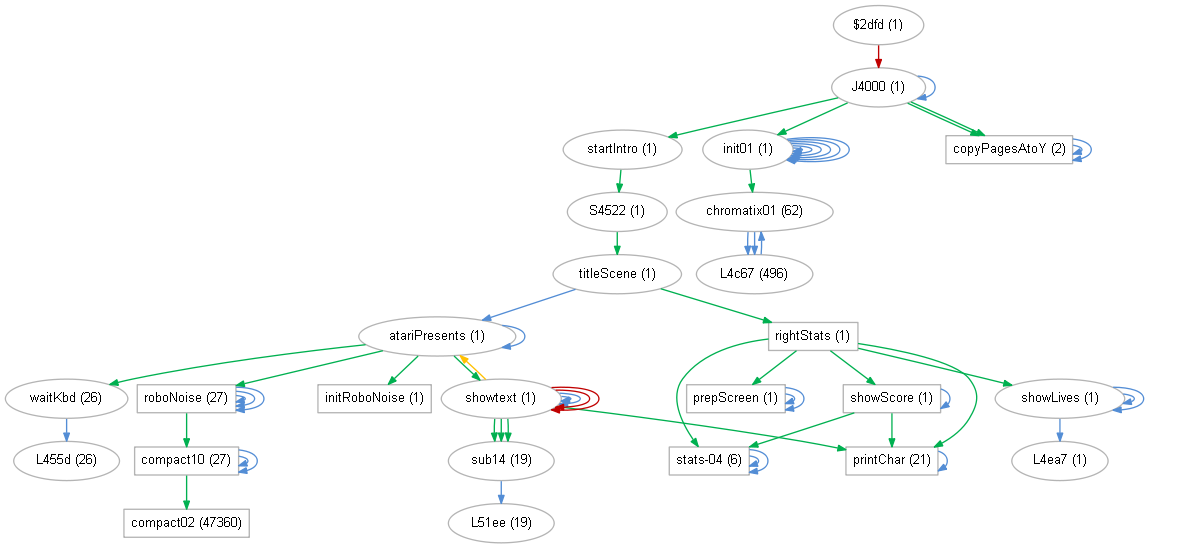

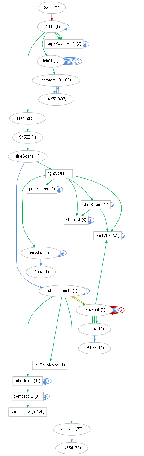

I've continued working on a way to generate the "big picture" of what's happening. As an example, here is the screen after a couple of seconds of execution:
This is the corresonding auto-generated call-tree.
  • JSR = green
  • JMP = red
  • branchings (if taken) = blue
  • RTS if not paired with JSR
The paired RTS are not shown, if they did they would return to the sources of the green arrows. The showgext sub displays "Atari presents" at the top of the screen. The string is supplied as param immediately after the JSR to showtext, therefore the RTS does not match that JSR and is shown in yellow.
The nodes are "stretches" of code which the automatic analysis shows to be related. For the nodes with a box shape the analysis determines that it is a regular subroutine. Arrows shown are between stretches, not between the actually leaping instruction (which is somewhere in a stretch) and the target it leaps to (which is in the same or a another stretch). This pruning of the call tree is important, especially for bigger trees, because with otherwise the huge number of arrows and nodes gets confusing and unwieldly. As a side effect, complex stretches with many branches catch the eye (init01, showtext with JMP-loops inside the stretch).
The call tree gives a good impression of the overall structure and gives hints on the execution flow. For small call trees that's fine, but for the bigger ones I am currently trying to understand it is difficult to discern what comes first. I've therefore added the following alternative view:

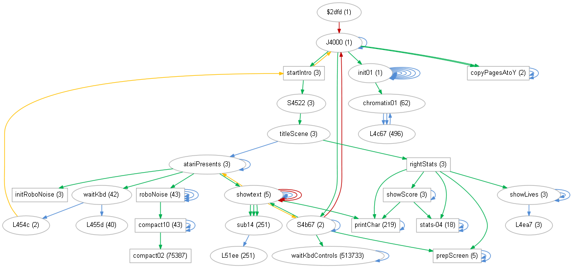

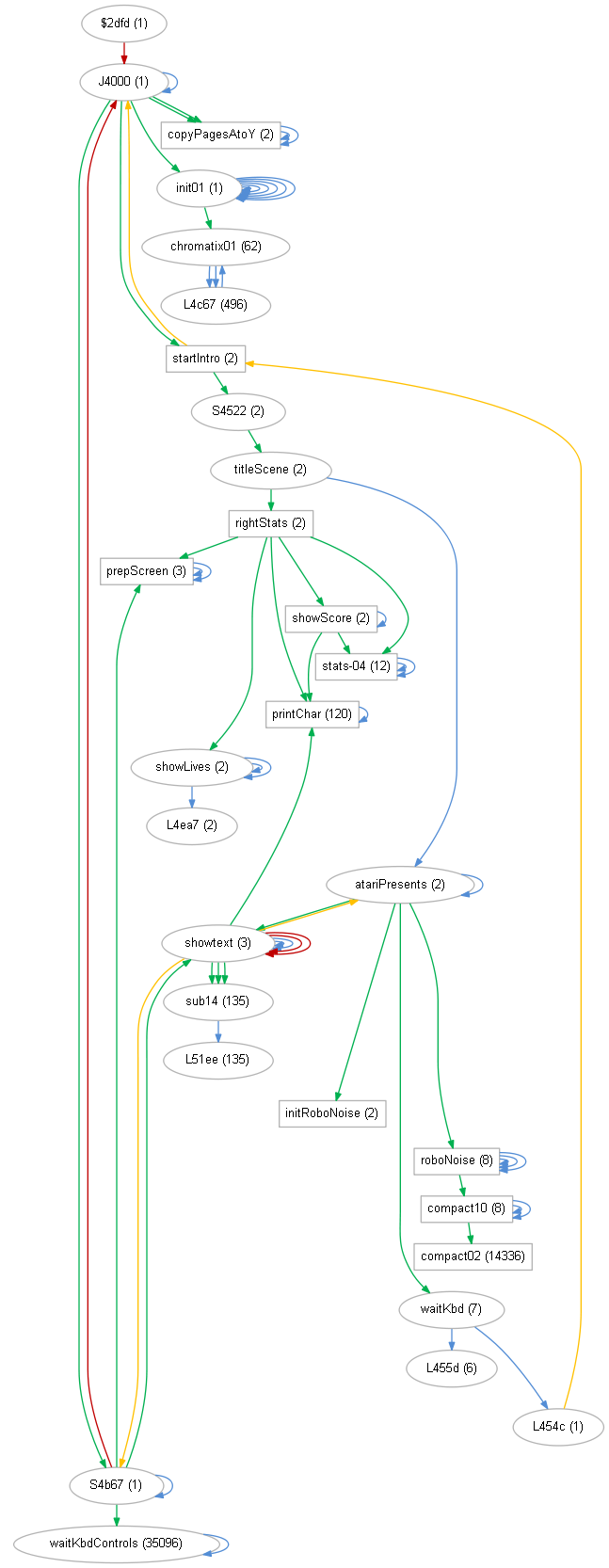

Here the nodes are ordered vertically by the cycle count of the first execution of that particular stretch. (The nodes are randomly ordered in horizontal direction, to fill the available space as best as possible). You can follow the init01 doing its work in the beginning, then the intro starts with the title scene which contains a part which shows the stats on the right side of the screen, then the "Atari presents" and then the noisily dotted "Robotron" animation.
printChar is used twice: first to show the score, later to show the "Atari presents". A node is located where its stretch executed for the first time, so there is an upward JSR arrow from showtext to printChar. Showing nodes only once is another type of pruning which has turned out really helpful for bigger trees.
The second alternative also shows major loops. If I press space then the intro screen changes to the control selection:
If I press escape then the intro starts over with the "Atari presents" and the "Robotron" visualisation. The corresponding call trees:
The call tree shows the return to the intro sequence, but using the cycle-timed layout the flow of execution becomes more evident, with the yellow RTS jumps showing how the code is stitched together:
Together with the load/save snapshot feature of the workbench this has really given my understanding a good push forward. But it's of course just the superficial picture of the executing code. More insight will have to come from not only seeing the flow but also understanding which stretches read and manipulate memory. I haven't started with this topic yet, though.
That's a great idea. I've personally never gotten much value out of call graphs, but this effectively turns it into a readable flowchart. Nice!

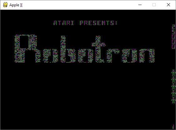

I've managed to understand some important subroutines completely, on my own, for the first time ever :)
(Don't worry, I won't bother you every time when I understand anything new, it's just a heads-up ;) )
This is a snippet which is part of the game's intro screen:
$456c  atariPresents JSR showtext
                     ; $0d marks new line, followed by x/y coord
                     ; x in chars (0-39), y in hires pixel lines
$456f                .byte 0d 0c 12 "ATARI PRESENTS:" 00
$4582  doneAtari     RTS

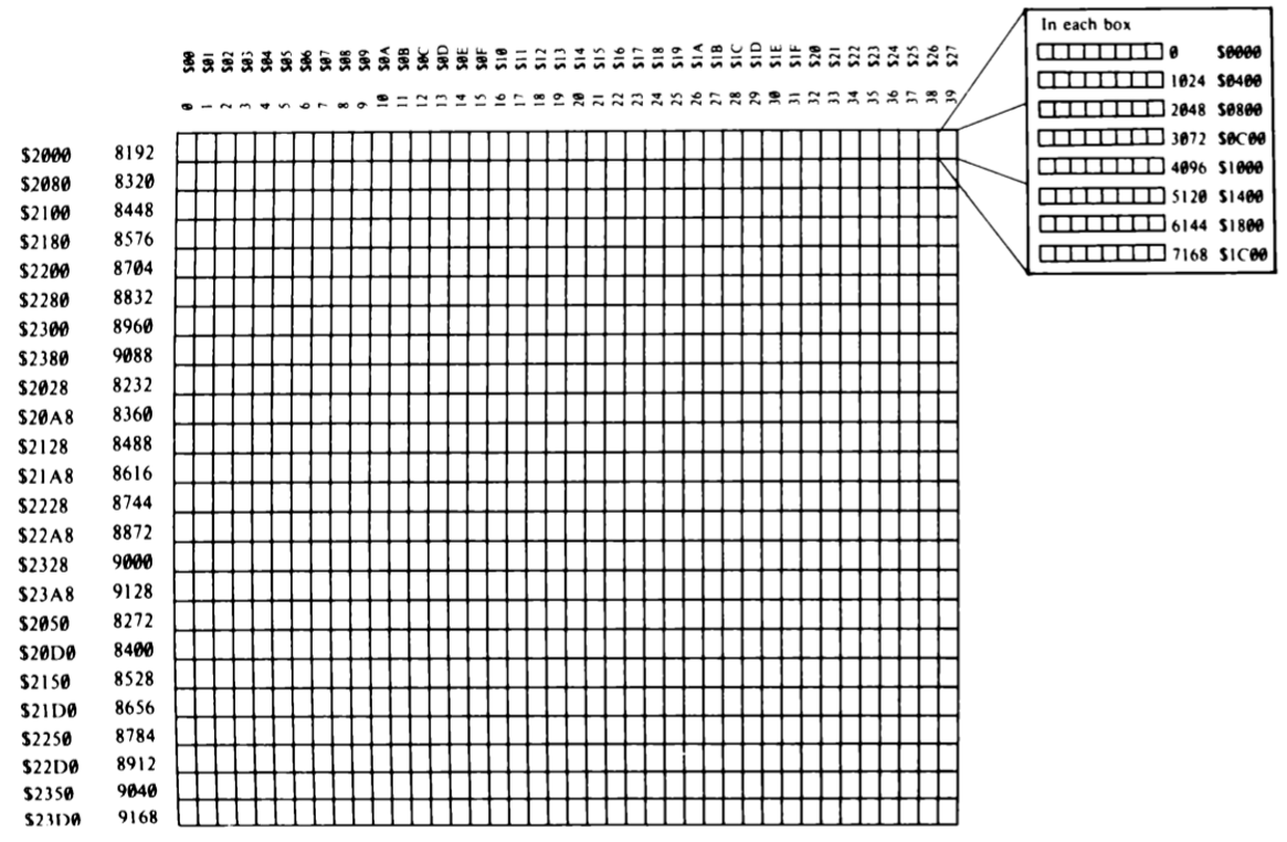

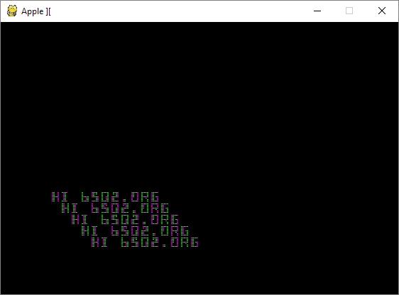

Understanding the printChar, on the other hand, needed info about how the Apple II deals with hires graphics. The way the addressing of pixels works was optimised for needing as little hardware as possible. Certainly ingenious at the time, but from today's vantage point it resides in the "Nostalgia" board of this forum for a reason, I suppose.
TL;DR: The layout of the pixels on screen differs substantially from the layout of bits in screen memory.
If I remember correctly, this was the point in high school where I stopped dealing with Apple II lowlevel stuff and branched off to Turbo Pascal etc. Today I have access to many excellent primers on the net, including PDFs of Apple II manuals, so "understanding on my own" doesn't really hit the mark, of course. ;)
Looking at printChar, it's not difficult at all to deal with the arcance addressing scheme:

A neat feature is the self-modifying code in L511c. $fd contains $12 and $ff contains $13, so the tables in $1200 and $1300 are the lo and hi bytes of the start addresses of the pixel lines. What remains is adding the horizontal character position.
