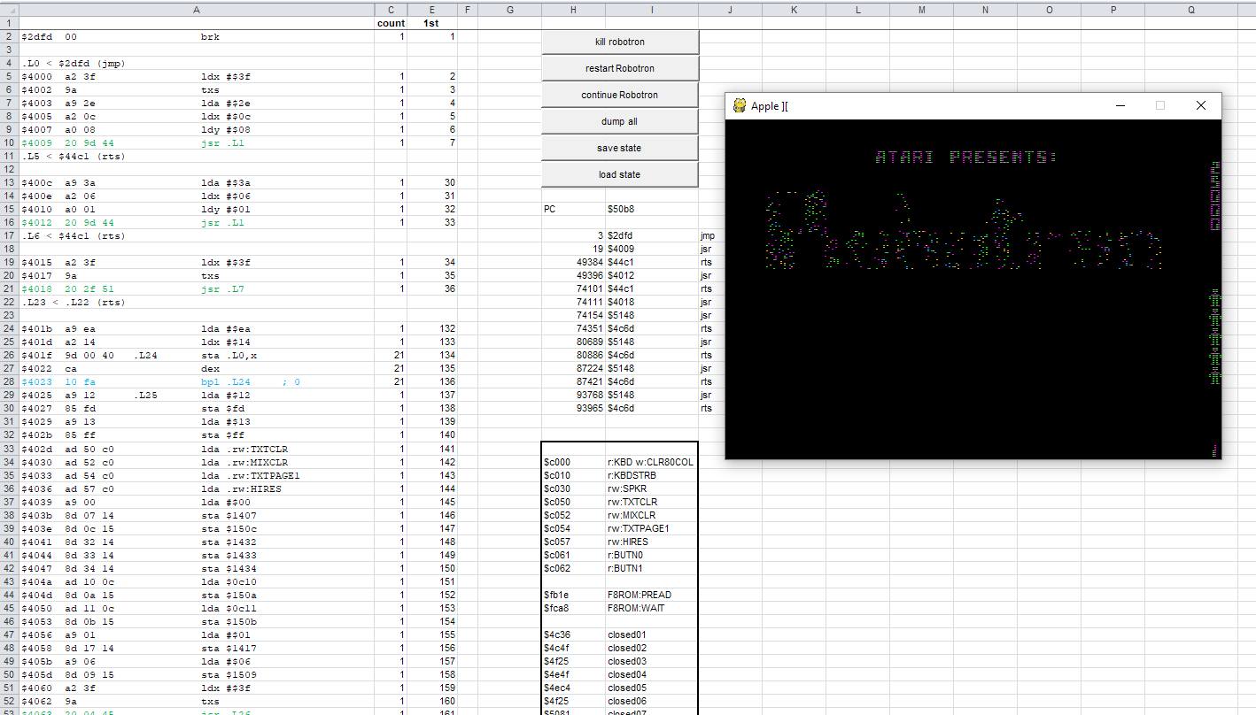

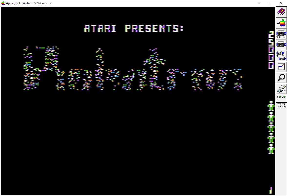

Here 2 images, one from AppleWin, showing the very first part of the Robotron intro, the other one a view on the Excel workbench - - just to give you an idea about what I am working with right now.

That's interesting - - there are 4 TXS occuring in the Robotron code, 3 of visible in the screenshot, i.e. right at the beginning of the program. The code modifies itself by overwriting the initial part w/ NOP (not shown, I intercept this), so that's in line with your remarks on cold vs warm restart. In all 4 cases the stack pointer is set to #$3F, so it could be a protection scheme for variables on the stack page. Thanks for the hint.
Very rarely you will see a tactic of arriving mid-way through a multi-byte instruction,
I've added a check to the emulator right away, to get a warning when the pc is set to a byte which I know served as operand for a previous operation. So far it looks like Robotron's developer has not used this trick. Unbelievable what you can do with the 6502 :)
