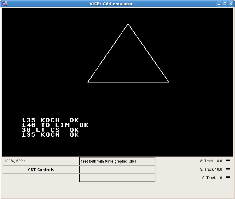

The last time I wrote anything with trees was not in Forth or the 65XX family of processors so here are examples of recursion with turtle graphics. The first draws a C curve similar to a Levy C curve but this one skips every other step.
30 VALUE LIM
: CCURVE  ( SIZE -- )
   DUP LIM < IF  FD EXIT  THEN
   90 LT DUP 2/ RECURSE
   90 RT DUP 2/ RECURSE  DUP 2/ RECURSE
   90 RT 2/ RECURSE
   90 LT ;
This version stops the recursion when the line length is less than the value of LIM .
Setting LIM to 5 and executing CCURVE with 64 on the stack produces the following image:

This draws the Koch snowflake:
: KOCH/3
   DUP 3 / RECURSE
   60 LT DUP 3 / RECURSE
   120 RT DUP 3 / RECURSE
   60 LT 3 / RECURSE ;
: KOCH 30 RT
   3 0
   DO
      DUP KOCH/3 120 RT
   LOOP
   DROP 30 LT ;
This example could ( and maybe should) be rewritten to limit recursion by depth. Here are a series of images based on depth of recursion:
Notice the brevity of the code versus the complexity of the images. With a higher video resolution, these words could achieve even more complexity of the image just by setting the recursion depth deeper ( with a larger starting size). With the second version of CCURVE and a system that had much higher video resolution, just think what 1024 8 CCURVE would look like.
