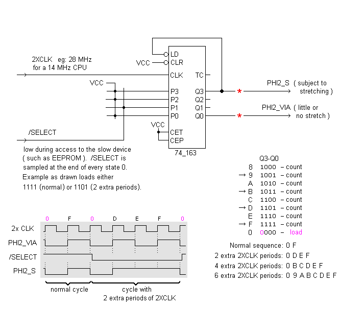

Shown below is a clock-stretch circuit built around the wondrous and ever entertaining 74xx163 4-bit synchronous counter! :) This chip even lets us include a non-stretched output, courteously allowing your VIA timers to remain punctual!
Note: with this circuit, as with the JK circuits, it's imperative that /SELECT becomes valid somewhat before the rise of Phi2. :!: This might turn out to be the limiting factor for maximum clock speed, given the prop delays from the address decoder that typically drives /SELECT. A faster decoder will help, but a more powerful solution is to choose one of my overclockers' solutions later in the thread. These -- like RDY -- don't require /SELECT to become valid so early; it's sufficient that /SELECT is valid somewhat before the fall of Phi2.
Some notes re: the '163 circuit:
PHI2_S is the stretchable clock, and it's what generally serves as Phi2 for your system. PHI2_VIA would only be used to drive the Phi2 pin on your 6522 VIA's.
The red asterisks pertain to debugging strategy. To bypass the circuit, sever the connections where indicated; then temporarily connect PHI2_S and VIA2_VIA together and drive them from an oscillator which is slow enough that clock stretching isn't required. If you're doing a PCB you may want to provide jumpers, or exposed traces you can easily cut, as a means to sever the connections. Or, if the '163 is in a socket, you can simply remove it!
2XCLK runs at twice the nominal CPU frequency, and its duty cycle isn't especially critical. Every rising edge of 2XCLK causes the '163 to either count or load, with the loads occurring at the end of every state 0.
If /SELECT is inactive (ie; high), the value loaded will be $F, and if /SELECT is low the value loaded will be determined by how you've connected the counter's P3-P0 inputs:
  • Loading $D, $B or $9 will result in extra time equivalent to 1, 2 or 3 normal CPU cycles, respectively. PHI2_VIA will continue, unaffected.
  • Loading $E, $C, $A or $8 will result in extra time equivalent to .5, 1.5, 2.5, or 3.5 normal CPU cycles, respectively. :!: These fractional-cycle delays *do* minimally impact VIA timing. In all cases the VIA is slowed by 0.5 cycle.

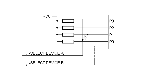

If you have multiple slow devices, some slower than others, you might wanna customize each device's delay value. For certain combinations of values this won't even require any additional components. To allow any combination of values you could hook up a diode matrix or something similar.

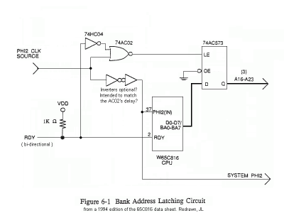

footnote: In 2015, forum member cr1901 resolved a distressing ambiguity in the '816 data sheet by testing an actual '816 and reporting, "The 65816 does NOT drive the bank address while RDY is low." In other words, the alternating pattern of Bank-Address, Data that normally occupies the 816's data bus during the Phi2-low, Phi2-high periods of every cycle is temporarily suspended. Because no Bank Address is present, it's necessary to also suspend the enable signal sent to the Bank Address latch; otherwise it would latch bits that are intended as data.
Much later, BDD unearthed an 1994 WDC datasheet that suggests appropriate logic to deal with the matter (first image, below). Compared with a more modern suggestion that doesn't involve RDY (second image), the 1994 circuit drives LE with a NOR rather than an inverter. Also there are two inverters which arguably improve matters by counterbalancing the delay of the NOR.
File comment: Using RDY.

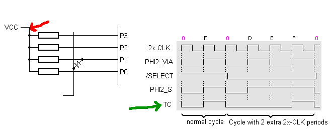

The '163 really is a Swiss Army knife! It occurs to me that the signal marked in red (below) could be renamed /HALT -- because if you pull it low the counter will complete whatever sequence is in progress, then endlessly load 0000 and the CPU will stop indefinitely.
Also, I redrew the timing diagram to show an additional signal (marked in green). That stretched (but narrow duty cycle) waveform on the TC output seems like it would surely be useful for something... but I haven't yet figured out what! :lol:

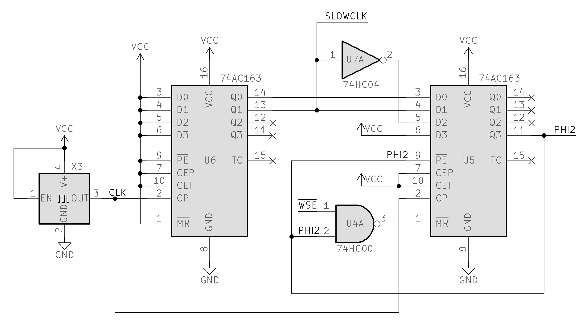

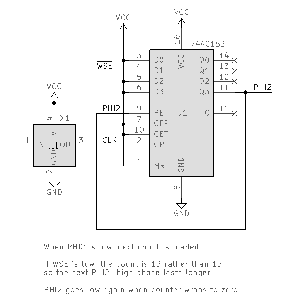

PostPosted: Thu Oct 26, 2023 12:27 pm
Posts: 741
I wanted to discuss these ideas more, and especially BigEd's thought about supporting synchronization with a slow clock, as that's pretty important in some of my circuits.
BDD's POC v1.3 and v1.4 used the following circuit which is I think Jeff's second one posted above:
File comment: Clock stretching circuit from BDD's POC v1.4
This works well but requires knowing whether or not the current cycle should be stretched within one tick of PHI2 falling, which puts a constraint on overall clock speed, given glue logic delays as the 65C816 appears to be slow at presenting the bank address which is typically used as part of the decision over whether or not to stretch the cycle.
I thought maybe the following modification might resolve that:
File comment: Possible change to allow later stretching decision
So we always assume the cycle will be stretched, but cut it short if it turns out it's not meant to be stretched. However in order to not stretch the low phase of the clock during fast cycles, we need to constrain the stretching to the high phase, which as noted in this thread may mean slow devices don't have enough address setup time, and cause other complications.
It got me thinking though about whether we can support a consistent slow clock as BigEd said above, to allow the CPU to run faster than some I/O devices that themselves require such a clock. I don't have a neat solution for that yet but have been thinking along the following lines:
File comment: Possible way to provide a slow but synchronous I/O clock
The general mechanism is the same as in my previous circuit, but the value loaded into the '163 U5 is such that PHI2 will fall one CLK cycle after SLOWCLK. In addition, if SLOWCLK is high at the time PHI2 goes high, PHI2 waits an additional SLOWCLK cycle, ensuring that there's a full high half-cycle of SLOWCLK. Unfortunately all of this means that SLOWCLK can only be half of the speed of PHI2 anyway, as the counters otherwise don't have enough bits.
Here's an illustration of how PHI2 would respond to clock stretching, showing the four possible values that could get loaded into the counter and how they correspond with the phases of the slow clock and U6 counter:
File comment: Various possible PHI2 responses
There are a lot of missing pieces and rough edges, for example SLOWCLK needs to be delayed by one CLK cycle, to match PHI2 (or PHI2 needs to end a cycle earlier); chip selects and write-enable signals need to be gated to the second high phase of SLOWCLK in cases where SLOWCLK was high initially; and there's no guarantee of a full low half-cycle of SLOWCLK with chip selects and valid address signals active, so some devices might be unhappy. For my own system I also really need this slow clock to be a lot slower - maybe 4x or 8x slower than PHI2 - so would need more counter bits.
So overall I think this slow clock idea shows some promise, and some of these issues can be easily resolved with a few flipflops, but it's not quite there yet.
PostPosted: Thu Oct 26, 2023 4:37 pm
Yikes! Lots to talk about here. :)
Firstly, one hopefully simple point to dispatch, George. Published timing specs suggest the Bank Address bits become valid at the same time as address lines A15-A0, so can you elaborate please regarding your remark about the 65C816 appearing to be slow at presenting the bank address? Perhaps you simply mean there'll be some non-trivial added delay if a '573 or similar latch is used. (And I'll note in passing that the latch delay can be reduced to the sub-nanosecond level by using the FET Bus Switch approach -- more on the FET switch approach in When is a Latch not a Latch? (Capturing the '816 Bank Addr).
gfoot wrote:
knowing whether or not the current cycle should be stretched within one tick of PHI2 falling [...] puts a constraint on overall clock speed, given glue logic delays
Yes, it would definitely be better if the clock-stretch request were allowed to arrive fairly late! And on my back burner I have a project that's been successful in satisfying this. :!:
Unlike my '163 circuit, which requires the clock-stretch request to become valid shortly before Phi2 rises, the circuit below merely requires the clock-stretch request to become valid shortly before Phi2 falls, making the circuit easier to work with... especially when over-clocking the CPU! :twisted:

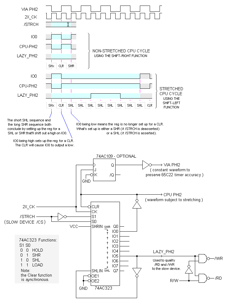

It's a little odd how I've used the shift register. So, referring to the diagram below, allow me to point out that the cycle completes when a "1" arrives at IO0. Before this occurs, the shift reg dictates either a short or a long time delay -- either one or eight of the 2X clock periods -- according to which direction it's shifting... and the direction depends on /STRCH, the circuit's stretch-request input. BTW, note that the shift-reg always gets cleared at the time Phi2 rises; in fact, that's what causes Phi2 to rise.

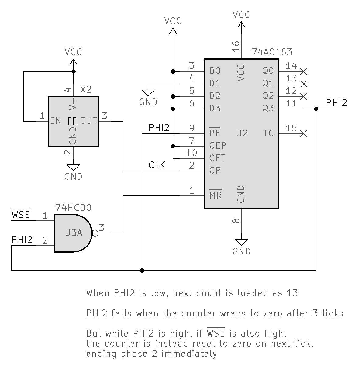

It may be because I'm up earlier than normal (for me) and haven't ingested enough coffee, but I'm not seeing a gain here. Even though the HC00 is being gated by Ø2, the 163's /CLR (labeled in your drawing as /MR) timing is relative to the oscillator's signal, which means the HC00 really needs to settle in no more that TSU nanoseconds before the oscillator goes high. So, it seems to me the same timing limitation exists, just at a differing input.
In any case, the HC00 likely needs to be faster logic to avoid having it introduce too much lag in responding to /WSE, which in my POC V1.3 unit, doesn't resolve until late during Ø2 low.
Incidentally, POC V1.3 doesn't use the 163. It, instead, has a AC74 and AC109 clock generator. V1.4 does have the 163. Since V1.4 doesn't perform as well as V1.3, I may look at bodging the former to try out your idea. The one impediment is V1.4 is entirely SMT (excepting one item), which is not something I can readily work with anymore.

The /MR signal is intended to take effect only at the end of the (unstretched) PHI2-high phase - not at the start of it - so the idea is that there should be an extra clock cycle (half a PHI2 cycle) of time for the bank/address decoding and NAND logic to take place.
Yes I didn't deliberately pick the HC part, that's just what KiCad gave me - you can use something faster - but equally it's probably not as important given the extra cycle of time that's available.
Incidentally, POC V1.3 doesn't use the 163. It, instead, has a AC74 and AC109 clock generator. V1.4 does have the 163. Since V1.4 doesn't perform as well as V1.3, I may look at bodging the former to try out your idea. The one impediment is V1.4 is entirely SMT (excepting one item), which is not something I can readily work with anymore.[/color]
Ah I misunderstood which you'd used this in, sorry. It'd be interesting to hear if it works - but might be too awkward to bodge. Maybe you could feed PHI2 into the GAL and so make /WSE be gated by PHI2 right from there, but the connection at the 163 will still need cut traces and bodge wires.

gfoot wrote:
Regarding the 65C816’s bank address delay, I think I misunderstood the extent of the problem - I thought BDD had observed 30ns delays from the falling edge of PHI2, but looking at the logic analyser captures he posted, it looks like the bank address is there after about 10ns, which is not so bad - still, given the need to then decode that and decide whether to stretch or not, it is still a... stretch!  But perhaps no worse than for the 65C02 with the address bus, it seems they have similar delays from the falling edge of PHI2.
I’ve tried out several 65C816s in POC V1.3, including one with a Sanyo 0.8µ core, and the elapsed time from the fall of Ø2 to the stabilization of the bank bits seems to be remarkably consistent, right around 12ns, as reported by the logic analyzer (LA).  In a capture I did at 12.5 MHz of a RAM read (which would not be wait-stated), VDA was asserted at 10ns and A16 appeared on D0 at 12ns.  A0-A15 had already appeared at the rise of VDA, although it’s likely there is a small lag there as well.  It would appear that 2ns lag from VDA high to A16 on D0 is also very consistent.
Before continuing, I should note that my logic analyzer has a maximum sample rate of 500 million/second, which equates to an effective resolution of 2ns.  This sample limit occasionally produces some anomalies in the captures, such as a symmetric 20 MHz clock appearing to be asymmetric, since the 25ns half-cycle time has to be resolved to an even number of time units for display purposes.
V1.3’s glue logic can’t make any wait-state decisions until A16 is present, since the decoding rules prevent ROM and I/O hardware, both which are wait-stated, from appearing in the extended banks.  It’s a race between the gates that generate chip selects based on address bus state and the tPLH/tPHL timing of the bank latch.  tPLH/tPHL ranges from 2ns to 11ns, so the likely worst-case will result in /WSE being asserted 21ns after the fall of Ø2.
Since a half-cycle at 20 MHz is 25ns, that only leaves 4ns for whatever is watching /WSE to react.  The 74AC109 I used in V1.3 as the wait-state timer can’t meet that requirement, which is why clock-stretching in that machine goes south somewhere above 16 MHz.  The 163 used in V1.4 to generate the Ø2 clock likewise can’t react that quickly, and has the double whammy of having its input timings being relative to the oscillator, which of course, is running at Ø2 × 2—V1.4 barely manages 15 MHz.  The 109, on the other hand, only has to keep up with Ø2.
The problem, as I understand it, devolves to a matter of how to widen that 4ns window.  So far, it seems intractable with discrete logic.  I may be wrong on this—I’m eagerly awaiting Jeff to jump in with a rebuttal and a circuit example :D, but I have studied this at length and have yet to solve the problem.
A likely path to widening the 4ns window is to eliminate the timing flop as a discrete part and synthesize it in a CPLD that also provides the rest of the decoding glue logic.  It would produce the /WSE signal to control clock stretching.  A 7ns CPLD should be able to increase the timing window to at least 8ns, worst-case, assuming the use of buried logic and no pin nodes (not to be confused with the PINNODE statement in CUPL, which when used with a CPLD, doesn’t involve actual pins).
