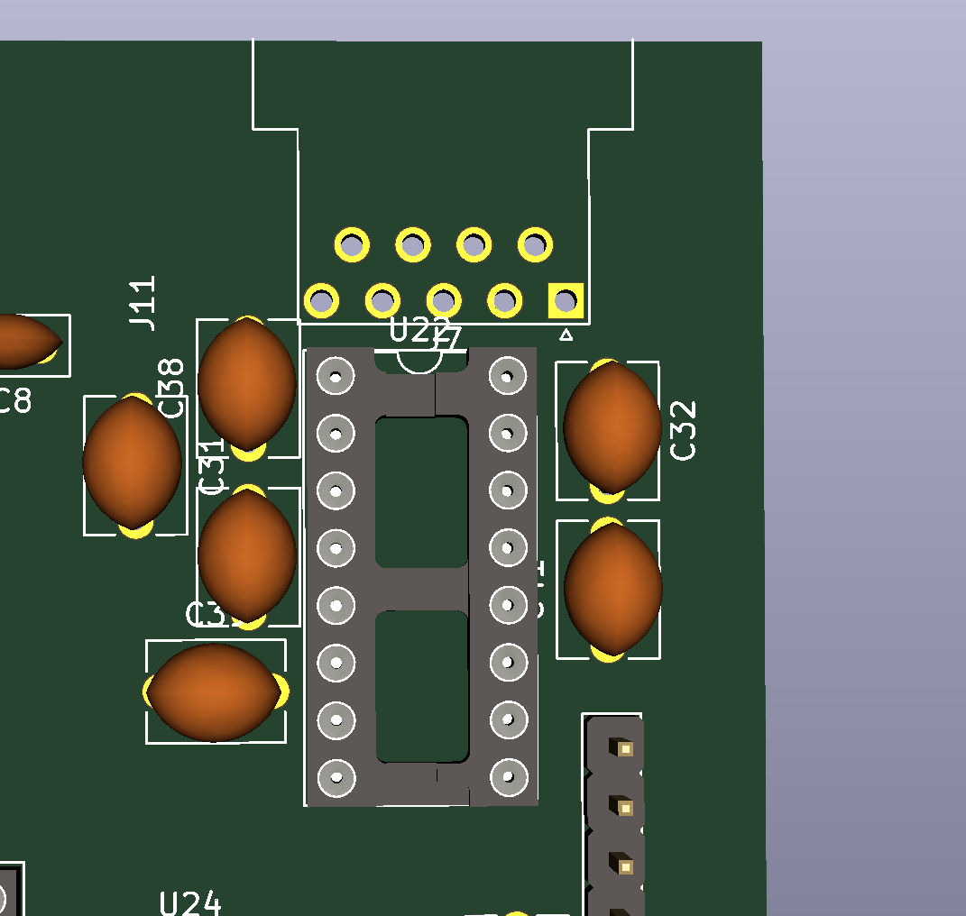

In other news, I sourced new 1uf caps that are non polarized, but I'm probably going to switch back, because the footprints are actually larger:

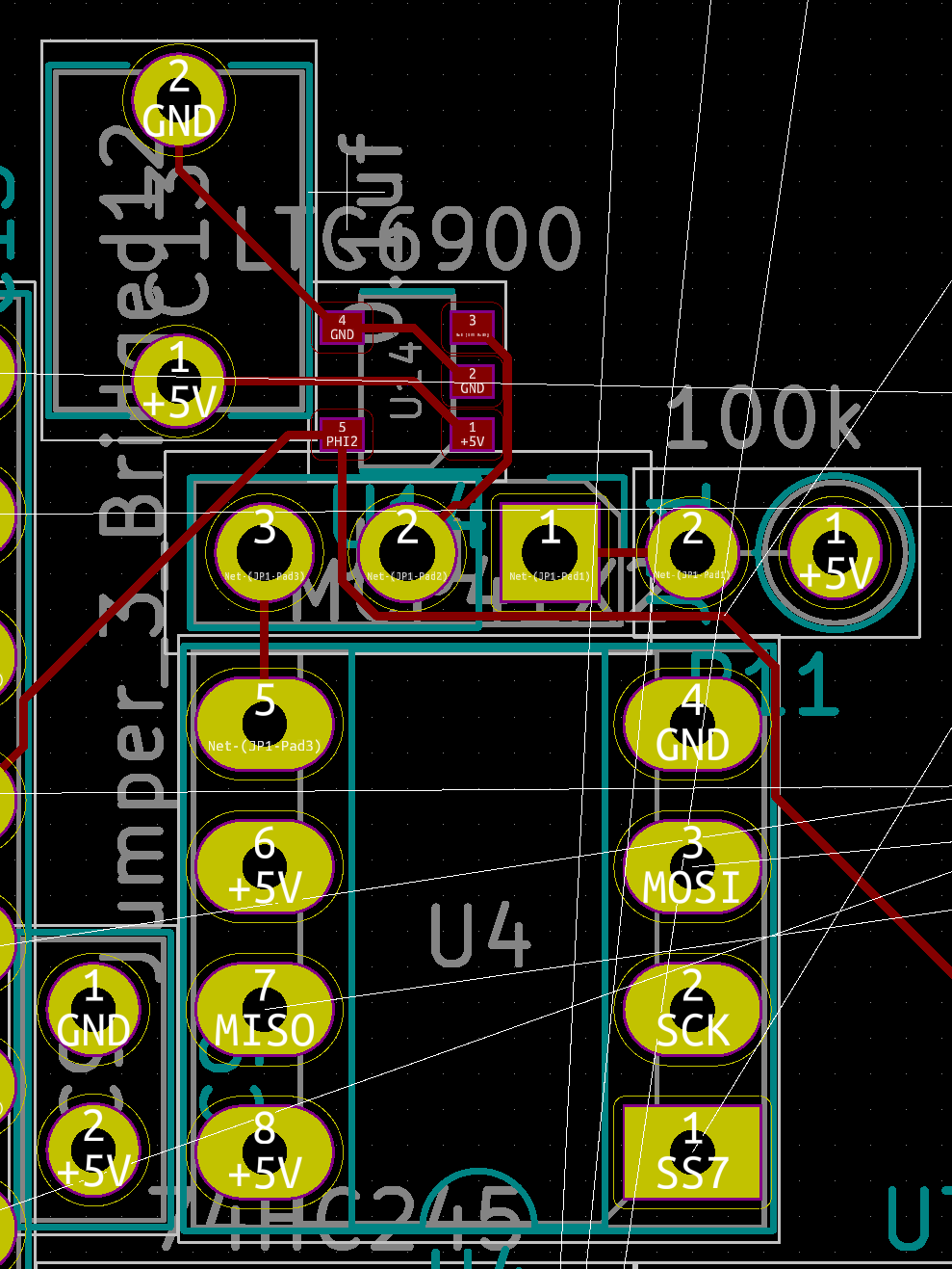

In other news, I think I've got my clock generation circuit all laid out, I realized I had the wrong footprint assigned to the rheostat, which ended up saving me a bunch of space, here it is:

The SOT pads still look a bit small. I would make them twice as long. You have plenty of room.
Don't make them wider, because you want to keep as much gap as possible, just sticking out further.
Also, if you're looking for solder wire, get some thin stuff. That makes it much easier to control how much you feed in.
In case you want to see better, forget the desk magnifier lamps. Instead, get a cheap pair of reading glasses with highest strength you can find (usually +3 or +3.5)

I just used the footprint that was in the libraries for kicad, I'll see about lengthening the pads to help with soldering

Posts: 589
If that's an RS232 level shifter IC then please note that the MAX202, ST202, or MAX232A transceivers are the same as a MAX232 transceiver but they can use 0.1-uf monolithic ceramic caps... You could install them under the IC in the open area of the machined pin IC socket...
