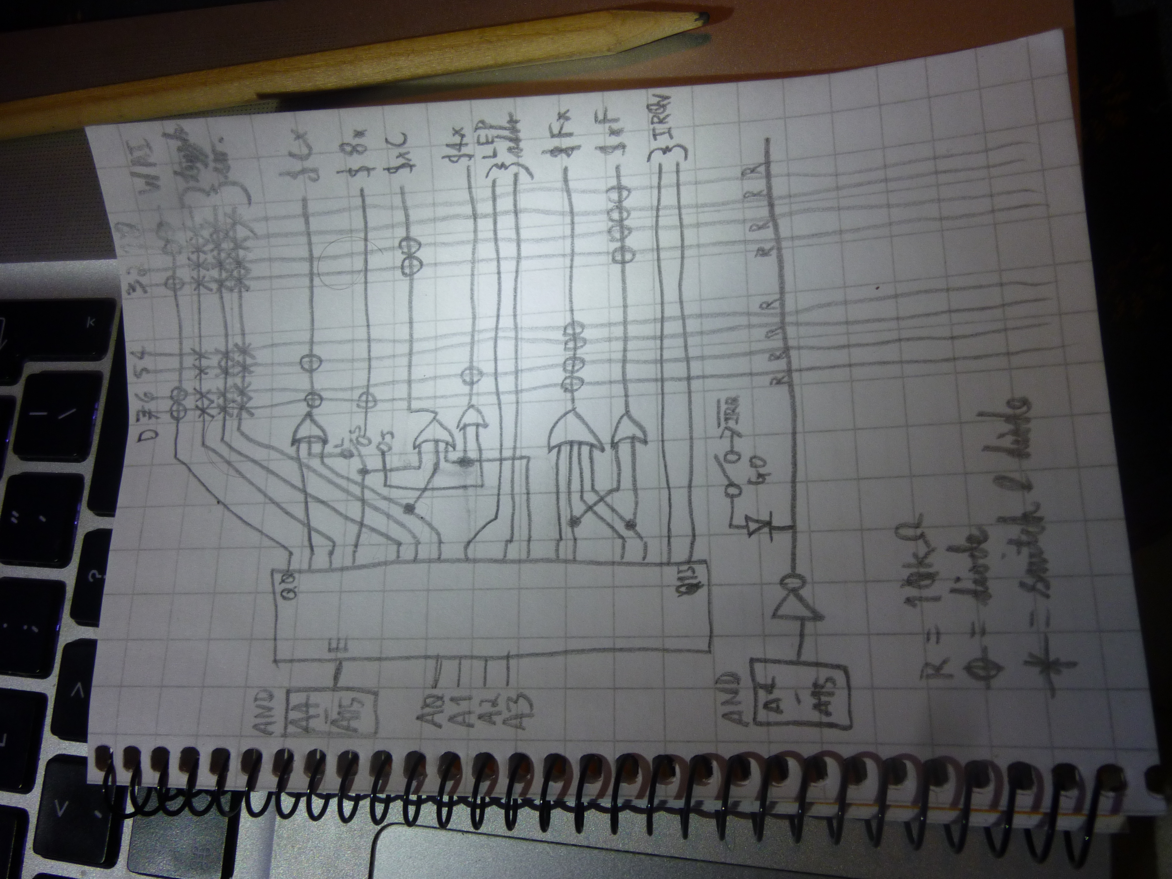

PostPosted: Sat Feb 09, 2019 2:00 pm
If the goal is to build a minimal bootstrap ROM right at the top of the address space, then we must incorporate the three vectors - and we can do this within 16 bytes, so we only need a $FFFx mask and a 4-to-16 decoder to drive out diode ROM. NMI is the first vector encountered in program order, so we can include it in a JMP to replace the BRA, and the WAI then falls exactly at $FFF0:
.ORG $FFF0
    WAI
    LDY #$xx ; data toggle switches on $FFF2
    STY/JMP/LDY $xxxx ; three-way opcode selection between $8C/$4C/$AC on $FFF3, address toggle switches on $FFF4-5
    STY LEDs
    JMP $FFF0 ; incorporates NMI vector
    .WORD $FFF0 ; reset vector
    .WORD $???? ; IRQ vector
That's exactly 16 bytes. Then, looking at the actual bytes involved:
$CB
$A0
xx ; data toggles
$8C/4C/AC
xx ; address low toggles
xx ; address high toggles
$AC
xx ; LED low address
xx ; LED high address
$4C
$F0
$FF
$F0
$FF
xx ; IRQ low address
xx ; IRQ high address
There's a lot of bit patterns that can probably find diodes reused through OR gates from the decoder. For example:
