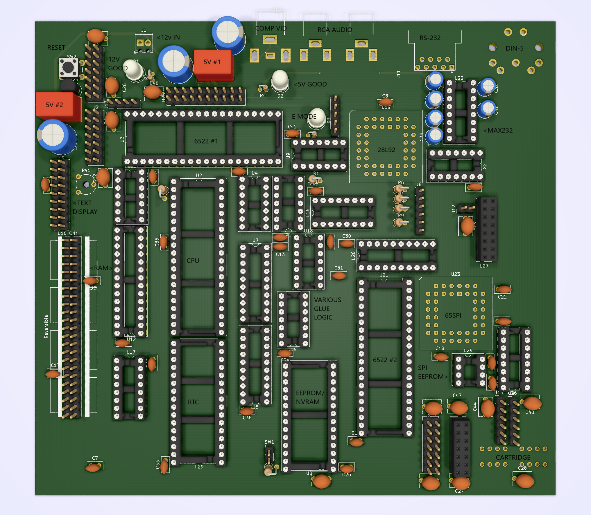

PostPosted: Mon Feb 04, 2019 7:40 am
Posts: 346
Location: Knoxville, TN
So, the NVRAM and EEPROM are the same package (dip 32 I believe) so I don't have to make a decision now. However, I will need to add the chips for wait states if I go with eeprom.
With that said, I've got my first layout done, I've annotated it so you can see what everything is, thoughts?
EDIT: I'm also looking for ideas on board size reduction, getting this made through OSHPark would be very expensive (although I know and trust them, I may look elsewhere if I have to have it made, which is very likely at this point)
EDIT 2: also, there's 2 (that I've spotted so far) extra bypass caps, I was able to remove some chips but those caps haven't been deleted yet

PostPosted: Mon Feb 04, 2019 7:42 am
Posts: 483
Location: Australia
There is also Ferroelectric RAM. It looks like it should be able to be written to mostly like an SRAM, but it's non-volatile. It might or might not be any faster than the EEPROM on writes. It should be faster on reads, but don't quote me on that.
You can get a 5V parallel one from Mouser, but it isn't cheap, and it only seems to come in surface-mount.
PostPosted: Mon Feb 04, 2019 7:47 am
Posts: 346
If I could get it in through hole that might be cool, I'll look at it regardless though
PostPosted: Mon Feb 04, 2019 7:48 am
Instead of electrolytics, you can use ceramic caps for the MAX232. They're a bit smaller and you can't put them in the wrong way.
PostPosted: Mon Feb 04, 2019 7:49 am
Posts: 346
Alright, the docs for 28L92 integration had it with polarized caps, so I assumed electrolytics, I can swap them out though, that's not too hard.
