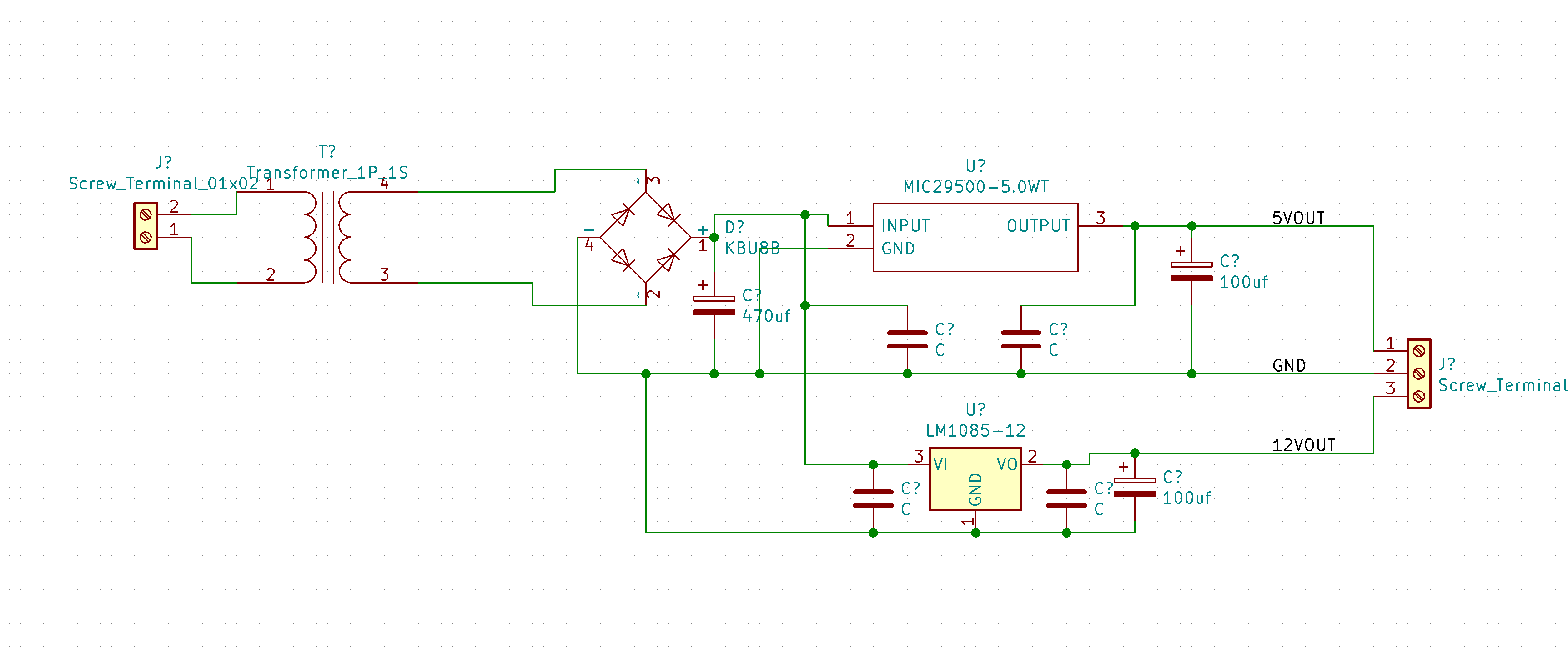

So I've decided on making my own PSU for this project, because I'd like to have 2 rails (12v and 5v) since some of the displays and other peripherals I was looking at take positive 12v. (also, I'd like to have a power supply that could support a computer that uses the 65SIB in the future). I understand basic power supply design, but I'd like to see if there's anything wrong with the attached schematic. Especially the capacitor values (I'm not sure it's enough capacitance to stabilize the rails at full load, which is 5v 5a and 12v 3a).
For reference, I need to find a transformer that converts down to 16vac on the output side and is capable of handling 80va (still looking around for one but those are the specs I'm running with)
EDIT:
After talking with Garth, I've been thinking about going about this a different way, with a commercial power supply (that can fit within the form factor I need) and supply at least +12 and -12 voltages (since SIB needs -12 too, and I need -12 for a lot of LCDs) and then regulating 5v on the logic board. Any input on this approach is welcome.
