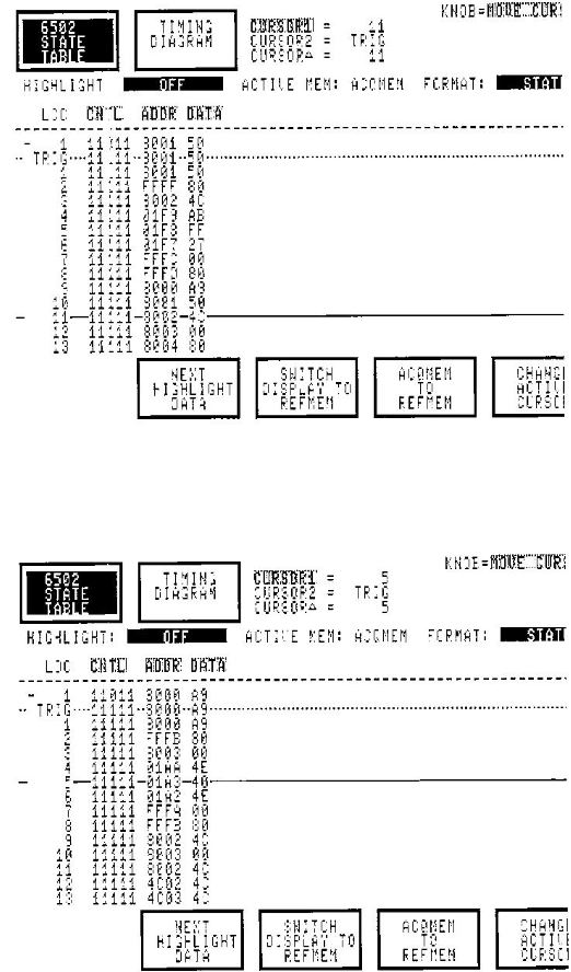

I finally got another set of probes for my logic analyzer. I was going to test them out on one of my boards but when I read the data nothing seemed right. I messed around for about 2 hours before I started the question the working state of the computer. Anyway, when I swapped out the 65C02 it seemed to work? I'm just running a loop. The analyzer triggers after the reset.
*$8000
8000 LDA #50
8002 JMP $8000
END
Very simple, when I use the suspicious processor it first looks at $FFFA then $FFFB (I have $8000 written in) then it jumps to $8002 and after that I'm not sure what it's thinking.
I attached a very crude capture of the screen. (it's not great) The top capture one is the working processor.
What's happening? Did I blow it, I'm usually cautious of static discharge? Side question; does anyone else have a Tektronix 1240 or 1241? I'm having problems using the disassembly cartridge. It's a bit disappointing, these cost 7$ a piece and with my salary I count every penny!

Looks to me as though A1 is stuck high on the "bad" CPU. The first few cycles show it low, but once it goes high, it stays there. That could indicate the low-side pin driver is blown.
What a shame :( I'll have to be more careful bout static discharge probably. These are so fragile.

I also think A2 is stuck low. See how the $FFFF near the top turns into $FFFB, and the Reset vector pull is from the wrong pair of addresses for A1 to be the only faulty line.
So another plausible root-cause is due to shorting A1 and A2 together while one was driving high and the other low.
Maybe when I was hooking it up the LA (over 29 input lines are needed for disassembly). The data/address pins are all connected to a single header.

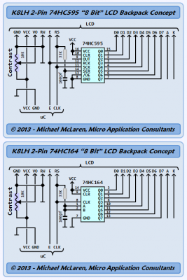

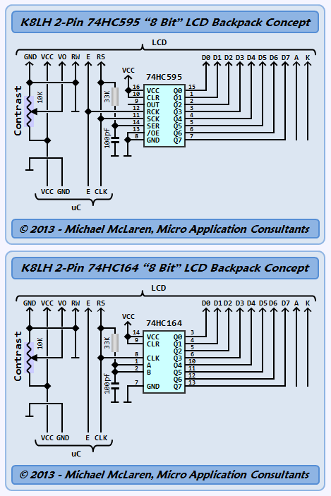

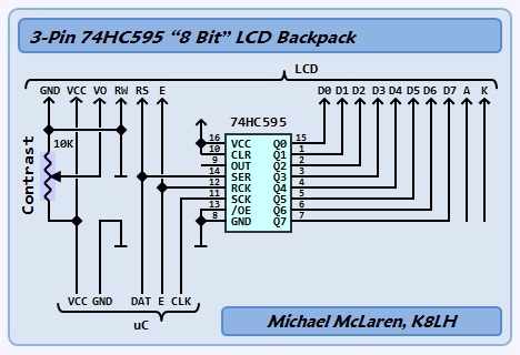

 Post subject: Re: Advice needed on SBC
PostPosted: Fri Feb 08, 2019 12:44 am
Posts: 589
Floopy wrote:
... I'm currently running the LCD with an 8 bit data bus and 3 extra lines for the control pins. If I could reduce it down to just 4 bit (send two 4 bit instructions instead of one 8 bit) then I could use the extra I/O on the VIA for exterior control.
Have you considered using an LCD "Backpack"? The PCF8574 based I2C backpacks work well, too.
