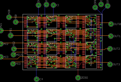

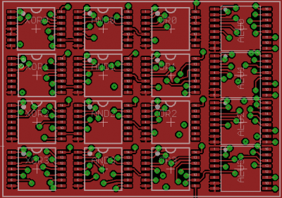

Here is the ALU nibble completely routed (still needs to be cleaned up a bit). The surrounding white box is 32x24 mm. A full ALU should be twice that, so 32x48 mm, which is about 10% of a Eurocard. The green circles are test points. They just serve as place holders for all external connections (input, output and control signals). Inputs are all on the left, outputs on the right, and controls run vertically. The bottom two signals (partial Carry and Zero flag) should propagate to upper nibble.
I think I'll start working on the PC and AB logic next, to get a better idea of how that's going to look. The PC will also get a ripple carry, but only has 1 gate delay per bit, instead of 2. Of course, it will be twice as long, so total delay should be similar, but slightly less than ALU. The rest of the design won't have any more adders or incrementers. A lot of muxes and registers, and some random logic. I'm trying to fit all the logic in half the Eurocard size, and reserve the other half for the PLA. No idea if that's enough, but we'll see it when we get there.
My plan is to draw schematic and do layout for each subsection, keeping them well separated, and then experiment with different placements on the board. If you keep them apart, it's easy to draw a box around a section, and move it around, without dragging all the connections as well.
Had to rearrange the mux inputs a little bit to make routing easier, so I also updated schematic.

Re: Yet another TTL 6502
Looks great. Lots to learn here from the approach you’re taking. Looks like traces on three layers?

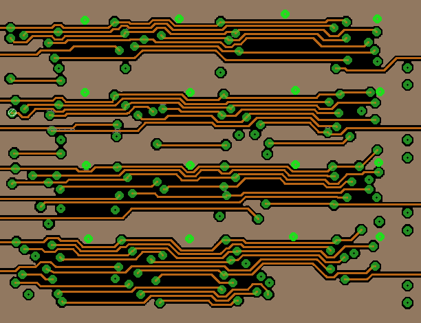

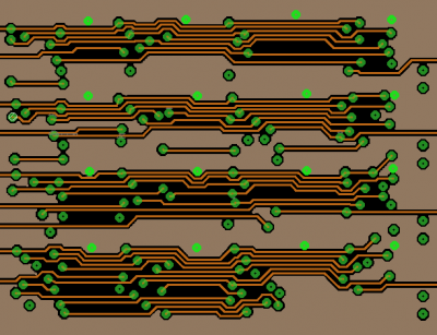

Yes, red is top, blue is bottom, and orange is one of the middle layers (power). There's a 4th layer for ground that I try to keep empty.
There are ground pours on top/bottom, but they've been switched off for clarity. I've added screenshot of the individual layers. On the orange one I've highlighted the VDD signal, so you can see it reaches the vias that it needs for powering the ICs with reasonably fat traces. I'll put a bypass cap near each of the vias.
Also, at the last stage, I add a bunch of ground vias to stitch all the ground pours together. Couple of other things I'm trying to do: keep like signals together and avoid empty parts (still need to improve that here). This improves plating reliability. And try to avoid cutting ground plane in distinct regions.
See for example the top layer bottom right. There are two vias close together, interrupting the flow of the ground plane. I don't like that, so I'll go fix things like that.
Fixed the interrupted ground by moving via a bit
- Attachments
- break.png (5.95 KiB) Viewed 1287 times
- fix.png (6.31 KiB) Viewed 1288 times
