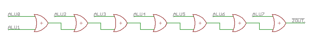

This is how I'm going to do the Z flag generation. Using one of the left over OR gates per bit slice.
You may wonder about the propagation delay, but that's no concern because of the ripple carry adder, the ALU outputs will arrive in order, so the OR from 0 through 6 will be waiting at the last input before the ALU7 output arrives.
