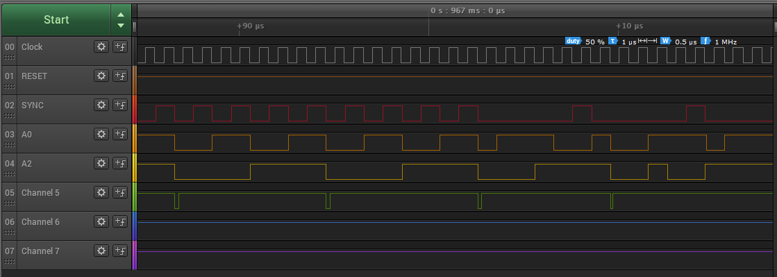

Hello guys,
I think you'll like this new mistake. I got the 6502 and put it on a separate breadboard to try to eliminate the problem. The behavior was the same as the previous post. He goes very well to some extent that, I can not explain, he loses everything.
But look how curious: channel 5 of the logic analyzer was showing a signal. Being that this wire is not connected to any place. What can be happening? Problem in the GND of the logic analyzer? Or in the logic analyzer itself?
I'm using a (generic) Saleae's logic analyzer. The software is Saleae Logic version 1.2.18.
The setup is:
24 m/s Sample Rate
The GND pin is on the ground of my breadboard.
The CLK pin is disconnected.
Unfortunately I can not afford to buy an oscilloscope with the logic analyzer module.
A wire that is not connected to anything is liable to "float" high or low all by itself, or even pick up nearby AC signals. This is the same problem you can get with high impedance input pins on an IC. That's why unused input pins (example: /SO) need to be tied high or low, or to have a pullup resistor at least. The effect is normal.
Floobydust does make a good point about using low-quality equipment. But in this case I see no reason to wonder about the Logic Analyzer. I'm more worried about the solderless breadboard. SOMETHING seems to causing the behavior to change, and bad connections are a very likely cause of that. Since most of the connections are established by the breadboard... :|

Which is why it would be valuable to be able to try running at lower speeds - *much* lower, down to DC if necessary - but the NMOS CPU won't permit that (I think 100kHz is the lowest guaranteed speed).
Another thing a (cheap) logic analyzer won't tell you is whether analogue effects are making it hard for the CPU to interpret signals. Voltage levels and the shape of the waveform matter, as does "ground bounce" which can be a serious problem on even good-quality breadboards.
