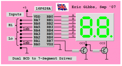

If it would be of help... I wrote a few different versions of code for a chap who was using the circuit below. I believe he used a '373/'573 latch driving the inputs.

;  // PIC psuedo C code program example
;  char segdata [] = { 0b00111111,      // "0"   -|-|F|E|D|C|B|A
;                      0b00000110,      // "1"   -|-|-|-|-|C|B|-
;                      0b01011011,      // "2"   -|G|-|E|D|-|B|A
;                      0b01001111,      // "3"   -|G|-|-|D|C|B|A
;                      0b01100110,      // "4"   -|G|F|-|-|C|B|-
;                      0b01101101,      // "5"   -|G|F|-|D|C|-|A
;                      0b01111101,      // "6"   -|G|F|E|D|C|-|A
;                      0b00000111,      // "7"   -|-|-|-|-|C|B|A
;                      0b01111111,      // "8"   -|G|F|E|D|C|B|A
;                      0b01101111,      // "9"   -|G|F|-|D|C|B|A
;                      0b01110111,      // "A"   -|G|F|E|-|C|B|A
;                      0b01111100,      // "b"   -|G|F|E|D|C|-|-
;                      0b00111001,      // "C"   -|-|F|E|D|-|-|A
;                      0b01011110,      // "d"   -|G|-|E|D|C|B|-
;                      0b01111001,      // "E"   -|G|F|E|D|-|-|A
;                      0b01110001 };    // "F"   -|G|F|E|-|-|-|A
;  void Main()
;  { static unsigned char digsel = 0;   // digit select, 0 or 128
;    cmcon = 7;                         // turn comparator off
;    trisa = 255;                       // Port A all inputs
;    trisb = 0;                         // Port B all outputs
;    while(1)                           // loop forever
;    { unsigned char work = porta;      // sample inputs
;      if(digsel)                       // if left (hi) digit
;        work /= 16;                    // use hi nibble, 0..F
;      else                             // otherwise
;        work &= 15;                    // use lo nibble, 0..F
;      work = segdata[work];            // get segment data
;      work |= digsel;                  // pick up digit select bit
;      portb = work;                    // update display
;      DelayMS(8);                      // ~60 Hz refresh rate
;      digsel ^= 128;                   // toggle digit select bit

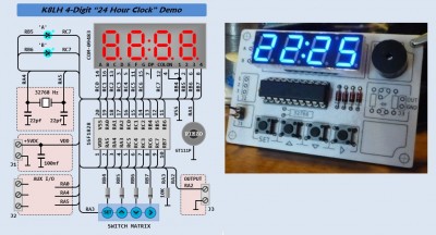

Some time ago I also experimented with eliminating segment current limiting resistors. That is, I drove one segment at a time (1/32nd duty cycle) while relying on the ~100-ohm Rds(on) resistance of the I/O pin MOSFET drivers for current limiting.
This scheme worked quite well driving modern hi-intensity LED displays (I was using Vcc = 5v).
It would be relatively easy to design a microcontroller based solution that could drive a 7-segment display, an HD44780 LCD, and an OLED display at the same time. Simply connect your display of choice.
I would be happy to help with PIC code and please note that it would be relatively simple to wrap the PIC firmware in an Arduino sketch and use a $2 Arduino Nano or $3 Arduino Uno and a solderless breadboard to program the PIC microcontroller via LVP (Low Voltage Programming).
Not sure why the original poster dis'ed my suggestion (he never elaborated) and I apologize if my suggestions are not in context for this thread...

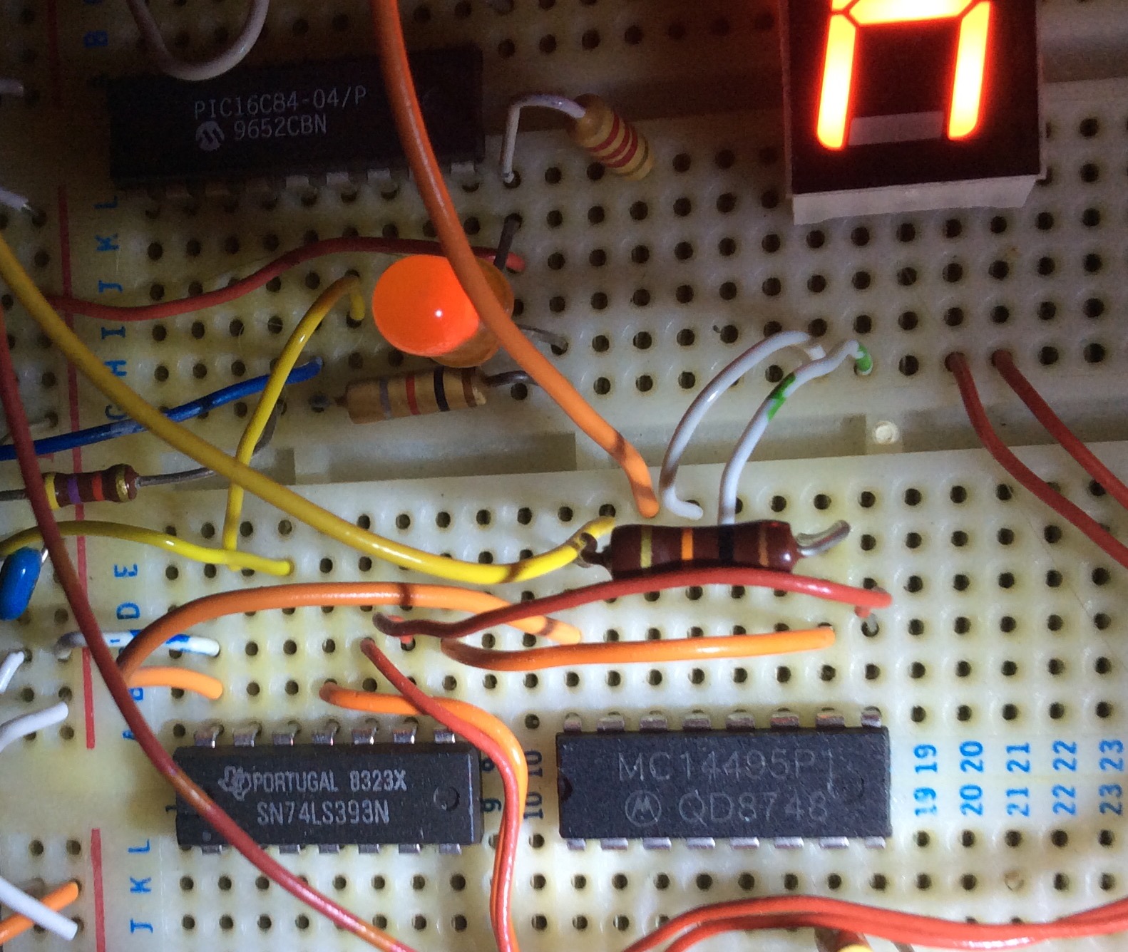

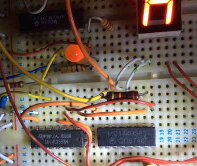

A PIC16C84-04/P microcontroller supplying counting pulses to a SN74LS393 counter, which in turn is supplying binary data to a MC14495P display driver. This then is driving a red seven segment display. The whole lot is being powered from two AA cells, the current battery voltage is 2.93V as shown on the cheap multimeter ;-)
The MC14495P and the common cathode red seven segment display were obtained from China via eBay.
File comment: PIC16C84-04/P
File comment: SN74LS393 and MC14495P
Video here https://youtu.be/bU-ObHCvj34
