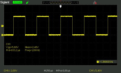

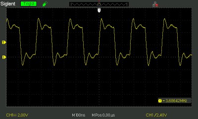

More fun as I continue to cobble together the prototype of my next SBC :)
So I've got a 28L92 UART wired in now, pretty much following BigDumbDinosaur's guide and using his init code, but I'm having some problems. Initially I was just trying to blast out a stream of 'J' at 115.2k bps, and although I could see the bits clocking out on the Tx line my PC (using a USB<->TTL serial dongle) wasn't showing squat except maybe the occasional garbage character. On rare occasions I would see a small burst of Js and then nothing. Nothing I could do would make it happen on demand though.
After a LOT of fiddling I decided to drop down to 9600 bps, and at that point I got my Js....mostly. Interspersed with them were random garbage chars, almost exclusively $F0 or $FF bytes, and one or two $F5 bytes. They would pop up every few dozen bytes and were seemingly randomly distributed.
Next, I decided to eliminate the SBC's role almost entirely and changed the init code to put the UART into automatic echo mode. It seems to work fine at 9600 bps, but I did not push enough bytes through fast enough to trigger the glitches, I think. At 115.k bps I still get nothing, and in fact based on the lights on the serial dongle it looks like the UART isn't even receiving because the transmit light is not blinking at all.
After all this I finally decided to program the UART to output its transmit clock on one of the OPx pins, and that's when I noticed the issue...when set at 115.2k bps the transmit clock is actually closer to 120k bps. At 9600 bps it's almost spot-on but I suspect it's got some occasional glitching that is causing the garbage characters.
The input clock is 3.6864 MHz from a half-can crystal oscillator. The UARTs are ebay buys but both were still sealed in pick-and-place tape. Power is 5V from my bench power supply and the input power seems stable. Everything also has bypass caps, etc. I've swapped out both the oscillator and the UART itself to no avail
I'm attaching jpegs of the input clock and serial clock waveforms; I can print up some schematics too but they're largely unremarkable and I don't think this is a wiring issue.
Has anyone seen something like this before?

 Post subject: Re: 28L92 clock error
PostPosted: Tue Nov 20, 2018 6:49 pm
Seems to me you'd do well to get the 9600 sorted out (and forget 115k for the moment). I think you said the 9600 clock is spot on, and that simplifies the puzzle.

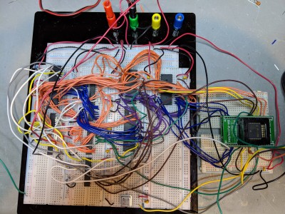

I'm attaching a snap of the project and the pdf of the schematic. Someone is going to scream at me now when they see that prototype construction... :) (I swear I started out with a beautiful planned layout to keep wires short!) And the PLCC44 to DIP44 adapter is too wide to fit on a single breadboard which is why it's way off to the side in such a hacky fashion. But aside from the serial clock being wrong it is initializing the UART correctly, and the board is running reliably at 1 MHz; I have code that is manually twiddling a VIA output pin to verify.
The only thing I can think of trying is to bump up to a 7.3728 MHz oscillator and run it through the other half of my 74AC74 to clean it up into a square wave, like I do for the CPU clock. Or I guess I can try that with the existing crystal and just run at 1/2 the baud rate for now.

Well it's a software issue, just not sure what yet...
If you look carefully at my scope pictures you'll see that's actually 1.2k bps (aka 1200 bps), not 120k bps. The UART baud rate generator is in normal mode, not extended mode II. It just happens that 9600 bps is the same CSR value in both modes, which is why it worked. But the setting for 115.2k in extended mode II is actually 1200 bps in normal mode. I finally caught this while playing around trying to get 19.2k bps and wondering why the transmit clock was 200 Hz.
:oops: Digging in to the code now...
