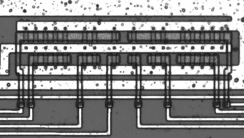

Just in case anyone finds this and has the same questions - I thought I'd add that the audio generation is in fact simply some resistors. Or at least, I'm assuming this is a resistor chain DAC each with 4-bits of precision. The video makes sense logically to me after the explanations here, but I have yet to really dig into the 2C02 or the VIC to learn how that works in finer detail on the actual chip.

File comment: NES Square Wave Channels (2 of them)
Triangle Waves (x1):
File comment: NES Triangle Waves (1 of them)
Attached you can find pictures of the resistor chains in the NES. I don't exactly understand the physics of this, but I imagine it's something like how a transistor avoids allowing current to pass until a certain voltage is applied to the gate. Perhaps in this case current may pass as noise or something (or none at all?), but applying a charge to the metal above the resistor allows far more current to pass through it from +5v (which is connected at the other side of the resistor).

Any thoughts or explanations to this? Is this making sense or am I misunderstanding something fundamental here?
Regardless, thought it'd be nice to follow-up with the DAC in the NES since originally I was incorrectly believing such a DAC wasn't possible. As I have continued to read, it seems the issue is once you get past so many bits it becomes hard to construct a DAC in this manner in ICs.

The usual pattern is to use transistors with the gate tied high - the metal is being used to supply that voltage and you can see the contact cuts in it next to each transistor. An on transistor will act like a resistor, more or less, with resistance controlled by the width and length but generally in the range of 10k ohms. By using various numbers of same-sized transistors, the composed resistance should match quite well to the desired 1x, 2x, 4x values.
