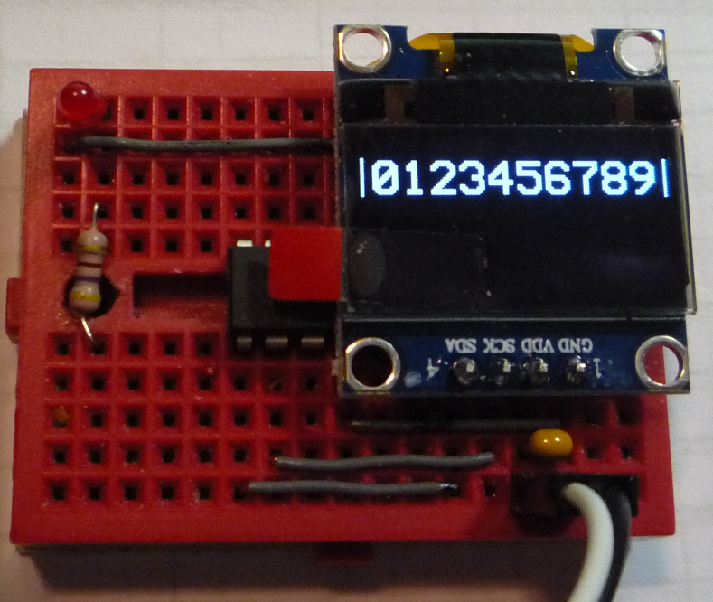

There are some nice little OLED displays (0.91" 128x32, 0.96" 128x64, and 1.3" 128x64) with I2C or SPI interfaces from various sources (including AliExpress) that might be worth checking out.
Here's a pic' of a 0.96" 128x64 I2C OLED display connected to an 8-pin PIC (below). The PIC and the OLED display work well at 3.3 or 5.0 volts.
Cheerful regards, Mike

That looks like more of a graphic display than one that could easily be used to display hex digits, so it doesn't really fit in this thread.

Some info about those displays here:
https://learn.adafruit.com/monochrome-o ... /downloads
It does look likely that they are (only) dot-addressable, so you need to drive them with something which has a font (or several). In Michael's case, presumably the PIC has that, so the PIC could offer a higher level interface or could perhaps even snoop the bus itself.

I think the goal was to be able to take in four bits per digit, with no selects, no strobes, no latching or registers, just combinatorial logic, like for sniffing the address and data buses when the clock is stopped, and directly drive the display, without having to program anything else. When the computer is not all working yet, it won't be able to drive an SPI or similarly interfaced display. That little graphic display does however look very attractive for other purposes.
