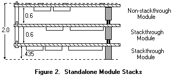

I have not been able to find a good picture of a stack of PC-104 boards, but I found this diagram showing how they stack:
The one we're talking about would need longer connectors to leave more room between boards for the home-made wire-wrapped boards. Anyway, the method is used in place of a backplane.
As for expense alluded to earlier, I'd say making the board super cheap is not as important as making it understandable for the newbie. It will be pretty affordable anyway. The user won't need to program ROMs to get going; but if he wants to and if the board can program its own EEPROMs, then he won't have to get a separate (E)EPROM programmer. Even if a separate board were made for programming, it would be a lot cheaper for the user than buying a programmer. It would probably just be limited to programming 28c256's, instead of thousands of different devices.

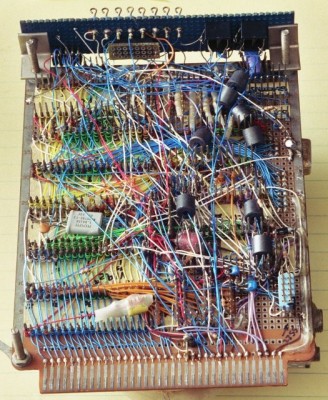

getting the diagrams of more than 2 or 3 chips to line up, after factoring in propagation delays
If you hold it down to a couple of MHz, you can get away with murder. [Edit: I must clarify that that refers to timings. If you have fast parts, you still have to keep your nose clean regarding build technique, as poor build technique can bite you even at very low clock rates.] The faster you go and the closer you cut the timing margins, the more critical the timing diagrams become.
and trying to wrap my head around transmission line theory so that I can calculate the proper values for the bus terminating resistors I'll need to add.
If you avoid running the processor's own busses off the board and keep the board small with parts right next to each other, you definitely won't need the terminating resistors. This 4.5x6" board
has no power or ground plane, no decoupling capacitors at each IC, and no termination resistors; but the processor's own busses do not go off the board (the boardedge connector is all I/O), the power and ground are distributed from the center in a star configuration, and with 4MHz pars, it gets to 7MHz without problems. Next time I'll definitely use power and ground planes (even for wire wrap), and maybe PLCCs to get parts closer together and get more than one ground pin on each 65xx IC.
I thought googling would help my design, but all it shows me is how unprepared I am.
