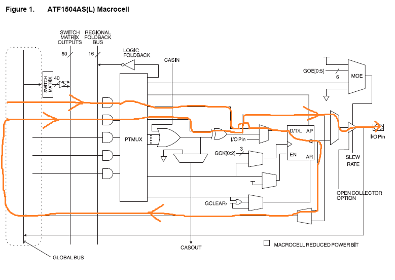

So, I've been trying my hand at CUPL in an attempt to create a couple of support chips for my next build, both of which are designed to fit on to an Atmel/Microchip ATF1504ASL-25JU44, a PLCC44 CPLD with 32 I/Os and 64 macrocells:
Chip 1. An extension of Daryl's 65SPI to include 16-bit transfers and
Chip 2. An MMU based on the 74LS612 MMU from TI, with rudimentary support for a protection rings.
I have carefully designed each to fit within the constraints of the ATF1504 architecture, and yet, when I came to implement the MMU, the CUPL fitter seems to be using an extra eight latches beyond what I think it should be using, which causes the design to fail, and I cannot figure out why.
I was hoping one of the PLD-happy people here might be able to help me track this problem down. Google-fu fails me here, there seems to be little-to-no help for CUPL on the interweb, and what there is is usually hideously out of date or downright confusing.
Attached are the CUPL source and the output of the fitter. If I reduce the size of the busses+registers, to 7 bits then the design does fit, but it still uses more latches than I'd expect it to, so I don't think its just that I've made a typo. Note the design is not finished; this is as far as I got before encountering the problem.

Yes, I did have a theory running around my head that the output multiplexor might require things to loop back through, using up a few more macrocells. However, the ATF1504 datasheet, figure 1, shows the macrocell diagram. It includes - as i'm reading it - the ability to have both a path from the MUX to the I/O Pin and to the Latch, but also from the Latch to the I/O pin and feedback into the interconnect array. So, unless there's a restriction on these combinations, it seems to me that theoretically you could have a setup whereby the Latch feeds back into the matrix, which goes into the MUX, which implements the multiplexor, which then bypasses the Latch out to the I/O pin. Hence, only one macrocell is used.
I've made a crude drawing of the datapath I just tried to describe, see attached.

I suppose that it may be possible to make the connections as you described and annotate on your diagram. I will not claim knowledge of CUPL, as my use of it is very dated. (The last I used it was with some GALs 15-20 years ago.) Describing the connectivity as you've drawn in the architecture diagram has always eluded me. Perhaps it's limitation of the automatic fitter. The Xilinx CPLDs have virtually the same architecture, and I've not been particularly successful in describing the type of connections you've shown.
Perhaps BDD, who uses these Atmel parts a lot, can suggest an approach to accomplishing your goals with the semantics / syntax of CUPL.

There is no solution. Eigth 8-bit registers require all 64 macrocells. Each output also requires a macrocell. It wonˋt fit. I would reduce the number of bits in each register.
