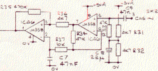

This is the circuit used for the Acorn Atom cassette input:
This works well at 300 baud, and less well at 1200 baud.
The output (on the left hand side) is TTL-compatible, and on the Atom connects to an input of an 8255 PIA.
The complete Atom schematic is here:
https://acorn.huininga.nl/pub/docs/circ ... iagram.gif
Dave
