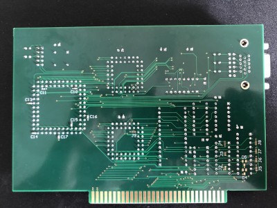

Got some PCBs made, ordered via JLCPCB and am pretty happy with the results!
There are some jumpers to change the address decoding in case I decide on changing my memory map
I also added a jumper that allows you to tie /OE high on the memory port used for the host memory access. This way the VRAM can overlay system ram without having to drive another signal to the glue logic inhibiting the on-board ram.
Thanks everyone for your help making this happen!

PostPosted: Wed Oct 24, 2018 1:42 am
Good idea. BTW, what sort of system does this board plug into? Sometime it'd be nice to hear about that project. :)
Glad we could help. You've done a very tidy job -- it turned out great!
