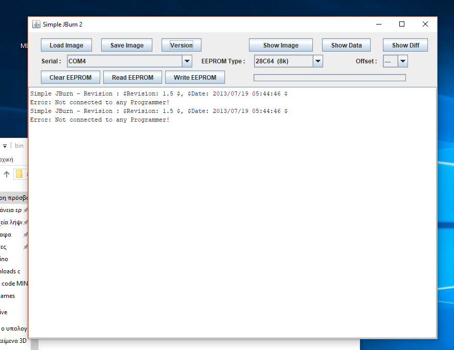

Hello guys! I'm trying to get it to work but when I open the java program says that no programmer is connected ... what can I do? I'm using an Arduino nano clone with the ch340g chip. When I open the program the Rx led on the board flashes for a few times and then turns off ....

I actually don't know if I could help you, cause the screenshot doesn't help me.
Perhaps you can feed us with some more information:
- what OS you are using
- what software you wish to use (perhaps some links?)
- does you can use the Arduino ? (does you can download and run some of the demo programs?)
- what is that programmer (link?) and how is it attached to what (Arduino/USB)?
- what 28xxx you wish to program (datasheet)?
Regards
Arne

Hi, thanks for the fast response!
I'm using windows 10 64bit
I wish to use the meeprommer software
Yes, the Arduino is working fine!
Arduino its self becomes a programmer .. and is connected via USB
28c64 by atmel ..Tested and working !

Well your screenshot says the software doesn't find a hardware. Either your hardware (not the Arduino but the board where the 28C64 is plugged in) is not compatible to the software or some settings within the software (if any) are wrong. As I do not have such a programmer board and the meeprommer software it is a bit difficult to help.
Programming an 28C64 or 28C256 is not a problem. If you read the datasheet there is a section of how it works. It is similar as to write into a RAM. Reading is identical, writing is just a little slower.
But there are two problem for such a simple connection between an EEPROM and an Arduino:
1. The Arduino Nano IIRC works with 3V3 only. The 28C64 requires 5V.
2. The Nano has too few pins to feed all signals alone.
Both jobs should be covered by the hardware your Arduino is plugged in.
Can you tell us what hardware you are using? Is there a schematic?
Regards
Arne
