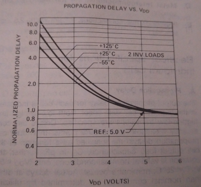

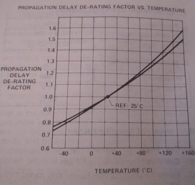

Direction 2 deals with the problem of safety margins. To check how far one can go in terms of clock speed (assuming the surrounding components are superior) is easy. Just using a VCO or something similar and increase the frequency until the system runs into errors. The used software during this test should cover all instructions in all special cases (with and without page crossings, decimal mode, all address regions if possible). Of course the working conditions should be stable. That is a constant supply voltage and a (nearly) constant case temperature.
For CMOS devices I assume that the following relations between propagation delay, supply voltage, and temperature are still valid, although these specs are taken from the SYNERTEK cell library from (SYNERTEK DATA BOOK 1985):
The relations shown in the graphs seems logical from a physical point of view. Higher temperatures will increase the drain-source resistances causing slower dis/charge of next gate caps increasing the prop delay. Rising voltages increase the gate drive, lowering the DS resistance, reducing the prop delay. What is unknown is the how strong the effect of these variations is. These graphs may be a starting point for verifications of a given device.
