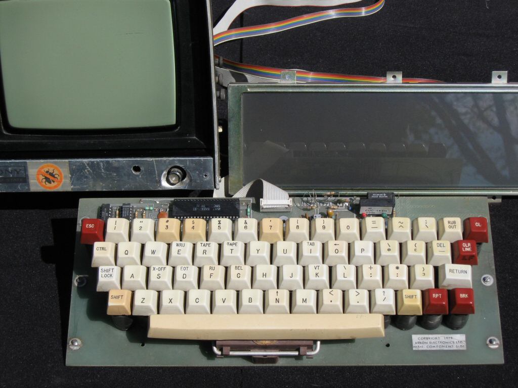

Posts: 3525
Re: 8-bit random number generator
reading and using the T1 value in part of your algorithm adds randomness
Along the same lines as Garth's idea, I used to sample the VIA port that accepted input from an ascii keyboard that was part of my setup at the time. The 40-pin keyboard controller chip (visible in the photo) had an RC oscillator and a counter as part of its system for scanning the key matrix. Of course the parallel output would become stable when a key was pressed (also a pulse would appear on a separate strobe line), but when there weren't any keys pressed the parallel output would carry a succession of garbage characters that somehow reflecting the scanning that was in progress.
My RNG involved other factors as well. Like a free-running VIA timer, the garbage character itself isn't random but the jitter in the sample timing tends to scramble things somewhat. I don't recall the recipe I used, but it served the purpose at the time! :)
