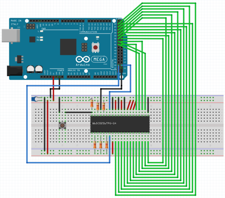

Hej everybody,
I am new to this forum, new to the 6502 processor, this is my first post in the forum, and it is directly my first question.
After reading some blogposts, such as,
I wanted to experiment a bit with the 65c02s. Basically, I just want to start my experiments as many others with a hard wired `NOP` operation as described in http://www.plingboot.com/2015/10/homebrew-6502-part-2/
However, I am wondering a bit about the values that I read from the address lines. I am especially wondering about three things:
  • When reset, should I not see $FFFC and $FFFD on the address lines?
    The Western Design Center Manual says:
    When a positive edge is detected, there will be a reset sequence lasting seven clock cycles. The program counter is loaded with the reset vector from locations FFFC (low byte) and FFFD (high byte).
    As you can see on my log below, I see something like $FC in both resets but not a consecutive $FFFC and $FFFD as expected. Additionally, I cannot see those seven clock cycles before "counting" on the address lines starts.
  • Why are some addresses left out?
    As you can see in the log below, there is for example a jump from `0xEB 0x0` to `0xEB 0x2`, one from `0xEB 0x2` to `0xEB 0x4`, etc.
    I would have expected something like `0xEB 0x0` to `0xEB 0x1` to `0xEB 0x2` to `0xEB 0x3` to `0xEB 0x4`, etc.
  • Why are some of the addresses there for more than a clock cycle?
    For example, in the log below, `0xEB 0xA` is read 9 times in a row, `0xEB 0x14` is read 8 times in a row, etc.
    I would have expected each number to appear once per clock cycle.
In the following is an excerpt from a log of the address lines with my comments after the `<--` arrow on the right hand side.

My setup is the following:
  • I have an Arduino Mega2550, which I use to provide 5V, create a clock signal, read the address bus, and to read the `SYNC` and the `RWB` pin
  • I am using a WDC 65c02s (W65C02S6TPG-14)
  • Those pins pulled-high via 3.3kohm pull-up resitistors are the same as in the L-Star computer, see https://github.com/JacGoudsmit/L-Star
An illustration of my current setup can be seen in the following picture:
My hypothesis is, that the clock signal is not sufficiently clean. A clock signal with a lot of ringing could cause the processor continuing NOPing without my program reading the address lines. Unfortunately, I do not have access to any kind of oscilloscope to verify this.
Do you have any idea why I am seeing those weird behaviour when reading the address line? Is there anything I can do to my circuit to make it work as expected? If it is something like adding another decoupling capacitor somewhere, where and how should that be done?

File comment: Added breadboard schematics as attachement as suggested in replies.

PostPosted: Tue Aug 07, 2018 1:54 pm
Posts: 10838
Welcome!
Although it's possible to have clock problems, it might not be the first hypothesis. I see you have one bypass capacitor on the breadboard power rails - it would not be a bad idea to put another one nearer the actual power pins of the MPU.
But one thing sticks out: you are almost always, but not quite always, seeing SYNC as 0. To me, that means you might be sampling at a bad time relative to the clock edges. With EA as a NOP, you expect to see SYNC every other cycle, and for the address bus to increment every other cycle too.
If you are mis-sampling, then we shouldn't worry too much about the rest of the trace, until that problem is cleared.
It is odd to see several consecutive cycles with no change on the address pins. If you were sampling sometimes much too fast and sometimes much too slow, you'd see that.
I haven't skimmed your Arduino code. I probably should have.
PostPosted: Tue Aug 07, 2018 2:12 pm
Posts: 3366
Welcome, HelgeCPH. For some reason I'm not able to view the image. May I suggest you attach it with your post? This forum (unlike many others) does allow that. :)
I agree with Ed. You need to find out why SYNC appears to be remaining low. Are you *sure* the RDY pin is being pulled up? You can verify that with just a voltmeter.
Yes, there could be a clocking issue, but there's a list of other factors I'd consider first. You might find there's a wiring error, and that the results reported by the Arduino are accordingly incorrect. BTW, remember it's possible to stop a WDC CPU at any time. So, for example, you can run the reset sequence in minute detail, stopping on every cycle and verifying the state of every pin with the voltmeter.
cheers,
PostPosted: Tue Aug 07, 2018 2:36 pm
Posts: 10838
OK, I had a skim of the sketch. Can I suggest a delay() after you raise the clock? 100 milliseconds is more than enough - even 1 millisecond should be enough. But possibly without a delay your clock pulse will be very short, depending on how fast the Arduino is.
PostPosted: Tue Aug 07, 2018 3:12 pm
Posts: 337
My money is on insufficient decoupling capacitors. They need to be physically as close to the power pins of the 65C02 as possible. As well as a 0.1uF ceramic, I would add a 10uF electrolytic.
I would also route the ground connection from the Arduino board directly to the row in the breadboard where pin 21 is connected.
Dave
PostPosted: Wed Aug 08, 2018 10:38 am
Joined: Sat Aug 04, 2018 3:44 pm
Posts: 2
Thank you for the warm welcome and all your answers with hints!
@Dr Jefyll
Right, I do not know why this happens, but I edited the post and added the illustration as attachement.
Unfortunately, I do not have a proper voltmeter either. But I did what you suggested with the help of an LED, just to see if pins are high/low as expected.
When doing that, I figured out that my problem was really easy to solve, stupid, and I should have seen it before posting...
In the schematics I connected the clock signal to pin `53` of the Arduino. However, in my sketch I set the clock pin to `52`. That of course meant that there was no real clock signal coming to the MPU. In connection with the `loop` of the sketch I was mislead to that a clock signal was properly generated.
As I understand, the clock pin was floating and therefore something seemed to be happening anyways only with in weird steps. Is that understanding right?
@hoglet
Since I do not really know electronics, I have to ask here. Do I understand it correctly, that you suggest to add one leg of a decoupling capacitor to VDD (pin 8 of the MPU) and the other one of to ground? This is how I understand decoupling capacitors should be used but I am not sure if it is right.
Just for completeness an excerpt of the log in which now the SYNC signal is alternating, the address lines "count" properly, and in which the reset is properly visible via the addresses $FFFC and $FFFC

PostPosted: Wed Aug 08, 2018 11:20 am
Posts: 10838
Much better!
PostPosted: Mon Aug 13, 2018 4:04 pm
Posts: 155
Location: UK
Hello HelgeCPH :D
HelgeCPH wrote:
@hoglet
With fast CMOS chips like the WDC65C02S, it's good practice to provide a short term supply of energy so that when the chip internal logic changes state, or when it changes the outputs from low to high or high to low, the current required can partially be supplied by the local energy store. This reduces the voltage drop that otherwise would occur due to the slight resistance of the wiring and inconnections between the power source and the chip. In electronics, the method of providing a local energy store is by connecting suitable capacitors as close as possible to the relevant chip(s). Ceramic 100nF (0.1uF) types (mostly multilayer known as MLCC) are used. In addition 10uF or 47uF 'low ESR' electrolytic capacitors are often used on the supply network. These are in simple terms, slower than the ceramic type, but can hold more energy. Hence are sometimes referred to as bulk decoupling.
For a simple breadboard circuit like yours, you could route the +5V and the 0V/GND wires directly from the Arduino to the breadboard connections strips that the 6502 power pins are in. Then put one capacitor lead in one of these strips, and use a wire to get the other capacitor lead to the other power pin strip. The idea being that the physical distance between each capacitor leg to the relevant power/ground pin of the chip be as short as possible.
And yes, without a reliable clock, microprocessors either don't do anything, or do strange things...
Have fun :D
Mark
