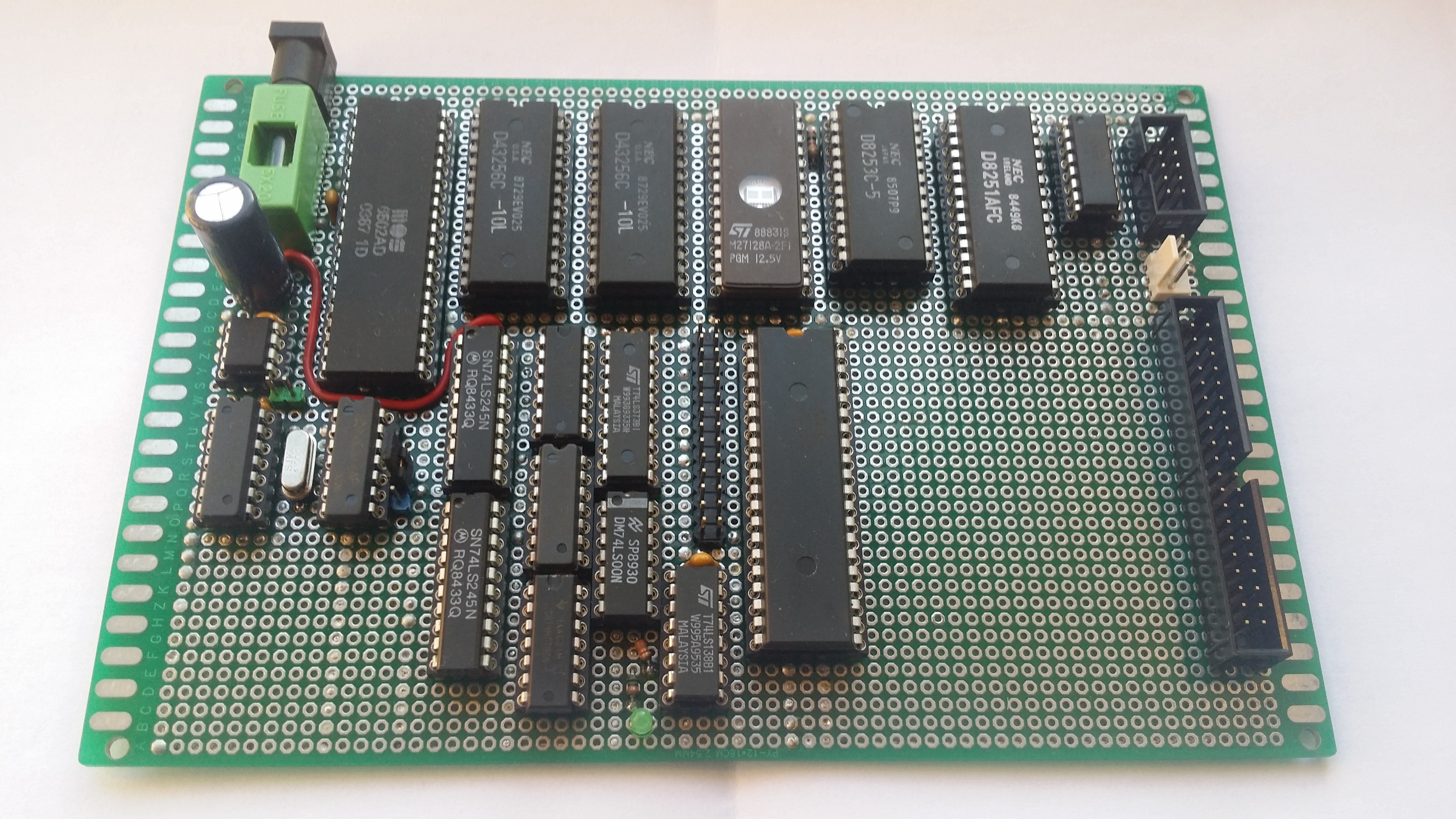

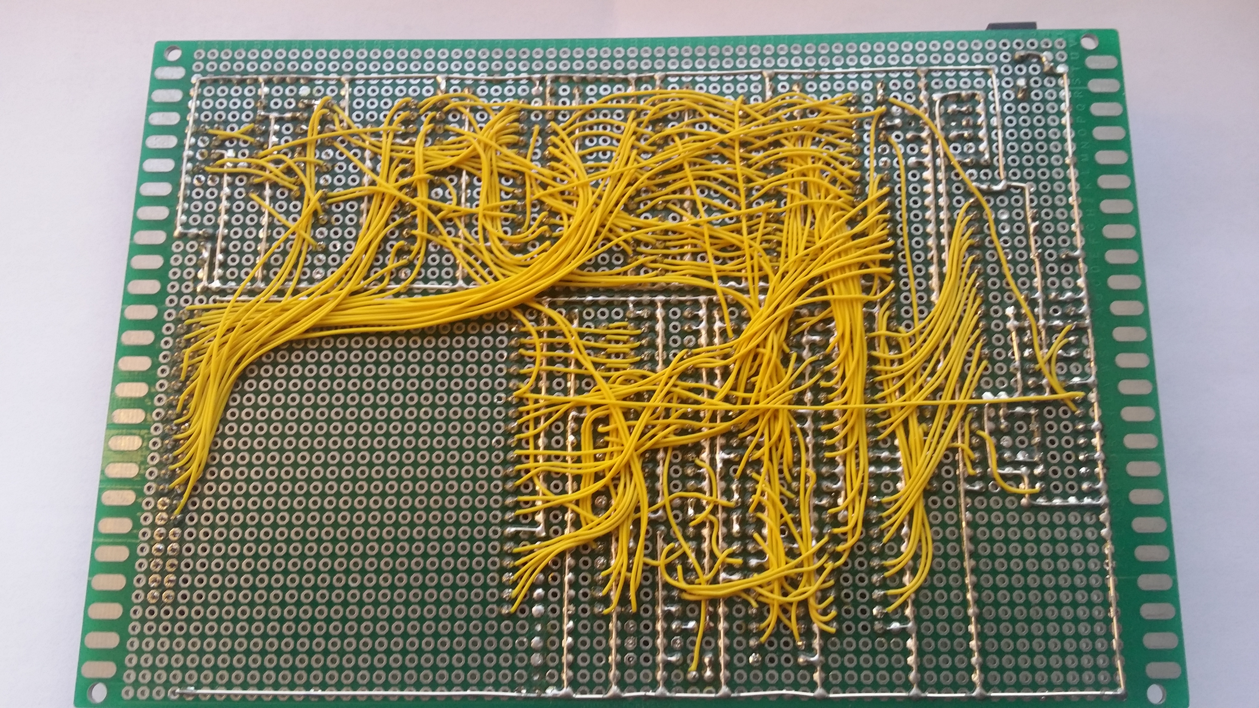

Welcome, Atlantis -- nice to have you with us! If you have any photos of your project we'd enjoy seeing them. And/or some further description, if you have time, please. (BTW on this forum photos can be attached to one's post -- no need for a third party host.)
I've added some photos. I will try to add some description soon.
It is still work in progress. I am going to add 8042 keyboard controller, maybe some RTC and of course CRT controller on the separate board.
