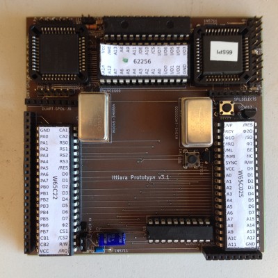

About a month later, and the chips are down. On the board, that is. I've tested them all working individually(well, each with their own little test programs), although I many need to test the RAM more exhaustively.
At the moment, I'm trying to write a bootloader of sorts, so that I don't have to pull the EEPROM out every time I want to do something different. Basically, it's supposed to load a binary from the beginning of an SPI-10 module, and run it. I've not succeeded in getting that to work yet, and I don't know why, which is annoying(not having a proper debugger doesn't help). I'm going to have a shot at rewriting it from a (hopefully) better spec. It'll involve 16-bit arithmetic, but that's not hard.
PostPosted: Sat Jul 14, 2018 8:31 pm
Posts: 660
Location: North-Germany
Perhaps you can create a tiny monitor that is capable of reading (and writing) something like S-records ore similar.
A little utility that moves itself into RAM and then programming a given region into the EEPROM would helpful as well. I would assume that in most cases there is sufficient space in your EEPROM to keep all these code snippets. :)

PostPosted: Sun Jul 15, 2018 2:34 pm
Posts: 3366
Congratulations on a fine looking project! Nice to see how this has evolved from the hand-wired prototype.
I see you have various options to consider, but FWIW here's another. Maybe as a stepping stone you should implement a drastically simplified bootloader. For example it could be limited to loading programs whose length is always 256 bytes, and it would always locate the program at $0200 (for example).
With this rudimentary capability in place you could then test successive versions of a proper bootloader without the restrictions. :)
( You could then go further and arrange that the new loader executes from ROM. However, there's perhaps not much advantage in taking that step. Having a loader that loads the loader is quite acceptable, IMO, and it makes it easy to add new features to the level-2 loader. Also, in a troubleshooting scenario it may be advantageous to be able to revert to the simplest level. )
