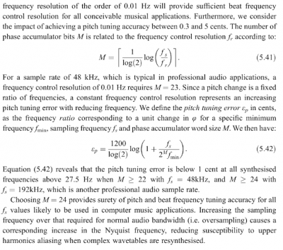

It's notable, I think, that the Music 5000 has a 24 bit phase accumulator. I think that's an indication that 16 bits isn't enough. According to this, you'd need 23 bits if you were clocking samples at 48kHz. Of course, standards for 'musicality' are variable, unless you're selling your kit as a musical instrument.
I get a message that says, "You have either reached a page that is unavailable for viewing or reached your viewing limit for this book."  (The latter is definitely not the case.)  I can understand a 24-bit phase accumulator in applications like the professional recording studio I have done some repairs for where the owner has a digital noise generator for testing and has a one- or two-second repeat rate and generates the entire audio spectrum.  It would simplify certain things, but would take a table of a minimum of 100KB, ie, larger than the 6502's address range for just the one table.  One thing I'm thinking of is vibrato; but rather than hold tables with lots of cycles of sound to cover a full cycle of vibrato, the '02 would do better with just slightly varying the increment value about 50 times a second (for a maximum FM speed of about 6Hz).  Then the vibrato rate could be varied or stopped and started without changing a table.
Just for reference, then, this was the page I found:
From Digital Waveform Generation By Pete Symons
