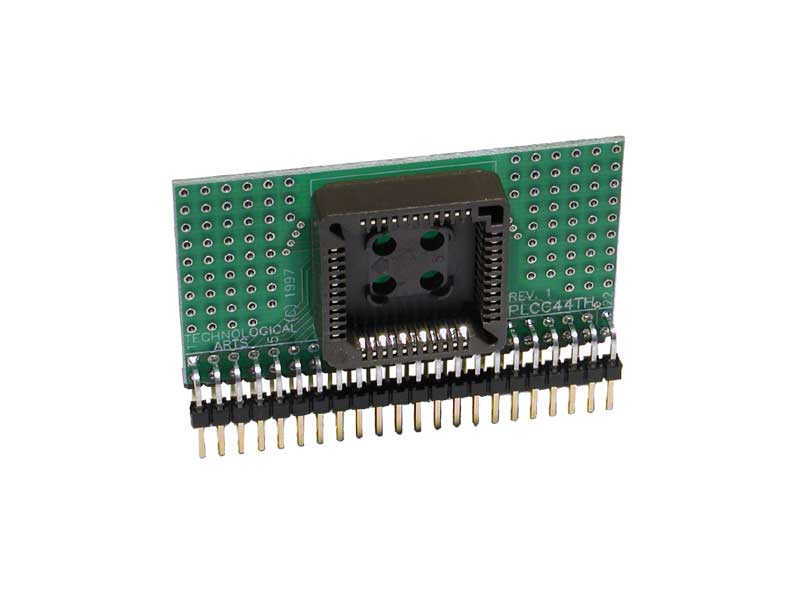

Technological Arts (and others) offer adapters like this...

Posts: 36
Cool. I see the SST39VF010-70-4C-NHE at Mouser, 128KB, 70ns access time, and cheap.
But what does one use for a programmer for such PLCC flash chips?

There's cheap PLCC32 to DIP32 adaptors on e-bay and other places. Then you can program in a regular programmer as if it was a DIP version. The sockets on them may not take too many insertions and removals, but given how inexpensive they are, it may not be an issue.
